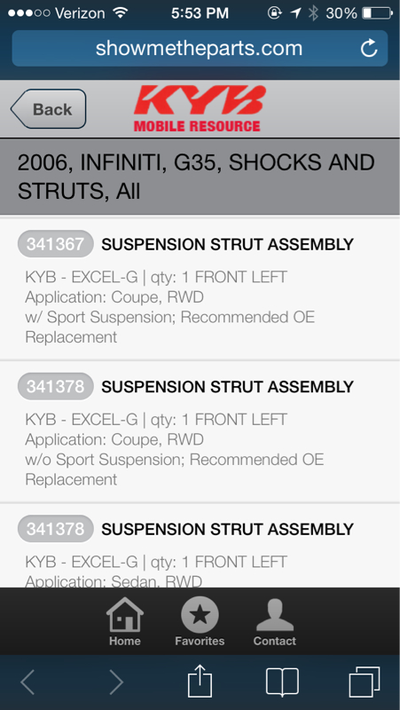

I'm looking to swap the OEM shocks (all four) for the KYBs. For those who have successfully done this, can you guys confirm the KYB part numbers?
I have the 07 coupe with sport suspension.
Front left:
Front right:
Rear:
thanks in advance!

366/367
Attached Thumbnails KYB shocks part numbers for Coupe w/ Sport suspension-image-3031872939.jpg   KYB shocks part numbers for Coupe w/ Sport suspension-image-4053597086.jpg

Luckily for me I have an 06 with sport suspension and the idiot who owned the car before me installed the 377/378 non-sports! and tbh I would recommend Koni over kyb. They're adjustable

Thanks for the help. Somehow the same website shows me different part numbers under 07 coupe. Did you change the boots and mounts also?
I searched and came up with these KYB parts:
Front mounts: SM5542
Rear mounts: SM5482
Rear coils spring insulator: SM5560
Boots: SB10 (or go with Moog K90462 as a member mentioned in another post)
Rear mounts: SM5482
That's because a lot of sites think both the first gen sedan and coupe ended in 2006, and the 2nd gens both started in 2008.
Sometimes it's easier to look up parts for a 2006 coupe instead. You might notice the part number differ between 2006 and 2007 coupes on some sites, when they are really the same car.
The changeover was for the sedan with 2006 sedans and 2007 sedans being different cars. The coupe sometimes get listed in this change incorrectly.
