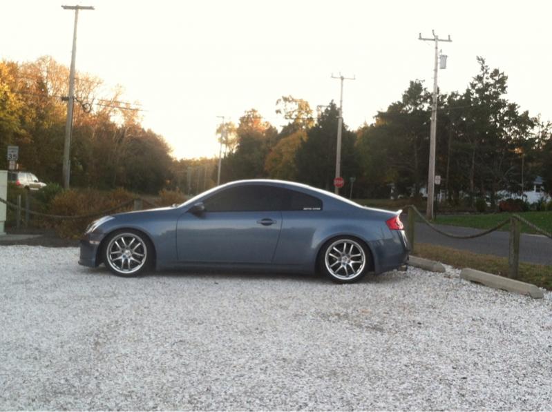

How it looked with 20/25 h&r
For "flush" the correct answer is 25/30

He's not lowered tho. Lowering makes the wheels sink in more. Hey, op, I'll sell you my 20mm spacers for $90. I need 30mm like jerseys saying.
