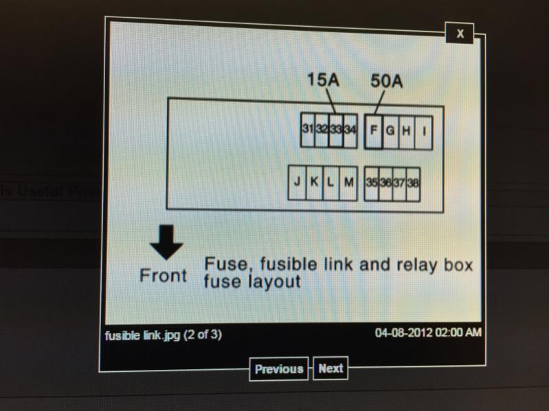

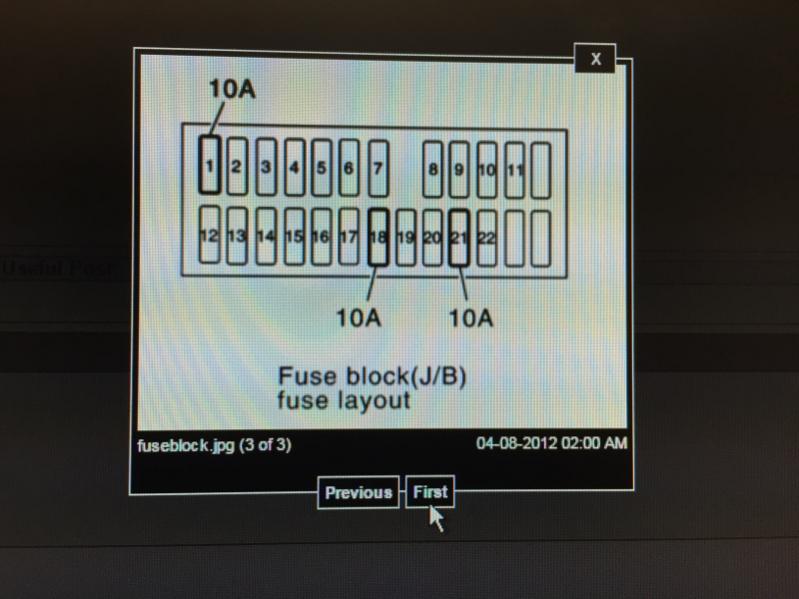

This has probably been talked about before, but i was unable to find a thread on it. I recently replaced my interior dome bulbs and when i turned them on they lit for a quick second then blew. I'm banking that i blew a fuse, but where is the fuse located for the dome lights i looked underneath the driver panel and did not seem to find the fuse for the lights is there another location underneath the hood that i do not see? any help would be appreciated. Again my apologies on bringing this up.

It's in the FSM. http://www.nicoclub.com/FSM/G35
http://www.nicoclub.com/FSM/G35/%5B/URL%5D
Attached Thumbnails Interior dome lights question-image-851997739.jpg   Interior dome lights question-image-988746415.jpg

Thank you, I referred to the FSM as you said and I was able to pin point the problem, after looking at the diagram it states "Room Light" which the whole time I was looking for "Interior Dome Light" as what most cars state. The fuse was blown so I replaced it and was able to have my LED's in full functioning order. Thanks dude.
