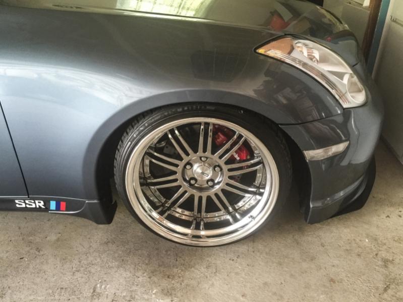

coupe fr fenders: how far can they pulled?-image-812177155.jpg
coupe fr fenders: how far can they pulled?-image-1949013707.jpg
A 225 on a 10 looks like this. A decent stretch nothing too wild imo
