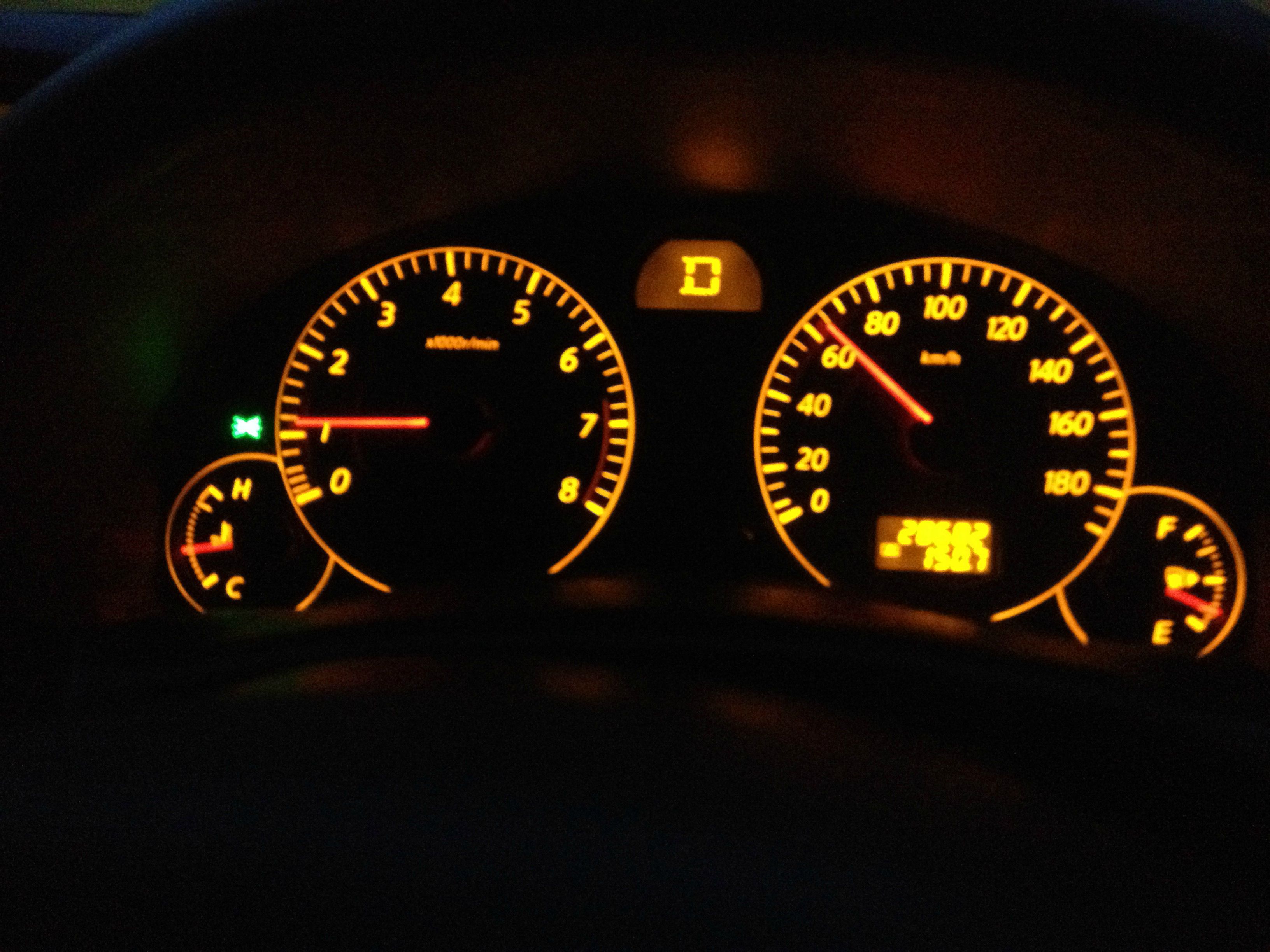

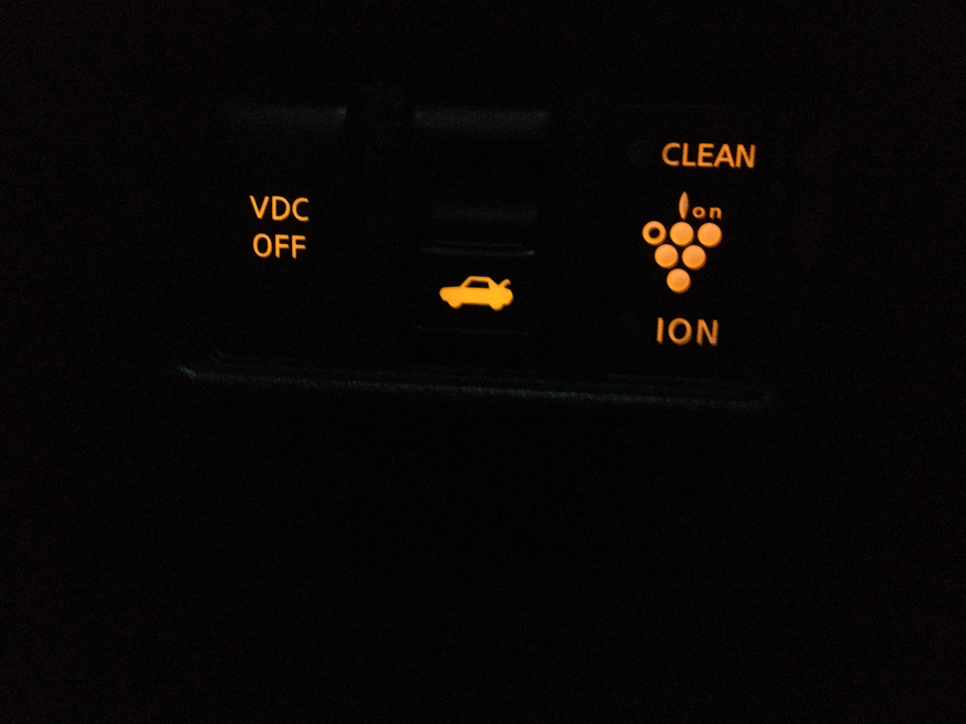

The lights are very tempremental, sometimes they will all be full brightness, sometimes the right side will be full brightness and the left side dull and sometimes I will lose light all together in one spot on the rev gauge being the 0 and 1 (looks like bulb is out but cannot tell?) - headlights on or off it makes no difference, I also do not have a dimmer switch, never came with one but rather a different panel (see image below).
Has anyone experienced anything like this before? or if anyone has any suggestions I would love to hear them.
See images below of examples, sorry for poor quality pics
Right side normal full brightness, left side dull and light out at 1&0 on revs:

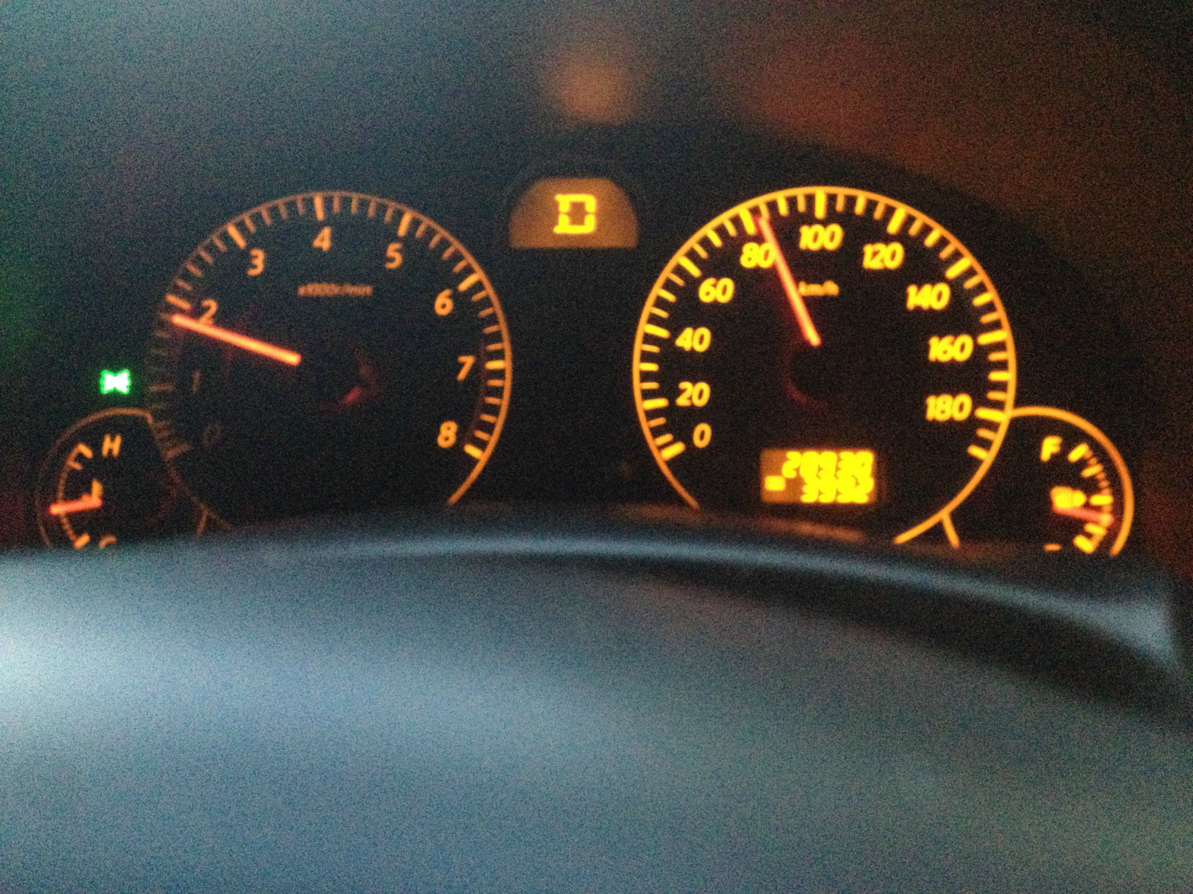

Right side full brightness and left side a little duller:
Both sides full brightness:
Right side full brightness and left dull with light out at 1&0 again (seems to be only place the light will go out.
No dimmer switch:

Is that "Clean ION" button stock? If not look behind it to see if someone replaced the dimmer wheel with that button. Look to see if something is coming undone.

Yeah wheres your dimmer switch?

What the clean ion button do?

Every 10mins or so it cycles between the two (clean and ion mode) - when it hits ion mode the air con generates highly concentrated Plasmacluster ions into the air blown from the vents and reduces odor absorbed into the interior trim, I am guessing this would have been a factory extra and can confirm that it does work!
