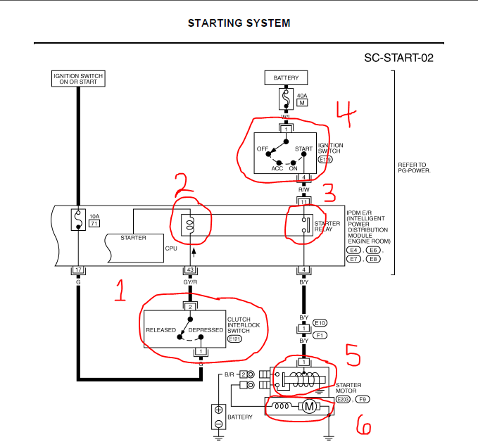

I would suspect a faulty connection at or a faulty Clutch Interconnect Switch (E-121). This switch is actuated by the clutch pedal and is located by the pedal. Make sure the switch did't come loose and that it is being actuated by the pedal when depressed and released.

I cannot comment on a common problem with this switch since my coupe is automatic. What I can comment on is the possibilities based on the circuit. Your pumping the clutch several times before it starts could simply be coincidence. In reality, there are quite a few items that could cause the problem you are having. I have attached a diagram identifying all possible problems in the circuit minus wiring and fuses.
1. Faulty clutch interconnect switch.
2. Faulty starter relay coil.
3. Faulty starter relay contacts.
4. Ignition switch.
5. Starter motor solenoid.
6. Starter motor.
Here are some things I would do before spending any money on parts. You can actually rule out 1 thru 4, if you you check for 12v at pin 1 of the starter solenoid with the ignition switch selected to start.
1. The Basics first, check your wiring connections going from the battery to your starter for condition, cleanliness and security.
2. Wiring at the clutch interconnect switch as previously mentioned.
3. You can bypass the interconnect switch by jumping pins 1 & 2 at the switch. Keep in mind that doing this is only recommended for troubleshooting. If you leave it jumped the car can start while in gear and lunge forward or reverse if left in gear. "Use caution"
2. Swap the Starter Relay in the IPDM E/R box with one of the other relays, it looks like the headlamp relays are the same.
Consider these suggestions and see what happens.
