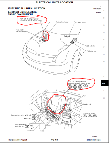

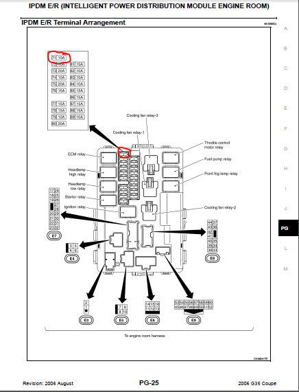

It is all going to be OK, you most likely blew the fuse. The 2006 wiring diagram shows it being a 10A fuse, # 71. It is located in the IPDM E/R, which is located inside a box behind the battery. See attached.

Aye thank you very much just got it and did add-ons so when this went out it ruined my night didn't think it was so little going to check out the pics you sent, thanks again !!
