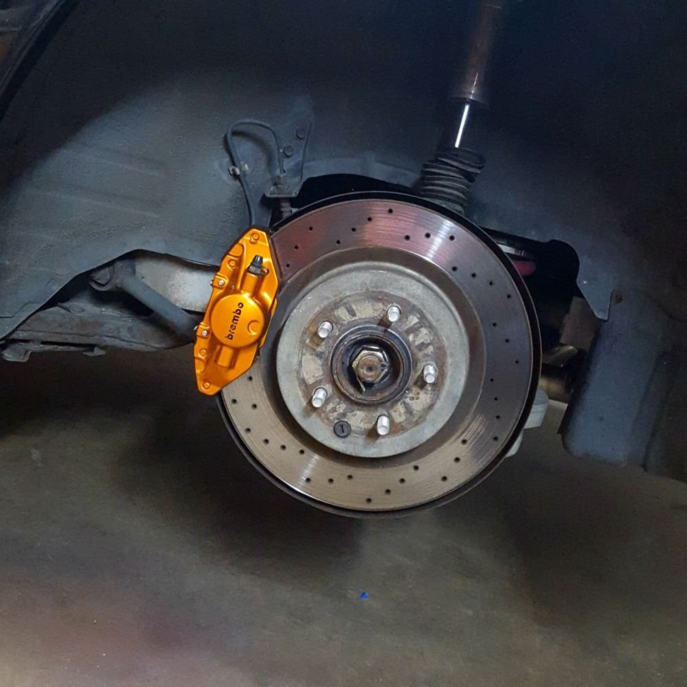

I painted mine on the car as I felt more comfortable "skimping" on the painting rather than on the brake bleeding. Results came out excellent, just make they're clean and smooth.

^ that's not powder coat? Wow that looks good. Watd u use?

From: Charlotte, NC
Nope, all rattle canned. I de-greased it with Purple Stuff, sanded with 150 grit, used 2000 degree primer (5 coats, 3 light and 2 medium), then the actual paint was VHT Engine Metallic Burnt Copper (4 coats, 2 light and 2 medium). Then I slapped on some $4 Brembo decals from eBay.
