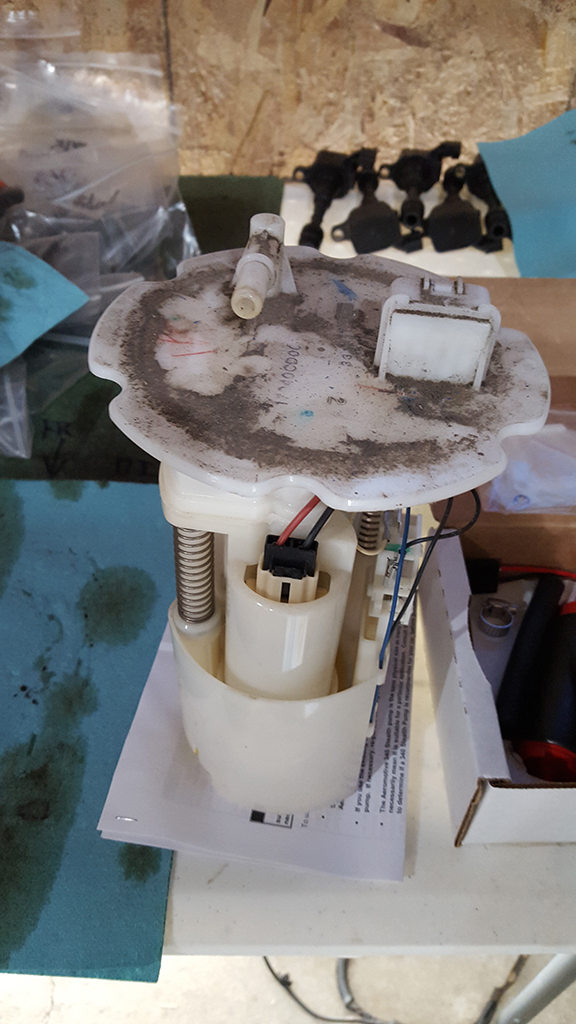

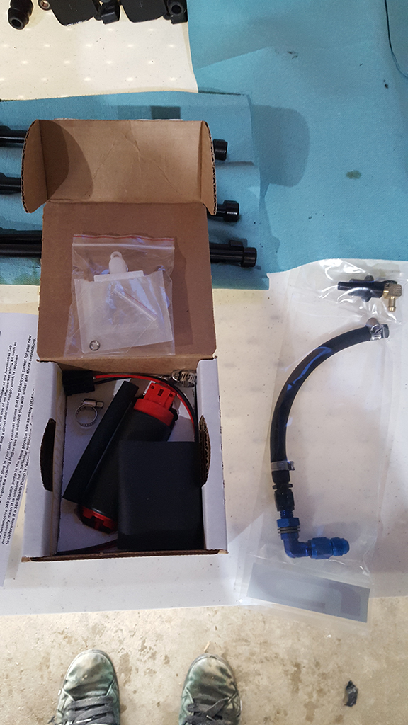

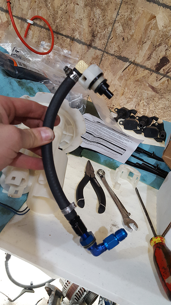

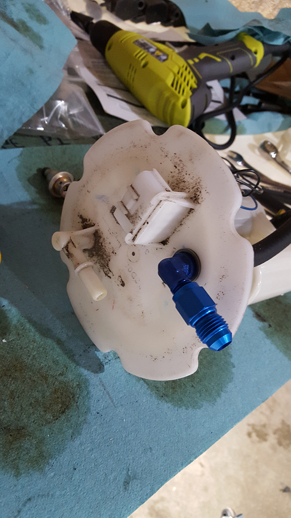

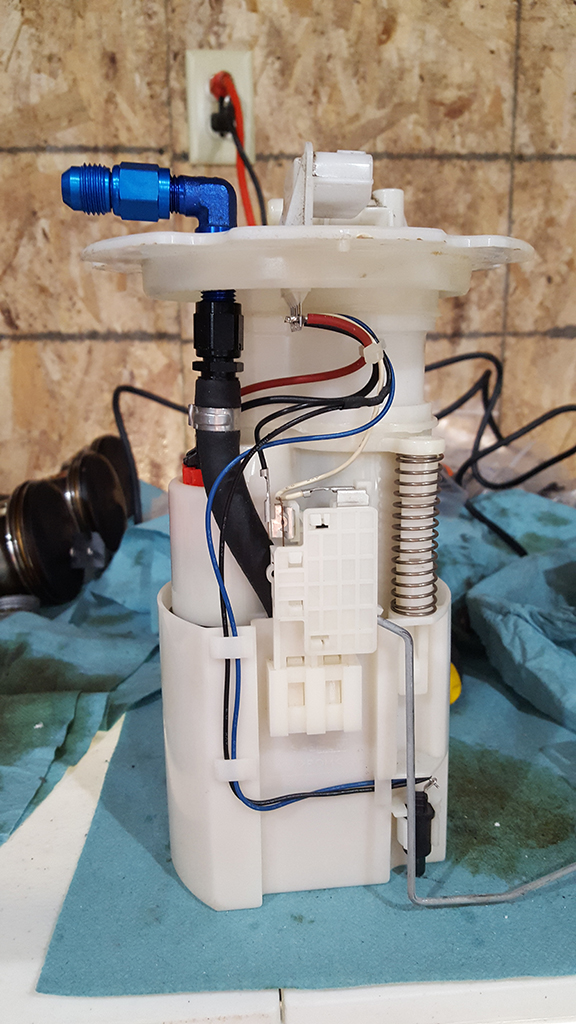

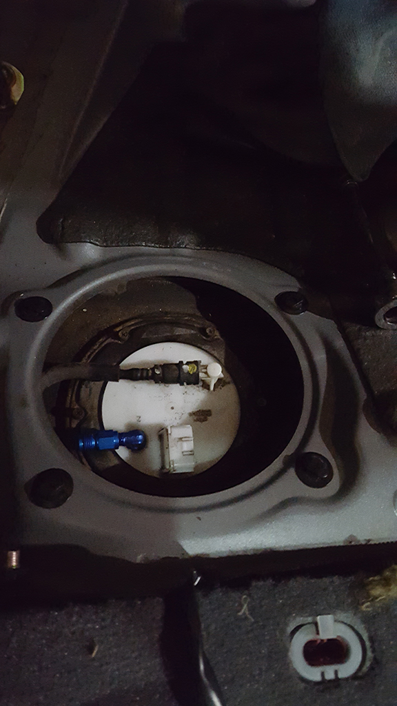

Aero 340lph Stealth Fuel Pump.

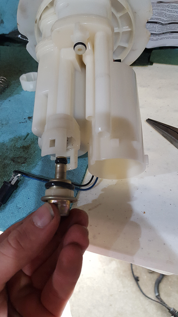

When I bought my turbo kit the previous owner sent the modified fuel bucket with it, so I still have my original one to work with. dug it out and got to work installing the Aero pump and CJM return.
Removing factory pressure regulator to replace with the CJM unit.
Dremel down the top of the assembly smooth so you can drill a hole and install a fitting for the return line.

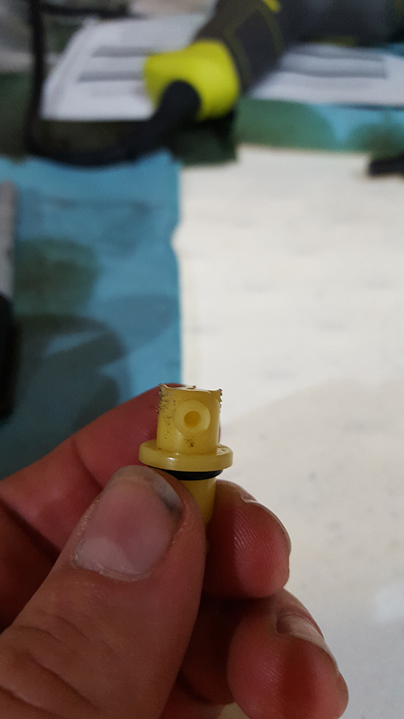

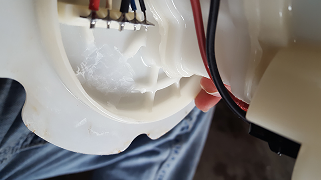

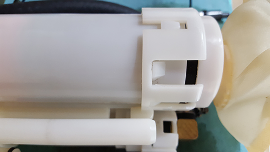

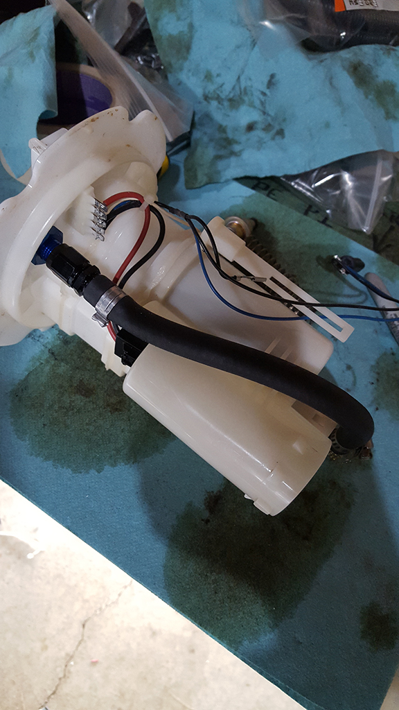

Aero pump installed. It is a little longer than the factory pump, so you need to file down the tabs to get the end cap to snap into place. I also forgot the pump came with its own sock so I eventually swapped it out after I took this photo.
Drilled the swirl jet-pump hole to .100 inch

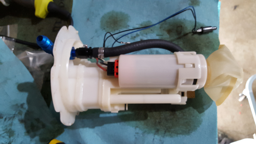

Fuel pump assembly done. You might have to do some filing down corners to get the lower bucket to slide on without resistance.

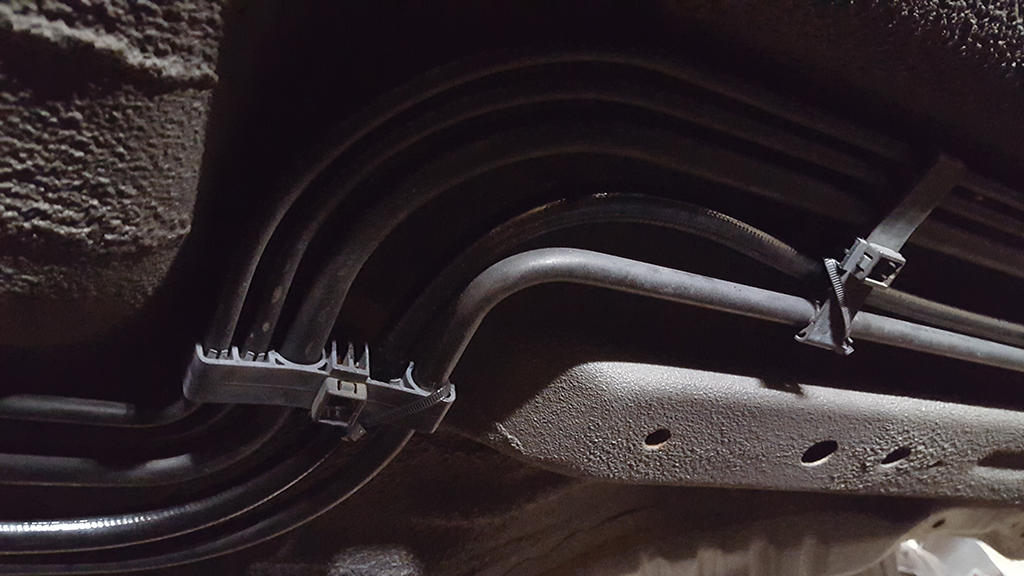

Next was the return line. There is one extra spot in the factory fuel line mounts that the new line will fit in if you break the tabs away from the mounts. Its a real pain to feed the line around the edge of the tank, but its do-able. I also zip tied it in, just in case.

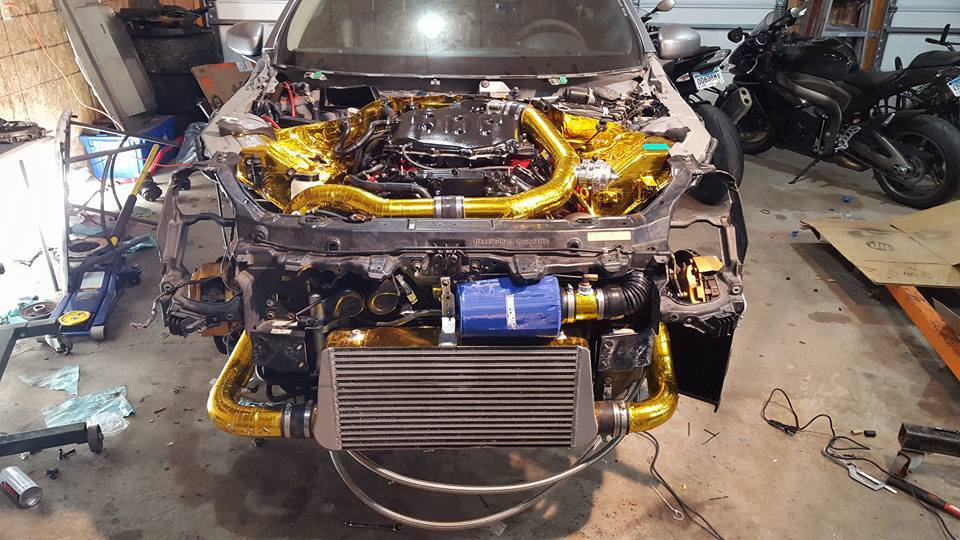

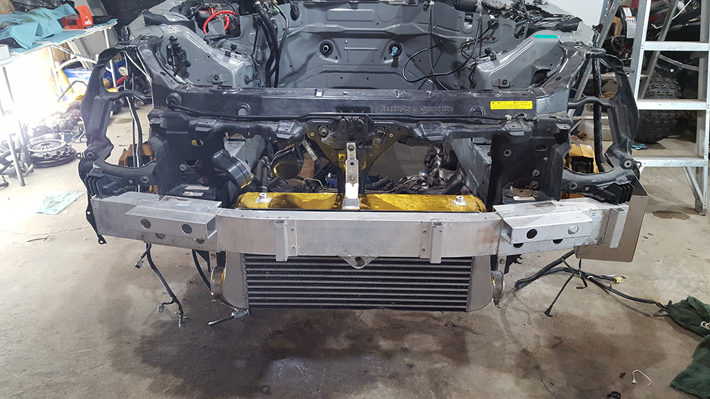

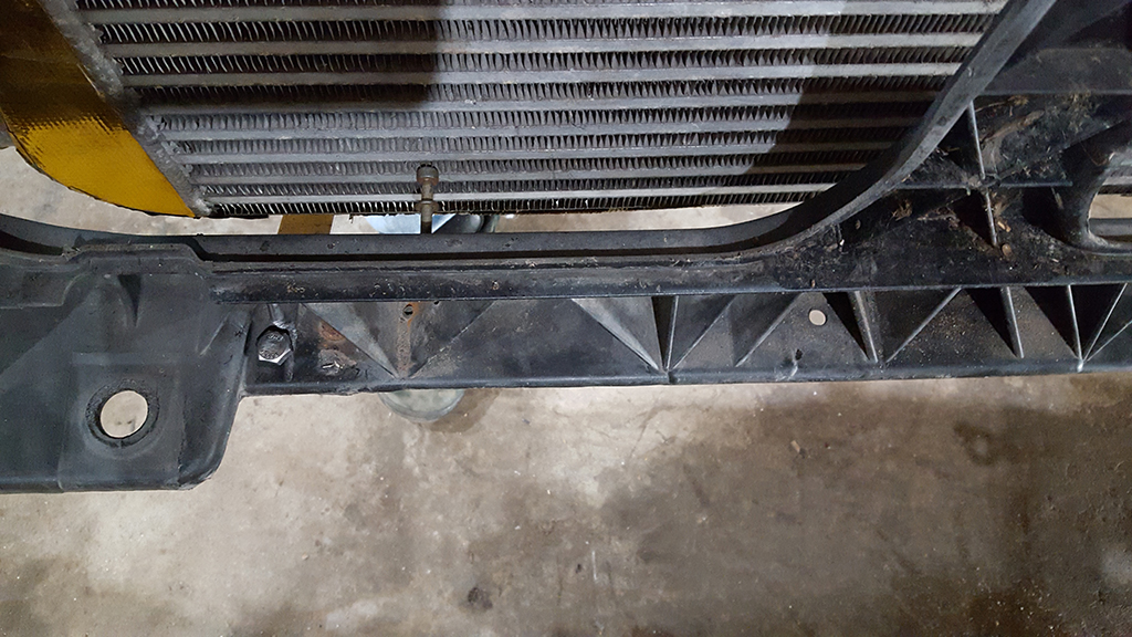

Fitting the bumper to fit around the intercooler. I will be bringing the bumper in to get new plates welded to close everything up.
I used bolts threaded into the core support to get an even core-intercooler distance on both sides. Once the distance was set I could cut the intercooler brackets to length and get them mounted.

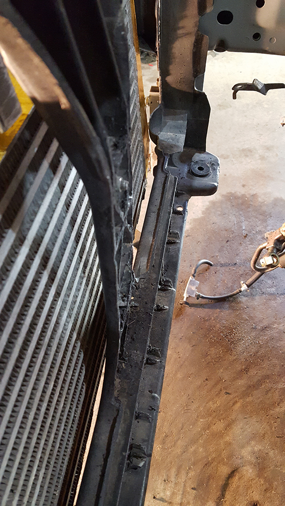

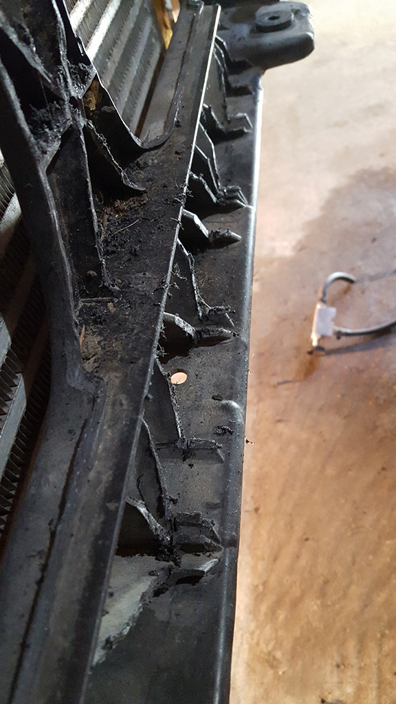

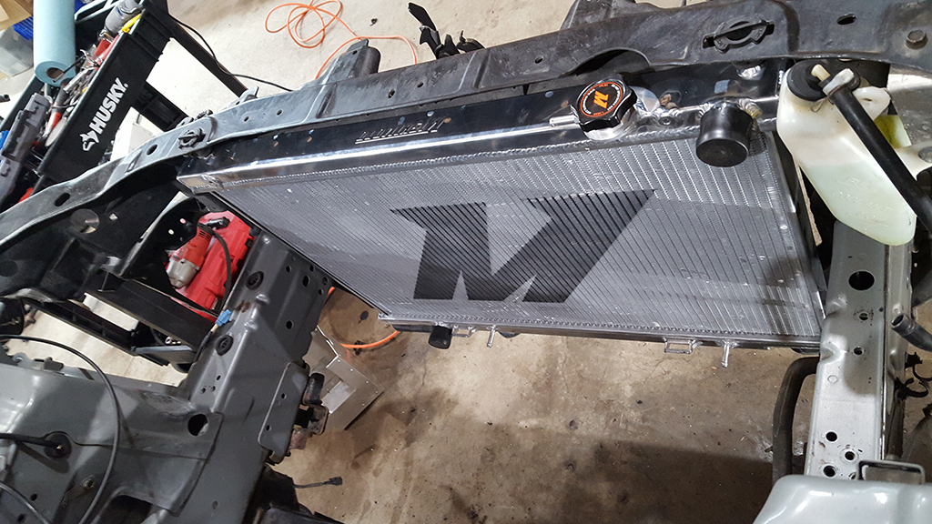

Next was the radiator. I'm still going to run A/C so to get everything to fit I had to cut away quite a bit of core support before it would fit.

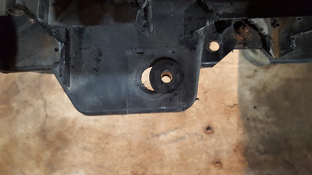

Also had to oblong the lower support holes as the new radiator wanted to sit too far to the drivers side.

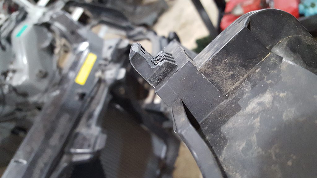

If you're going to re-use the OEM fans you might have to cut away some of the lower mounts to get them to fitthe new radiator.

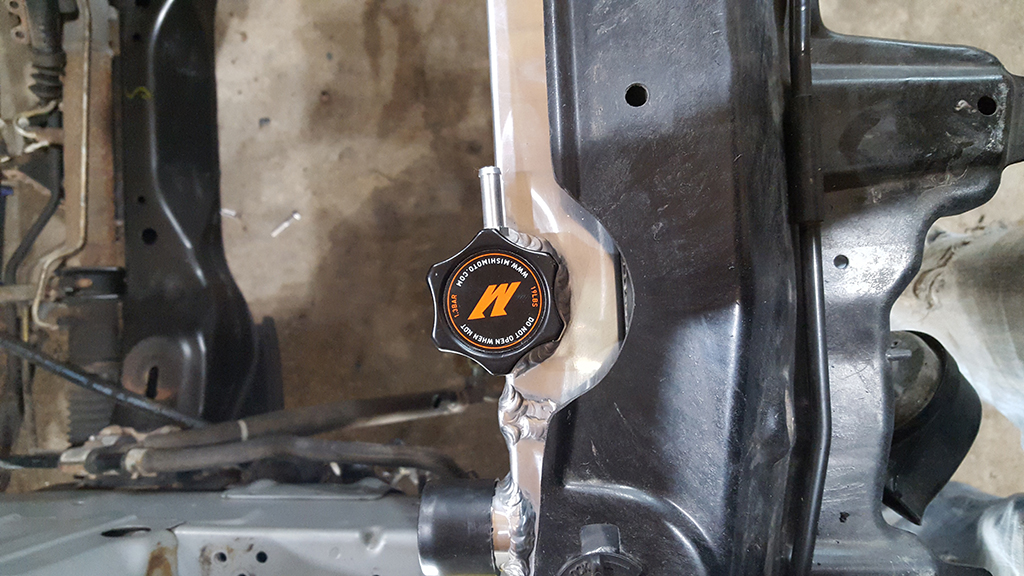

You'll want to cut away around the cap to make room for your fingers. Same goes for the drain plug.

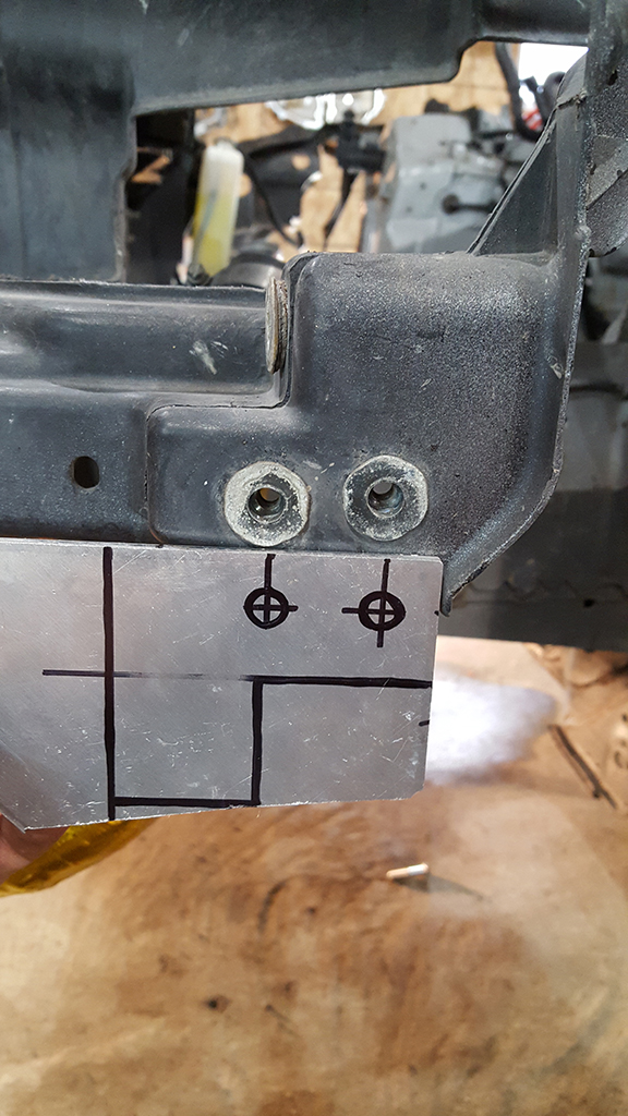

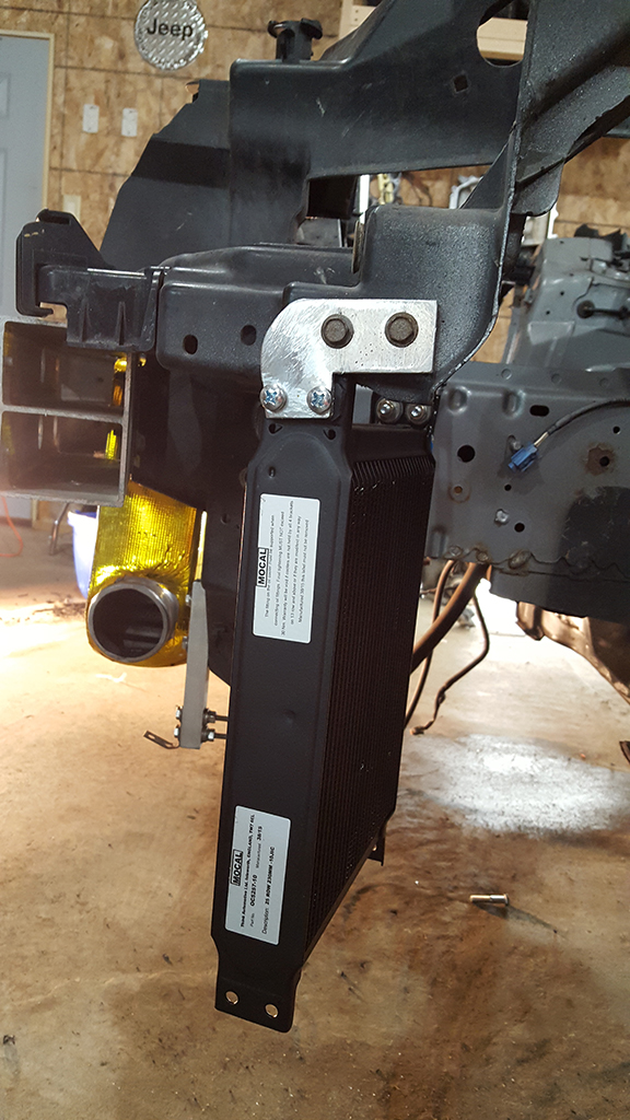

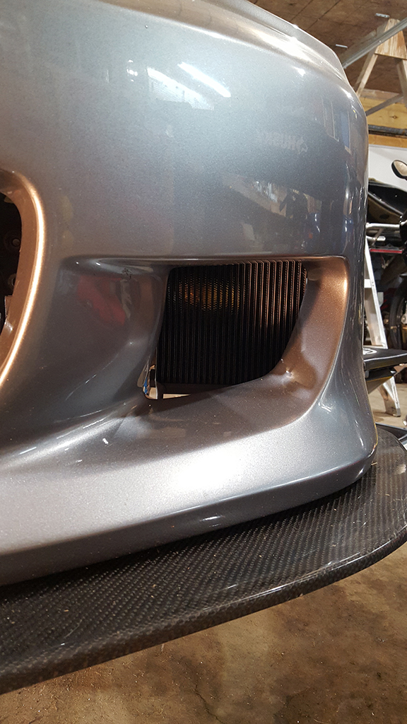

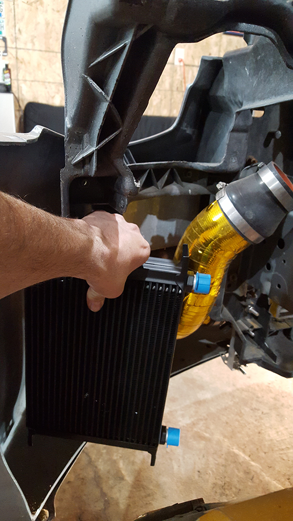

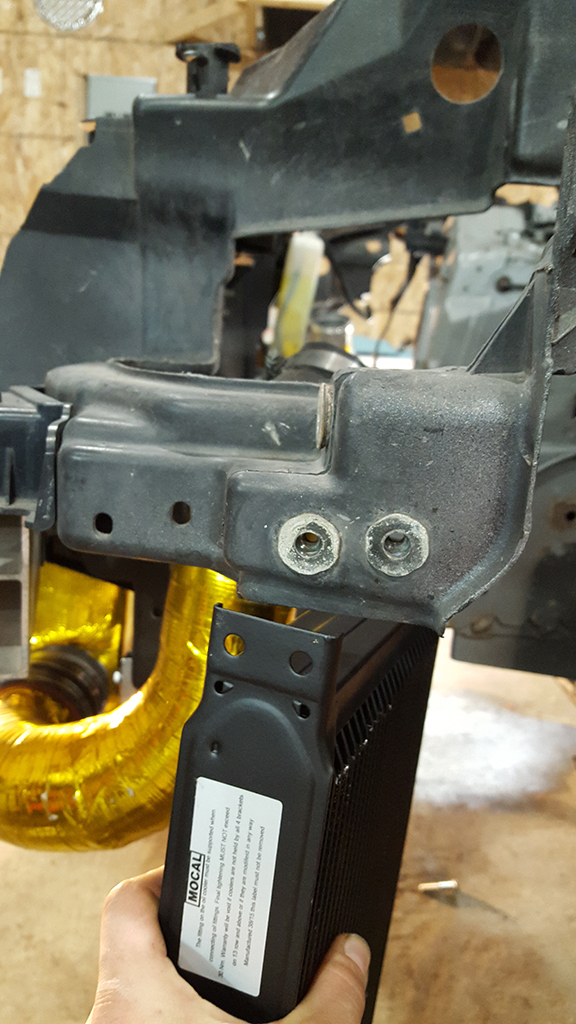

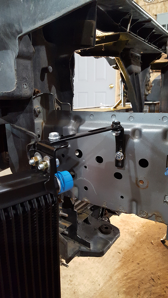

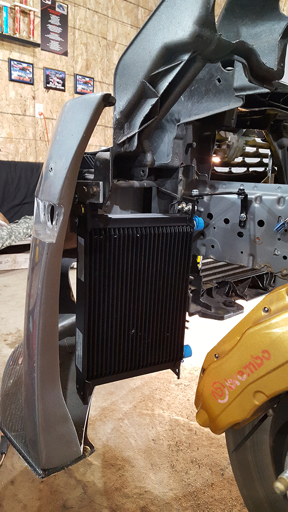

Next was finding a spot to mount the Z1 25 row oil cooler. I didnt want to sandwhich it between the intercooler and radiator, so I will fit in in the spot in front of the drivers tire. Made a bracket our of aluminum to mount it. I will be making some ducting to force air through it.

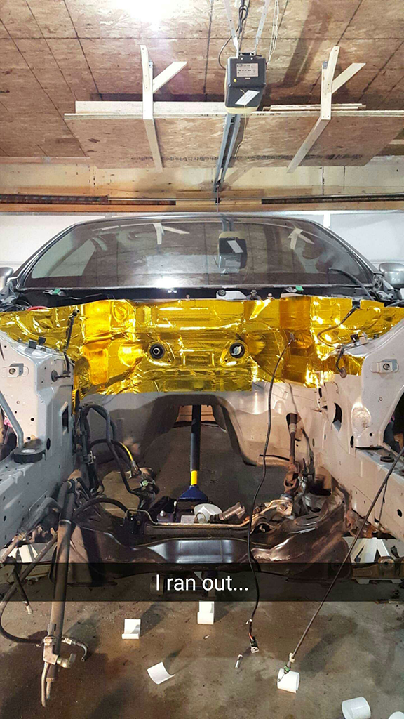

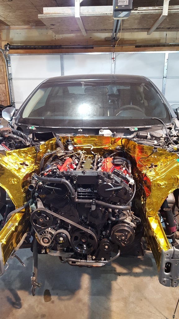

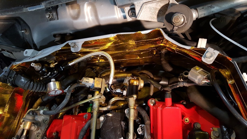

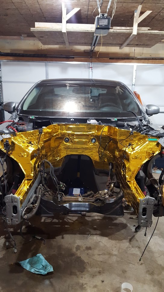

Started the gold wrap on the firewall but ran out. i also forgot to snap a photo so I had to resort to snapchat.

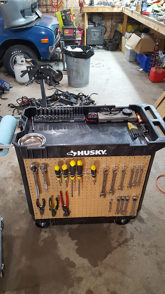

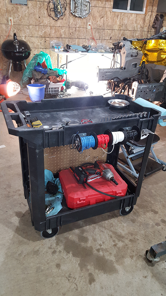

I got sick of my tool cart being cluttered with crap, so I decided to put some peg board on it and hang tools. Also put spools of wire in the back side with a soldier iron holder. Work is much easier when everything is organized. Now if I could just get the rest of the garage cleaned and organized......

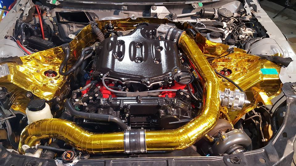

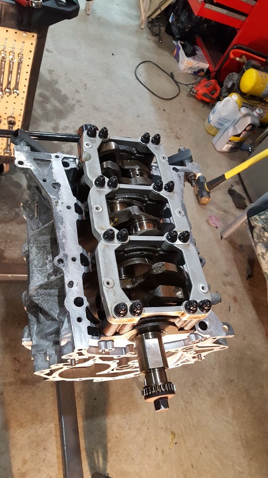

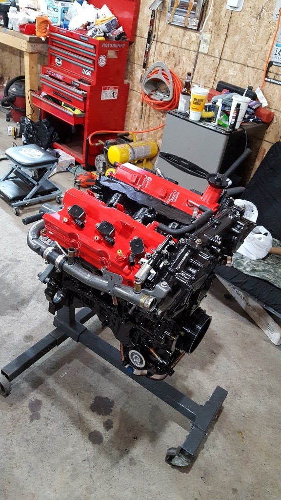

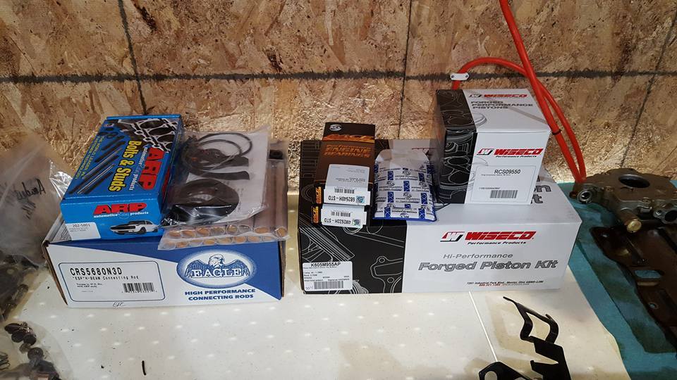

Little update:

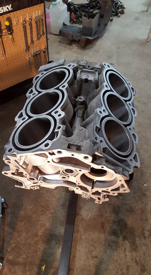

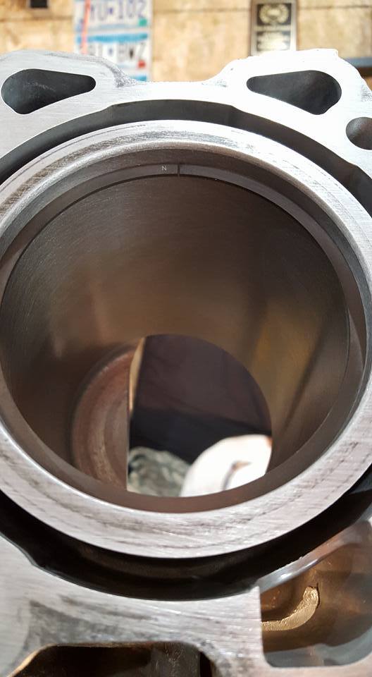

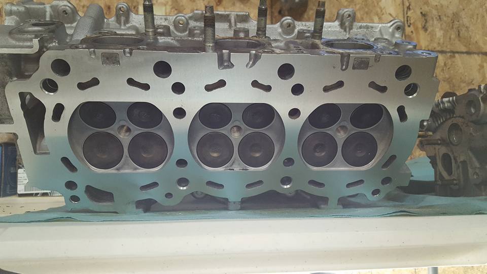

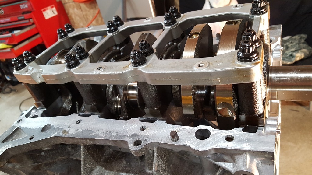

Finally got the motor back from the machine shop and started assembling the bottom end. Also checked ring gap and luckily I didn't have to file any of them (filing rings sucks). I've got a 3 day weekend so should have it together by next week hopefully. Will be shipping off he turbo CHRA to AMS tomorrow for a replacement since mine has quite a few miles on it and was starting to show signs of leaking. I've got a tune date set for April 22cnd and a show the weekend following that and starting to feel rushed.
Installed the rear Stance toe/spring bucket delete arms. Was going to do bushings while I was at it, but was having some troubles getting everything out so I decided I will tackle that job next winter when I'm not trying to get so much done.
I also got a little carried away with the DEI wrap. I wish I had browsed Z1 more because they have it in longer rolls for less $$.

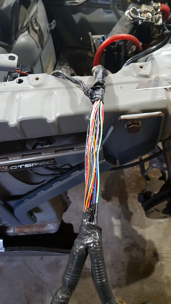

small update:

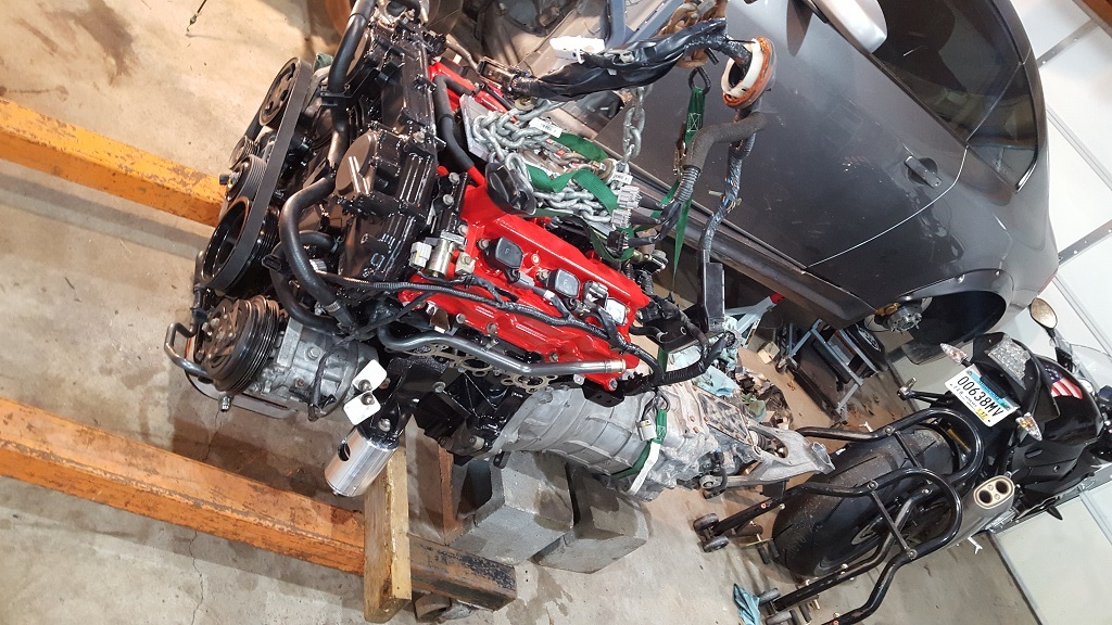

Havent taken many photos lately but the motor is built and dropped in the car. During the build I ran into some minor snags. The gasket rebuild kit that I got from Z1 did not come with a rear main seal, one of the upper oil pan gaskets, or VVT gaskets. Trying to go to the local Nissan dealer hoping they had them in stock was a mistake because they are idiots and cant understand how a G35 uses the same motor as the 350z.

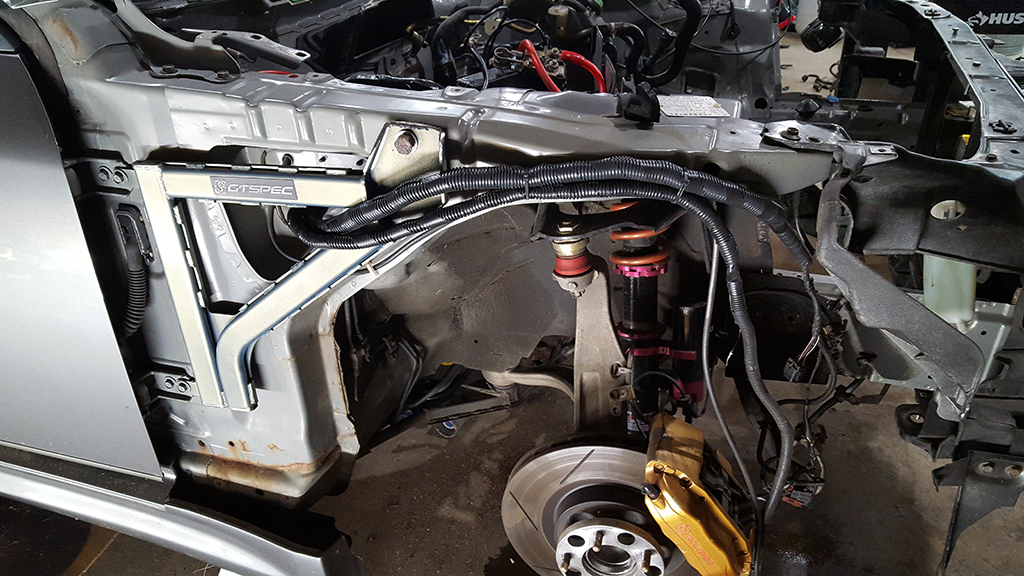

Did a engine harness wire tuck. If they would have just ran everything around the back of the engine from the start they could have cut down on a lot of wire.
I built a lift plate to avoid marking up the paint when hoisting the motor. I was super nervous with everything being aluminum but it worked great.
A couple other snags, the oil sandwich plate for the Z1 oil cooler is wrong. Not a show stopper but frustrating. I contacted Z1 and they said they would replace it, but after asking how to go about sending it they never got back to me. I would just send it to the shop but I don't want it to get lost after that because no one knows what its for. Wont give names but talked to them on Facebook, emailed, and CZP who I ordered the cooler through has tried contacting them as well and still waiting on an answer. So overall not impressed with Z1 after missing gaskets and now lacking customer support.
Also been trying to get a hold of Intense Power about ordering some headers and cant get through to them. Emailed, called, left messages, and facebooked and haven't received anything back. So right now I'm picking up some cheap no name headers just to get it running and a base tune to break the motor in. Would have liked to have the headers on before dropping in the motor but I'm running short on time, tune date on the 22cnd.

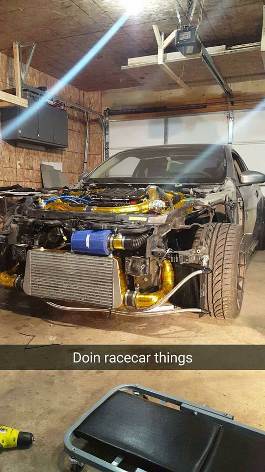

new current situation, with a few more minor things finished and back on the ground. Finally running! I've been at it every day non-stop since the last update.
Since the last update, man where do I begin?!
Finally got a replacement fitting from Z1 for the oil cooler sandwich plate. Took much longer than it should have, and had to go through CZP to get anything accomplished, but it finally arrived. I also got a hold of the company about the headers, turns out they are made to order. I didn't have the time to wait so I found a knockoff set that a buddy had and picked those up so I could get the car tuned, and I'll do new headers later. The knockoffs build quality is actually pretty good, but the holes were way off. Had to oblong every hole to get it to bolt up to the block. That was a couple day project. I also had to pull the motor back out to fit them.
Once headers and motor were back in the car, I started on the exhaust. The headers fit just a little different and caused the up-pipe to fit much tighter, turbo placement was a little different which caused the downpipe to rest on the header, and also caused the center section of the exhaust to sit too high and against the driveshaft. With some persuasion and custom brackets I was able to get everything to fit. Much tighter than before, and I also have more firewall clearance now so it worked out better in the end.
Then it was time to test fire. After getting the fuel system primed it fired on the second attempt and idled good, SUCCESS!!!! But it had a nasty squeal. Determined the squeal was p/s pump. Adjusted belt and got the squeal to go away, but also ran into a no start issue, I was getting fuel, no spark. Crap. Checked fuses, everything was good, but I wasn't getting power to the coils, and after some Googling everything pointed to the ECM relay, which according to Nissan you have to replace the whole IPDM and cant get just the relay. Double crap! After going through the FSM and testing everything from the ECM to the coils, by the time I got to the coils I had power again, so I'm assuming it was a bad ECM connection.
She livers again! Idles great, had a few small leaks that were addressed, temps look good, time for a test drive. Back out the garage and turn the wheel and steering hits something and wont turn. Turns out the steering shaft knuckle is hitting the header. So now my next hurdle is grinding down the knuckle and denting the header wall to make clearance. Hopefully will have that taken care of this evening and I can go for a test drive. I have to have her loaded up Thursday for a base tune on Friday. Fingers crossed for no more problems!

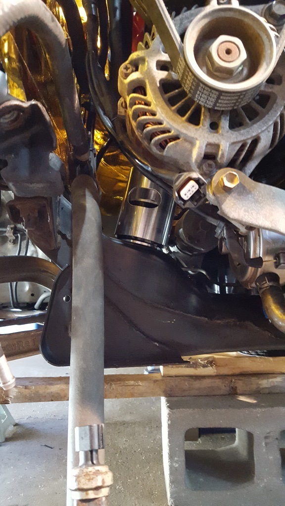

So Rod over at Z1 hooked me up with a new steering knuckle over night. I ground it down as far as I could to clear the header, and also torched the header and dented in the wall to make some clearance. The first attempt was 90% successful. It would clear while on stands, but once on the ground it would catch but I was able to pop it past the catching point with slight force, so I was able to get a test drive in. Everything went good minus overheating, which the VQ is notorious for air pockets in the cooling system. Got the car home, fronts on stands again to bleed the system. I removed the knuckle again and ground some more and got a little larger dent into the header tube, so hopefully that will clear completely now. I am a little concerned about the engine torqueing and causing it to hit again, but for now this will work to get it tuned.
So far still on the path to tuning on Friday.
