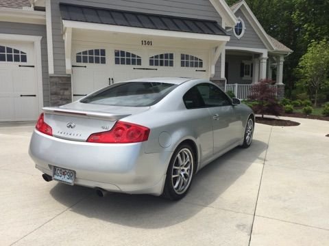

We have been looking for a 2nd car for my wife to drive. I have found an 07 G35 coupe, all options except NAV, 117k miles for $9k. Car is in excellent condition, one owner. Just a little concerned about the mileage. Anything I should look for besides the normal stuff?
