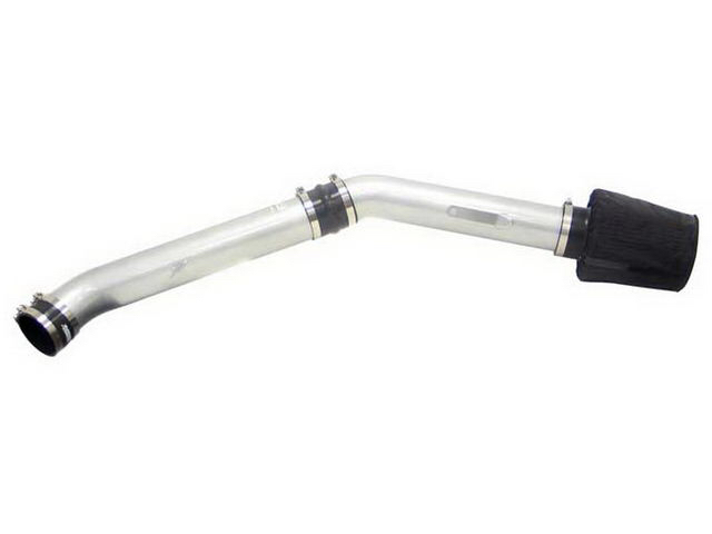

Mod 1:
K&N cold air intake
Added performance: *
Nothing until a tune
Added sound:
F*#% yeah I love the hiss
Installation difficulty: *

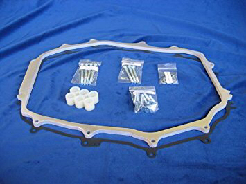

Mod 2:
Motordyne 5/16 plenum spacer
Again, nothing until a tune
Installation difficulty: * *

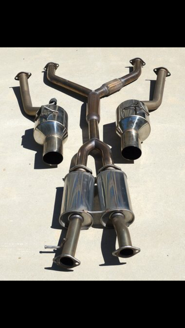

Mod 3:
Greddy evo exhaust
Added sound:
Eh, I think I like full stock exhaust better

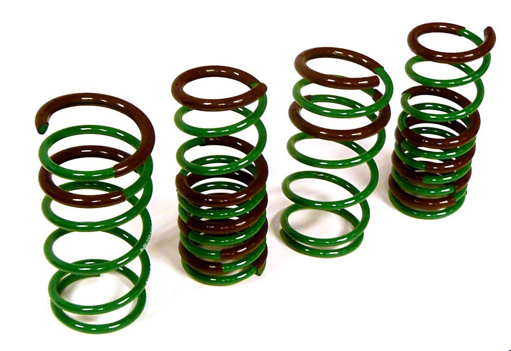

Mod 4:
Tein S-tech for 350z
These drop an additional .5" lower than advertised Z drop on a G.
Added style:
Duh. Static 'til the day I die and afterwards.
Installation difficulty: * * * * * * * * F@$&

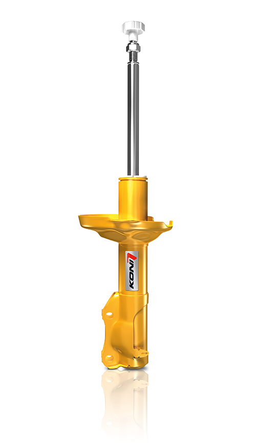

Mod 5:
Koni Adjustables "better traction for the whole shot" -lolol
Added performance: * * *
3 stars for the dampening adjustability. I can go soft to hard in seconds. With a few things..

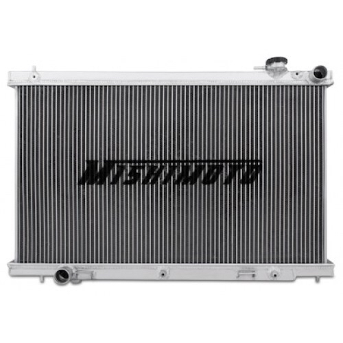

Mod 6:
Mishimoto radiator
- 2 stars for reliability and seems like it could handle a track day
Installation difficulty: * * * * * Not a direct fit like advertised

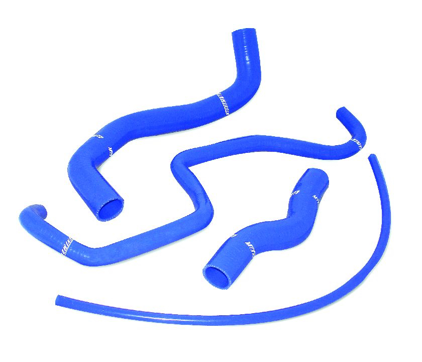

Mishimoto hoses
Added performance:
Crap quality, one popped a few months in. Replaced it with oem and no problems since.
Installation difficulty: * * * * draining and bleeding coolant is never fun.

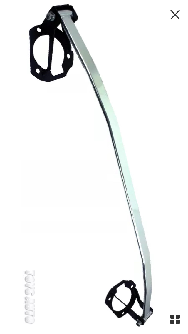

Mod 8:
eBay strut brace
Added performance:
Placebo effect

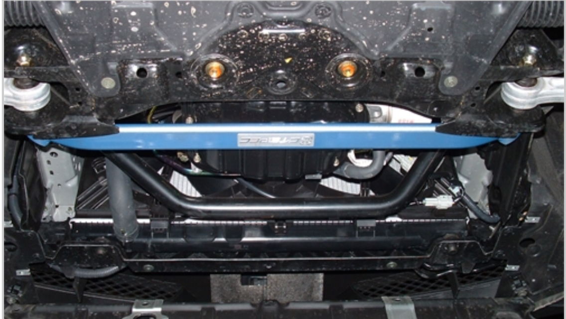

Gt spec front lower tie brace
A small increase in stiffness and handling feel

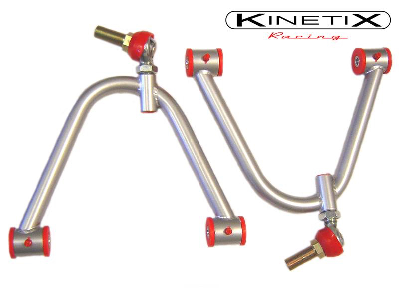

Mod 10:
Kinetix front camber arms (upper A-arms)
2 stars due to the fact that you get permanent camber angle once you establish where you want it. Which is god sent.

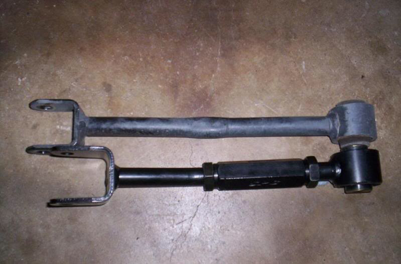

Mod 11:
SPC rear camber arms
Good alignment helps prevent future problems

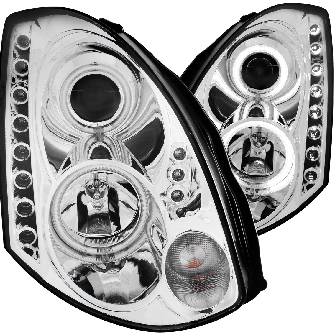

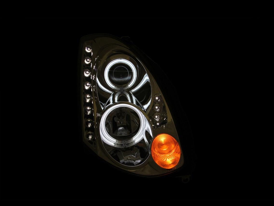

Mod 14:

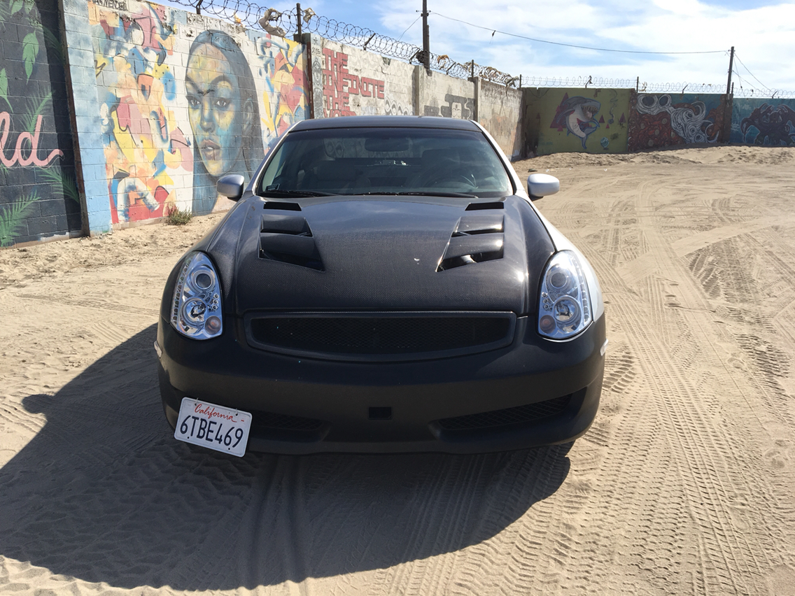

Anzo headlights
Added performance: - *
Low beam: crap
High beam: crap
Leds: kinda cool
Built in halos: cool af
Anybody who actually entertains aftermarket headlights gets these Anzos with the black housing. They don't look bad at all. I sold my projectors and bought these with a couple hundred bucks left over so I'm not complaining.

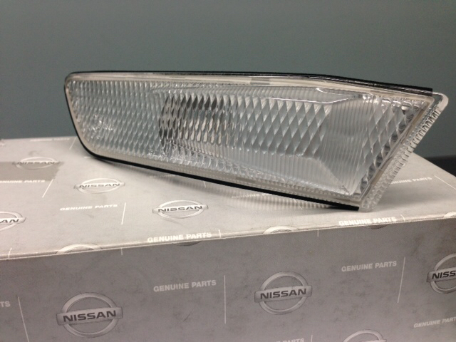

Mod 15:
JDM side clear side marker w/ bump
Added style: * *
I love the bump. Most don't. But I love it.

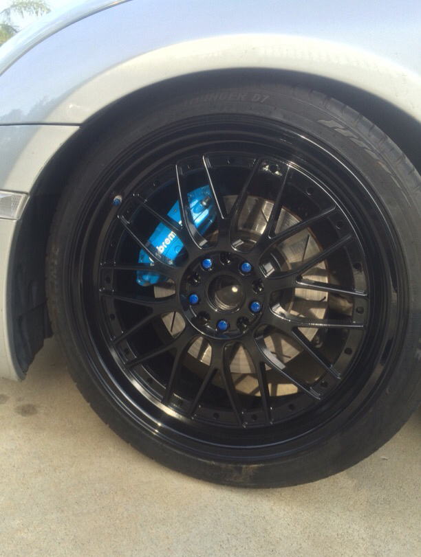

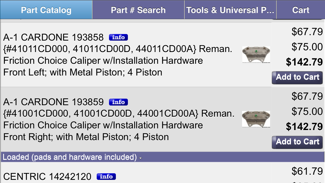

Brembo calipers + Z1 upgrade package
It's a shame Infiniti got rid of the brembos for the 06/07. @Jerseytaylor pointed out these remanned brembo calipers by A1 Cardone and I'm so glad he did. The Z1 upgrade package isn't playing around either.
Installation difficulty: * * * * * took prob. 10 hours
Price: $$$$$$$$$$$$$$$$$$$$$$

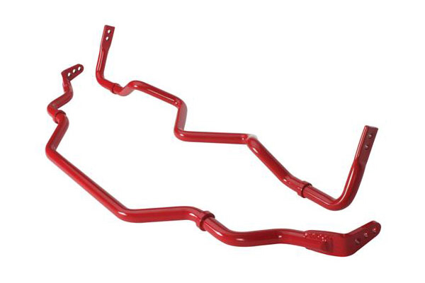

Mod 18:
Stillen front & rear sway bars
Added performance: * * * * * * * * * * * * * * * * * * * * * * * * * * * * * * * * * * * * * * * * * * * * * * * * * * * * *
Ok I might be exaggerating a bit, but honestly, best mod for the money by a long shot. Trust me trust me trust me. You're welcome.

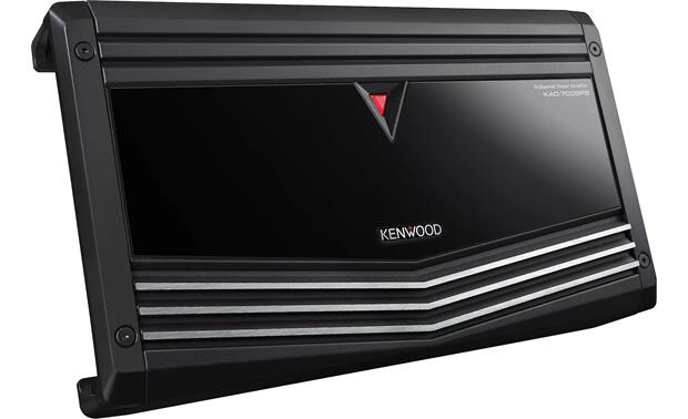

Mod 20:
Kenwood 5 channel amp
Great power generation, middle of the line. Fits perfectly under the passenger seat without interfering with any of the seat movability.

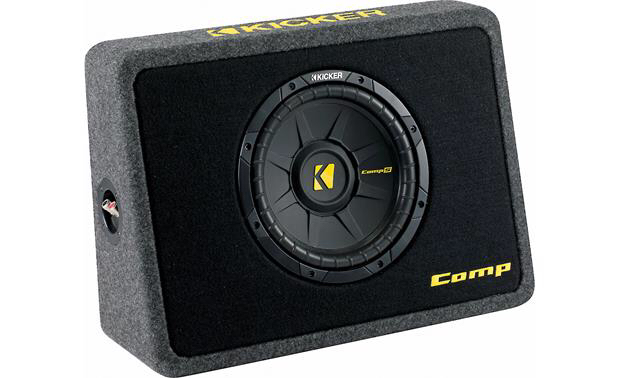

Mod 21:
Kicker comp sub
Doesn't hit very hard, but gets the job done. I'm not trying to vibrate the doors off like some dudes though.

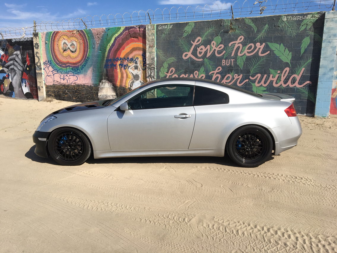

Here's a few shots I recently took of her doing her Christina Aguilera dirty impression:

Mod 6:
Mishimoto radiator

Mod 11:

Mod 15:
Added style: * *

Mod 18:

Mod 14:
Anzo headlights
Attachment 177080
Attachment 177079
Low beam: crap
High beam: crap
Leds: kinda cool
Mod 18:
Attachment 177082
Attachment 177082
I've been saying for years if I could do one and only one mod to the G it would be sways. My preference are the Motordyne but you just can't go wrong with Hotchkis, Stillen or the MD. They all kick azz!!!
But then you totally redeemed yourself here.
And damn right, springs + sways and that's it!!!

Kinetix fuca
Can u add more feedback on kinetix fuca? so I heard that it is a blind adjustment? how much angle is a full 360 degree turn of the ball joint? a lot of alignment shop hated it for that reason since you have to guess and remove the wheel again if you don't get the spec you want? how'd you dealt with this BOE?
It's not blind at all. Each turn is worth .3 degrees of camber. Best way to do it is with the initial setup make them the same size as the stock arms, then go two full turns out (longer; aka .6 degrees positive), take it to an alignment shop, measure where it's at and you'll only need to fine tune once from there. It took my tech about 30 seconds to fine tune it with me there showing him how they worked.
nailed it! thanks for being specific. Took me a bit to figure out numbers but i get it now!
BTW, great thread OP! +1 MD spacer, spc rear kit, clear corners & sway bars!
