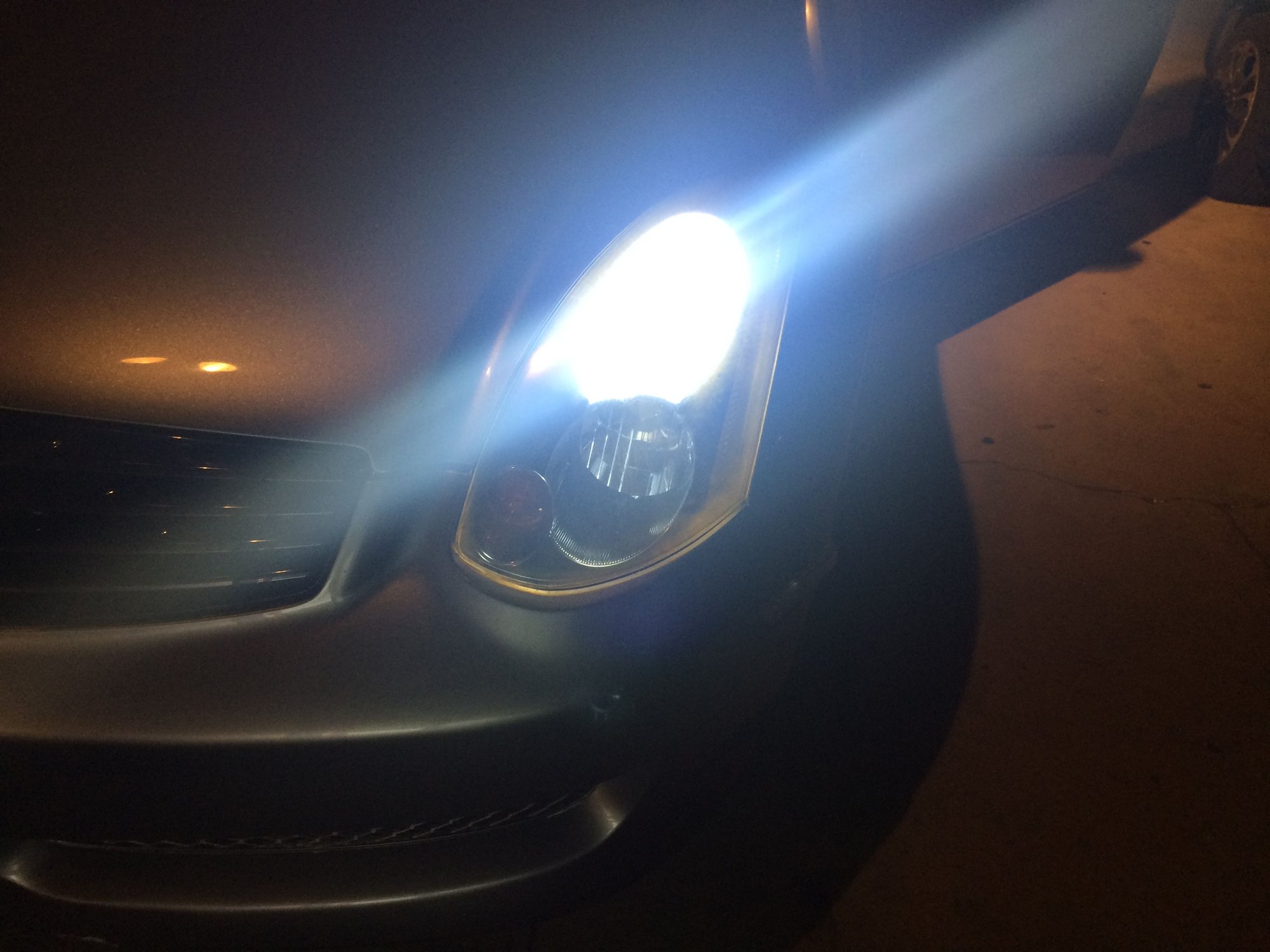

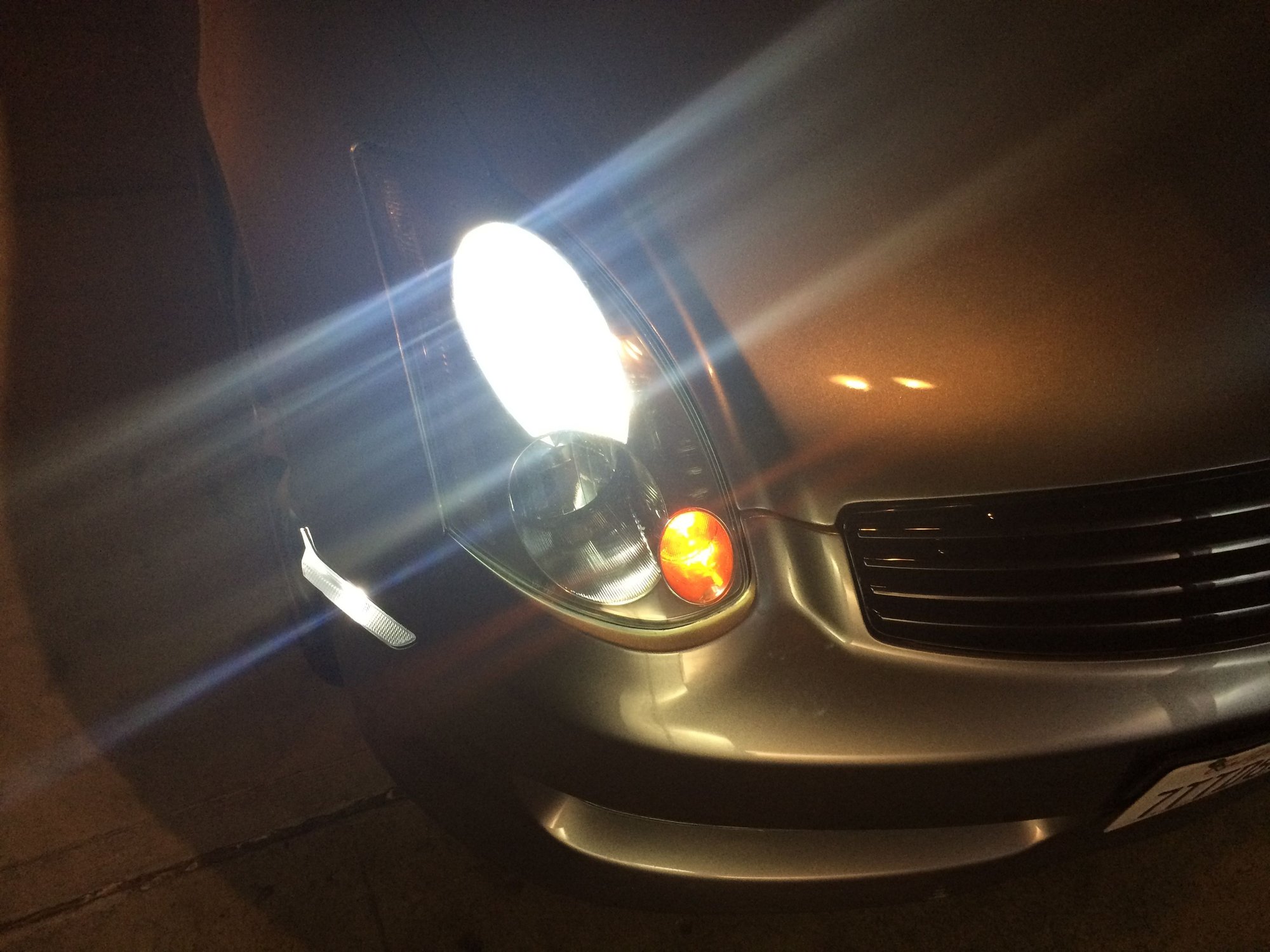

Not all the lights from my headlights are turning on and I don't know which ones they
Old Nov 18, 2016 | 10:41 PM
eb1904's Avatar
5 Year Member
Joined: Oct 2016
Posts: 16
are i took pictures of them and if you guys can tell me which ones I need to buy and how i can install them it would eli me a lot.

Seeing your car is an 05 (yes I stalked your profile to find out lol) here we go.
The top lights that are both on are D2R high intensity discharge bulbs. They function as your low beams.
The bottom large lights are H4(also referred to as 9003) halogen bulbs. They're a dual-filament bulb that power your high beams and fog lights. They're probably not on in the pictures because you have neither turned on.
The bottom orange lights that only one is lit are 7443 bulbs. They are also a dual-filament bulb that function as your running lights and turn signals.
The lights on your fenders are 168/194 bulbs. Those are called your sidemarker lights.
Post #4 in this thread will clarify with pictures for reference. https://g35driver.com/forums/g35-cou...s-06-07-a.html
HTH and welcome to the family...........

To replace the bulbs in your headlight assembly you need to access the back of each light. Jack up the front end of the car, remove the wheels, remove or peel back the front inner fender liner and each light will have a round plastic cap that unscrews to access the bulbs. Remove and replace as needed. People have also just left the car on the ground, turned the steering wheel hard to one side and reached in there to finish the above process. My car is way too low to do that. I'd recommend my first method since you will have a clear view of everything and learn about your lights in the process of replacement.
The sidemarker light assemblies just pull out of the fender and bulb replacement should be self-explanatory from there.

Agreed with blue dream. Do those lights blind you as you walk up to the car though? They look awfully like D2S bulbs in the D2R socket...

Also needs a 168/194 in the side strip running light.
