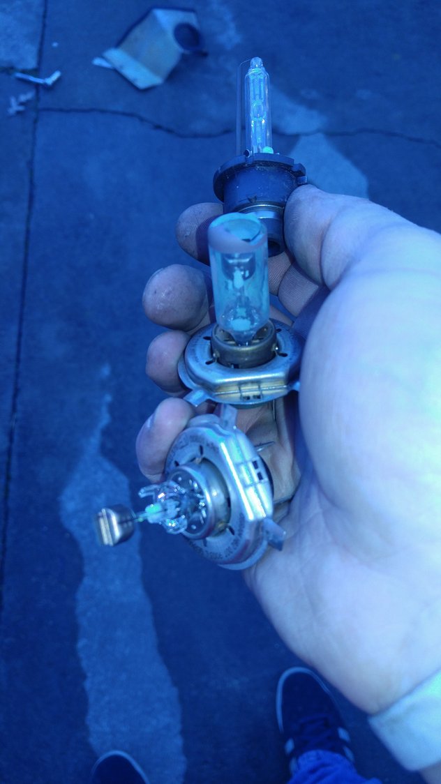

Ok both highs are completely and utterly destoyed...have no idea how both can go out like shatter at the same time. It already has an aftermarket ballast. I'll see what kind when I get back on the way to parts store now.

snap a pic of the headlights. they sound like they have been modified

Thats what my high beams looked like. I went ahead and bought a bulb for low beams put it in and it works fine the last one had a burnt spot where the connection touches the metal ring around the bulb. I never checked to see what kind of ballast it was although it had a ballast and then like a little rectangle piece coming out of the ballast....i dont know it was all new to me i went ahead and took the original ballst apart and mounted the others using the screws, the star screws. I HID everything better than the crap job someone had done before. Also added some screws that were missing to the bumper. I didn't take any picture due to my wife calling saying hurry up the kids are screaming.....gotta love it. I think it was a very productive day. The part store had a HID bulb for $48 and the high/fog were only like $6 a piece. All in all I spent around $60 and now I have brights and dogs woot woot. Thanks for all the information guys it really paid off.

Managed to stick the phone in there and click this.

No problemo. Hid for projectors or factory reflectors only, and halogen for normal reflectors works best. Looks like you got it all figured out!
