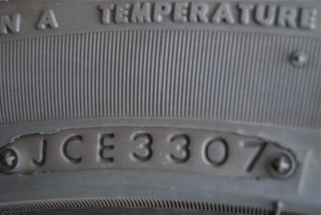

Originally Posted by 03G35C6MT
It only had 89,000 on it. Tires are at the right pressure and the ebrake isn't dragging at all.
Your tires could be at the right pressure but check the date codes on them
Photo taken of tires on my previous G35
That tire was produced in the 33 week in 2007
If your tires are more than 4-5 years old get rid of them as they become dangerous.
Telcoman
