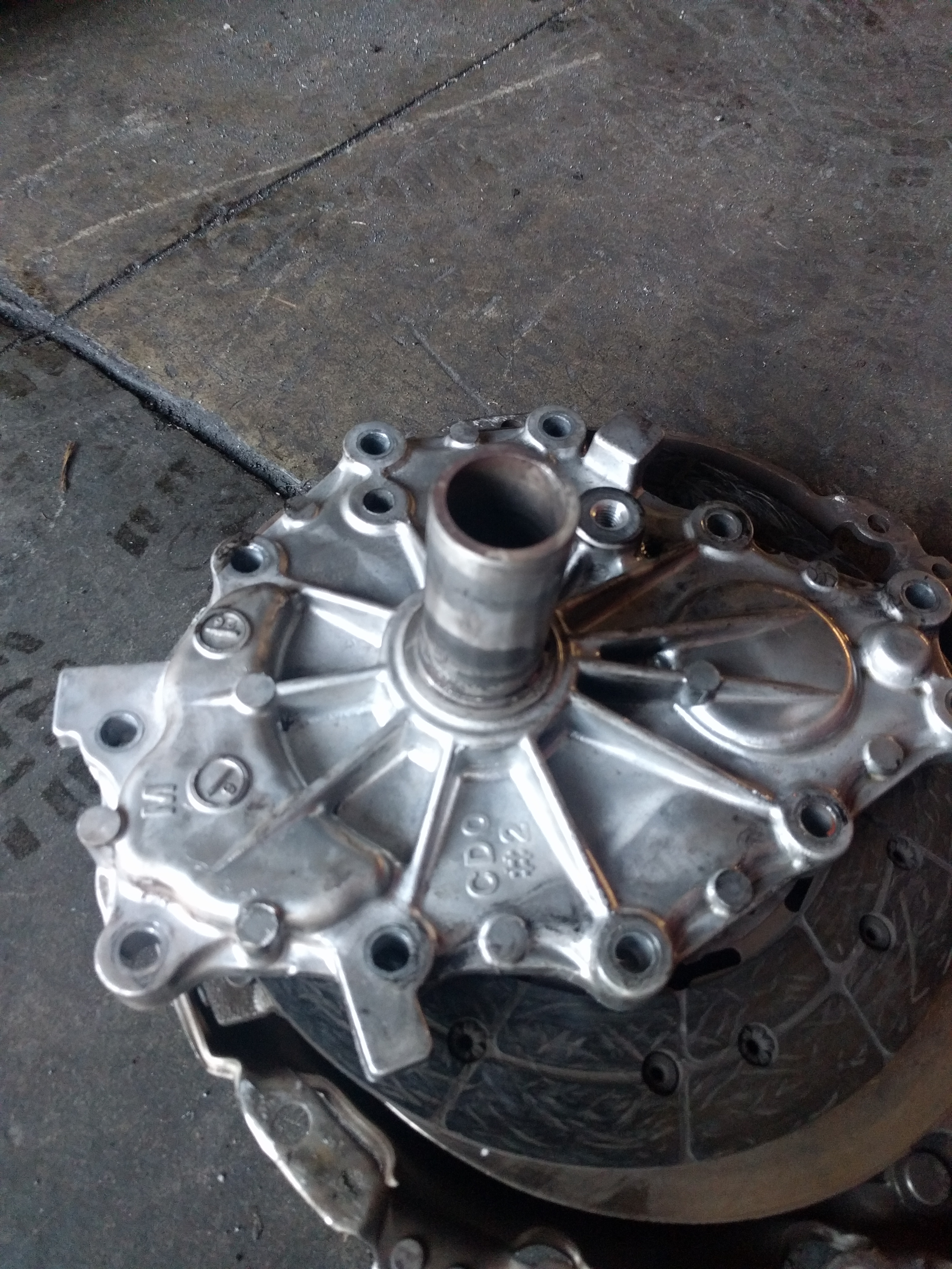

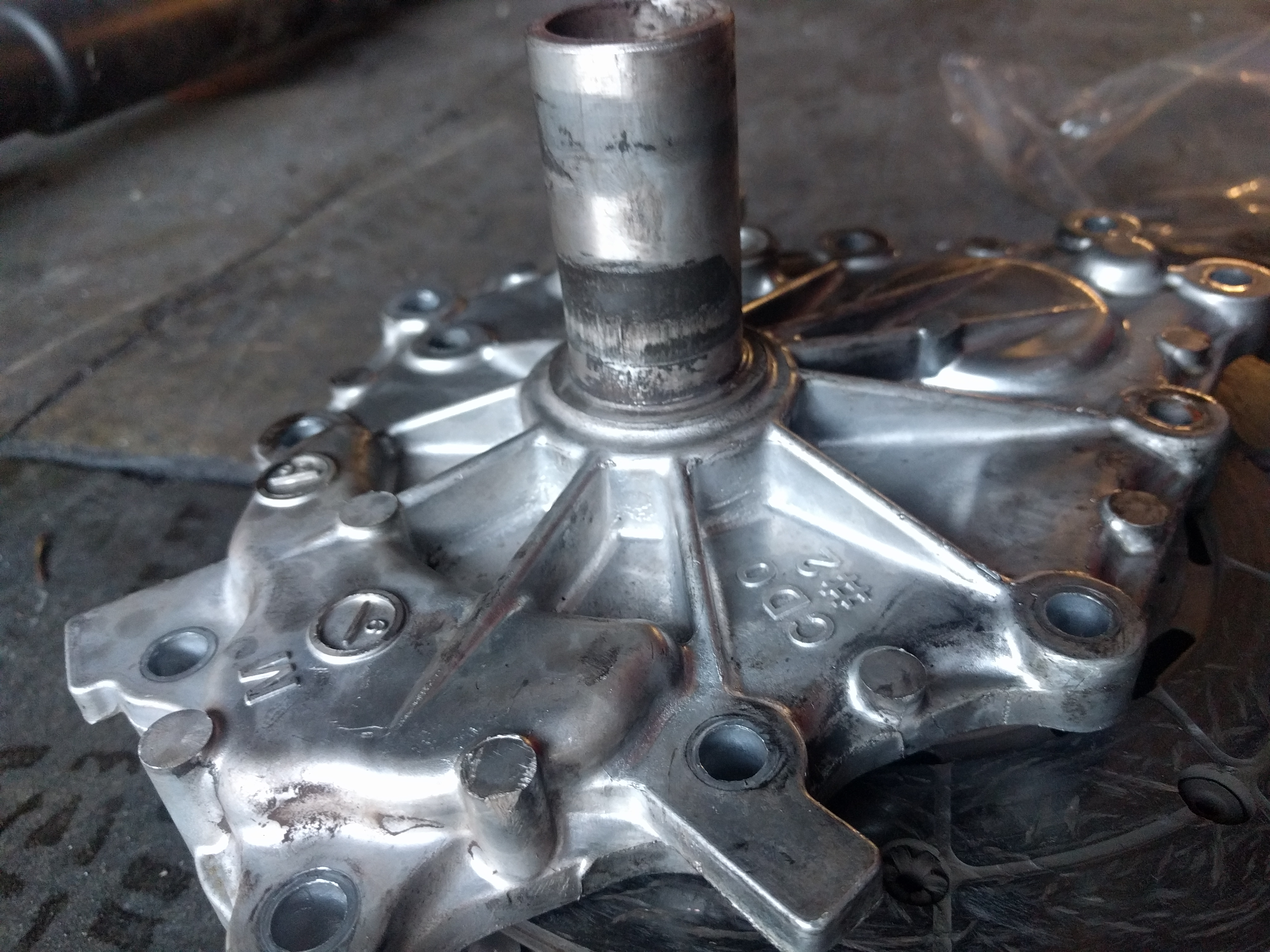

shop calls me after few hours of work and tells me something out of the ordinary. saying i needed an additional part to complete the install. of course i hesitate and wanted to know more about the problem. he describes the reason for me having a sticky pedal is the 'transmission front cover' is damaged. apparently after years of use (almost all driving during my time is city driving; do not know about previous owner) the shaft shows signs of wear, mainly sratches perhaps from the throwback bearing rubbing all these years. see pics. she says because of this compromised surface, the bearing can no longer freely slide through the shaft because there is added friction to the surface. see attached pics. the dark areas is what he is talking about.
of course at this time i really did not want to have to come back or go to the trouble of having to dis-assemble the clutch assembly again so he had me by the ***** and i had to just replace it. i looked up the part afterwards, and did realized he charged me double as i presume its implied labor for the front cover. but you cannot win them all!
dear community, i am not a car expert but wanted to know is this a legitimate reason to change the, transmission front cover?? was his reasoning legitimate?

Looks like some serious scoring or gunk build up. I could see that causing a problem. Considering the clutch had to be replaced at 30K miles and again only 100k miles later, I'm sure it has take some abuse.
You don't have a lighter flywheel, it's the same as the OEM dual-mass setup. I have that same clutch on a lighter solid flywheel, and it's pretty chattery. I bet shifts feel nice and mushy with a sprung disk attached to a dual-mass flywheel. The OEM disk was solid since the dual mass flywheel provides the dampening.
