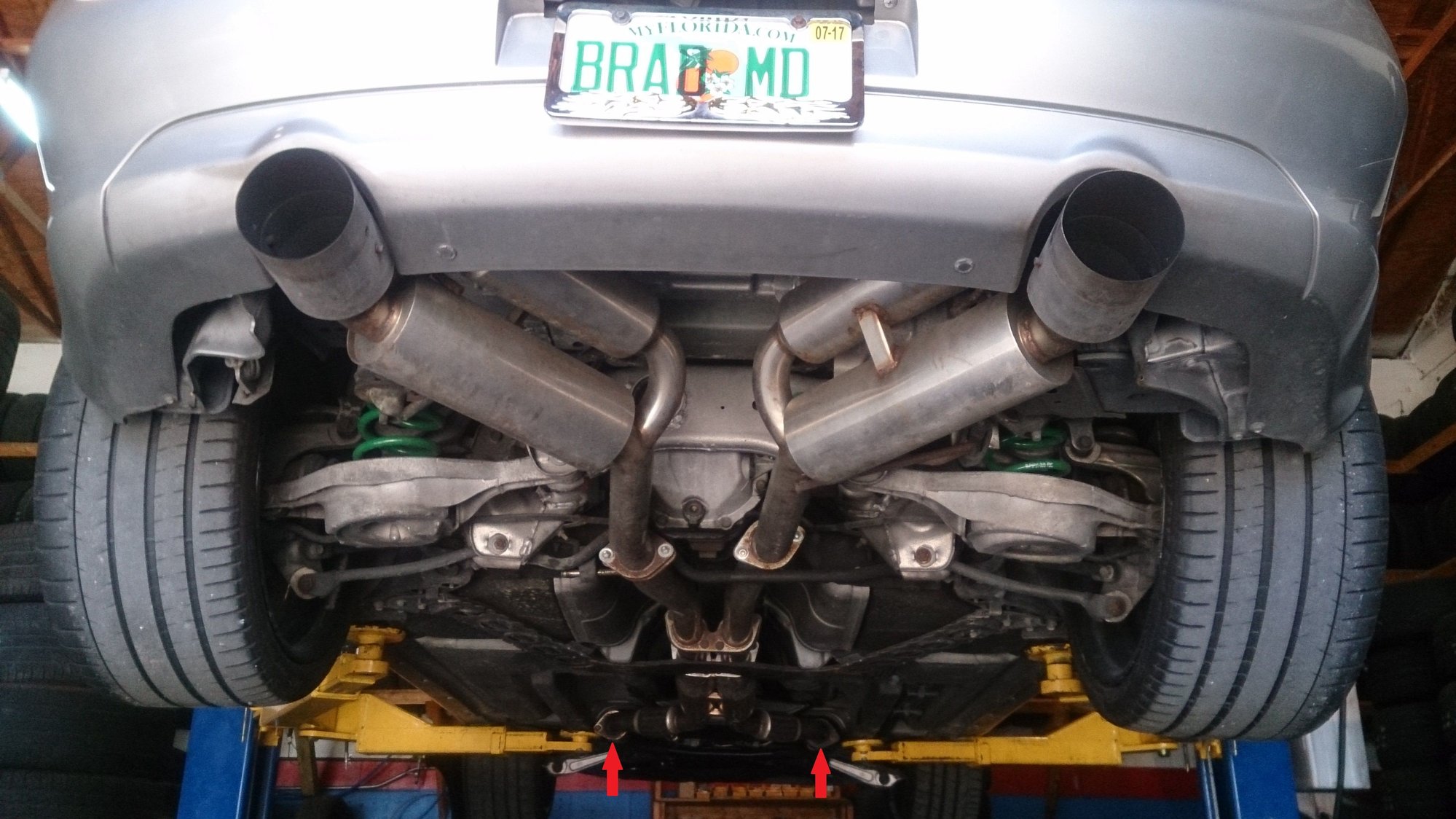

This is a true dual - the arrows show the end of the cats/start of the catback exhaust
Oh ok. And that looks good by the way. Similar to what I want to get. Yours?
Look @ the license plate.
Old Mar 1, 2017 | 01:33 AM
Riffe's Avatar
Joined: Jan 2017
Posts: 32
.... Yep, I definitely missed that.... oops.
