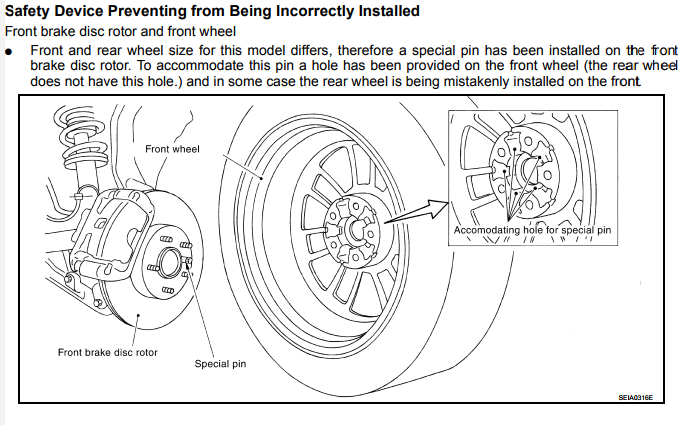

An easy way to tell if the front and rears are mixed up is to look on the inside of the wheel around the lug nuts. You'll have to remove the wheels from the car to check.
The 19" x 8" FRONT wheel has deep "spaces" in the areas between the lug holes. The 19" x 8.5" REAR wheel is mostly flat between the lug holes.
Waaaay back when your car was new, there was a random bolt attached to the front rotors. This was to prevent you (or a well intentioned mechanic) from mistakenly mounting the rear wheels to the front of the car. The front wheels have space to accommodate this "special pin" on the front rotors.
Most of the time that bolt gets tossed when rotors get replaced, or you want to run wheel spacers, or aftermarket wheels, or the car originally came with 17" wheels that are actually the same size.
Attached Thumbnails Why does my tire look like this? Small tire on bigger wheel?-g35-safety-device.png
