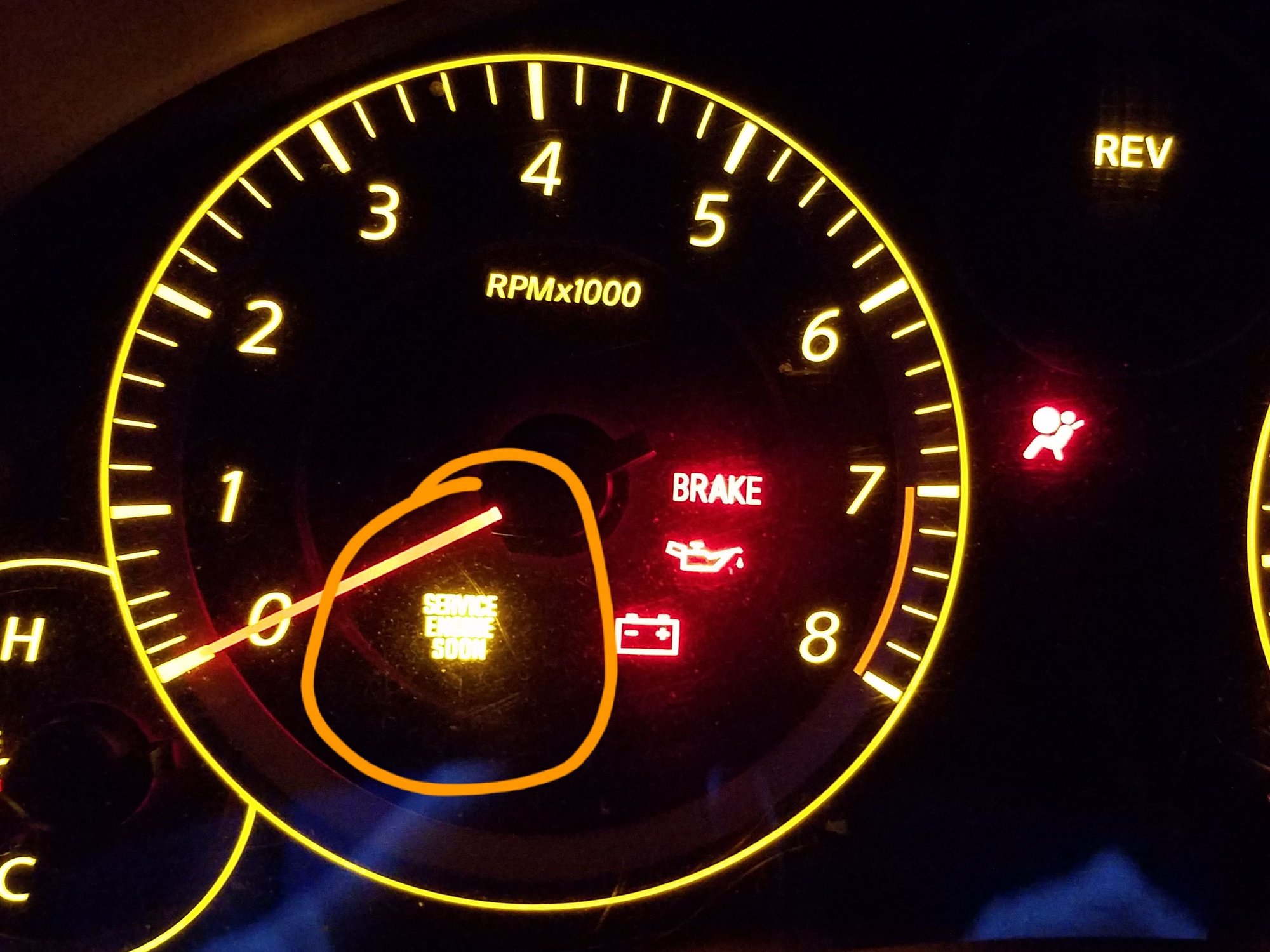

I just bought this car and love it already but what is this wire and what should I do about it?

What year and trans is your car? Do you currently have a check engine light? Are those connectors just ziptied to the front?
Those green and blue connectors are for the variable exhaust cams on the revup engines found in 05+ 6MT cars. Without knowing anything else, it looks like the engine was replaced with a regular DE engine, that doesn't have the variable exhaust cams. A replacement revup engine is actually a pain to find, so a lazy shop just stuck an engine in there.
You probably have orphan connectors on the back of the heads near the firewall also, for the exhaust cam sensors. Plus a check engine light.

its a 2005 g35 coupe 6mt, the odometer says it has 103k miles... so this is probably an engine swap? i had no cel since i bought it but there was a low tire pressure light on at one point. whats the difference in the rev up engine and this one? do yall think i got f*cked? i paid 6k for it and i know it needs a throwout bearing thats all i know and i thought id just get a whole new clutch while im at it. it whines when it idles and i press the gas, but goes away when i engage the clutch. damn i hope i didnt get f*cked that bad lol

hey, so I just set it to on and it seems like every light is on, as they should be right? Does this mean my check engine light should work if there’s a problem? I hope he didn’t disconnect whatever would make the car throw codes or something...

Without looking at the car, can't say if you've been screwed yet. It is very possible this has an engine swap, an 05 6MT should have the revup engine.
When doing the light check, you should see an orange "service engine soon" light.
The light is an LED, so it's not exactly easy to disable like pulling a bulb on older cars. The best test is to plug in a scan tool and see if any codes are there.
The revup engine has exhaust cam phasers, as seen here:
The non-revup engine from automatic Gs, or all 03-04, don't have exhaust phasing, only intake:
I have no idea if the wiring harness supports swapping the ECU, but if a shop installed the wrong engine I doubt they have the tools to reprogram the immobilizer.

So I still have a chance to have a cel or any other codes even though the light check is okay?

Probably do not have a CEL but it won't hurt to throw an OBD2 scanner on it anyways. Not every diagnostic trouble code turns on the CEL and if they did swap ECUs then it wouldn't even be looking for the exhaust cam solenoids or phase sensors.
