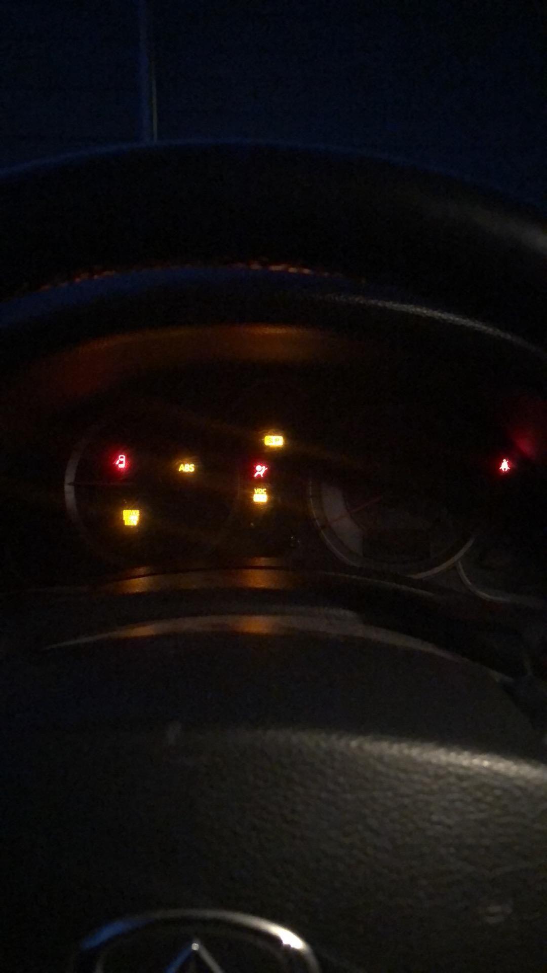

Hey fellas, while replacing my blower motor relay my odometer light & the light that light up the numbers for the speedometer work intermittently now. Also my radio remains on while the vehicle is off. anyone have an idea of whats going on?

Two of those are LED, how is the battery?

This happened after i replaced the relay.
The vdc, slip, abs, and CEL were on already prior to me replacing the relay.

My guess is you jostled something on the Fuse Block J/B when you were replacing that relay. There are 1-3 other relays on the back of that fuse block, make sure everything is still pushed in all the way and that there's no obvious signs of something loose.
Did you do the work with the battery hooked up?

yeah the the battery was plugged in while I did the work, I’m guessing I should of unplugged it 😅
