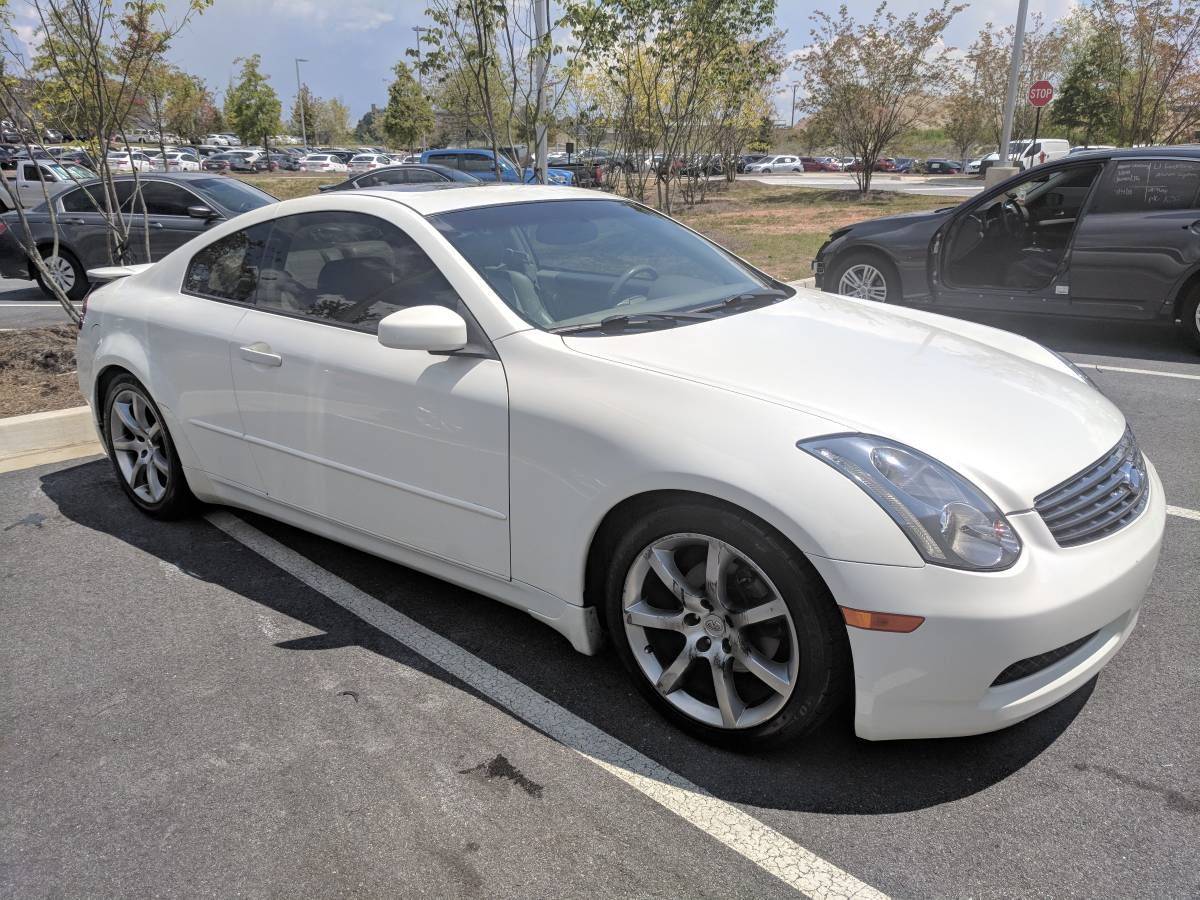

Hello everyone! I just picked up my first Infiniti. It’s a 2004 with just under 160k on the clock. I’m moving here from the CorvetteForum. I’ve owned a couple C6 vettes the past few years but after wrecking my last one, I wanted to do away with some unwanted debt and decided against buying another one. So here I am! I plan to use this as my commuter car but would like to do a little exterior modding. My only thoughts right now are to have the tail lights tinted, powder coat the wheels, and swap the headlights for black ones. Maybe some black emblems as well. I do have a couple questions though. With the C6 corvettes you could remove the lights and pop them open after heating them in an oven. However corvette headlights were extremely expensive and I’ve found that Infiniti headlights aren’t. Should I buy a new set or pop these and paint them? Also, this thing has more pep than I expected but it’s definitely not the roaring V8 I’m used to. What would be the best bang for your buck performance mods to get a little more out of the car without getting too crazy?

Thanks for all the info Cleric. Definitely don’t expect to be getting LS numbers out of this thing without some FI but I’d like to get a little more out of it at least. Can’t wait to start modding it.
