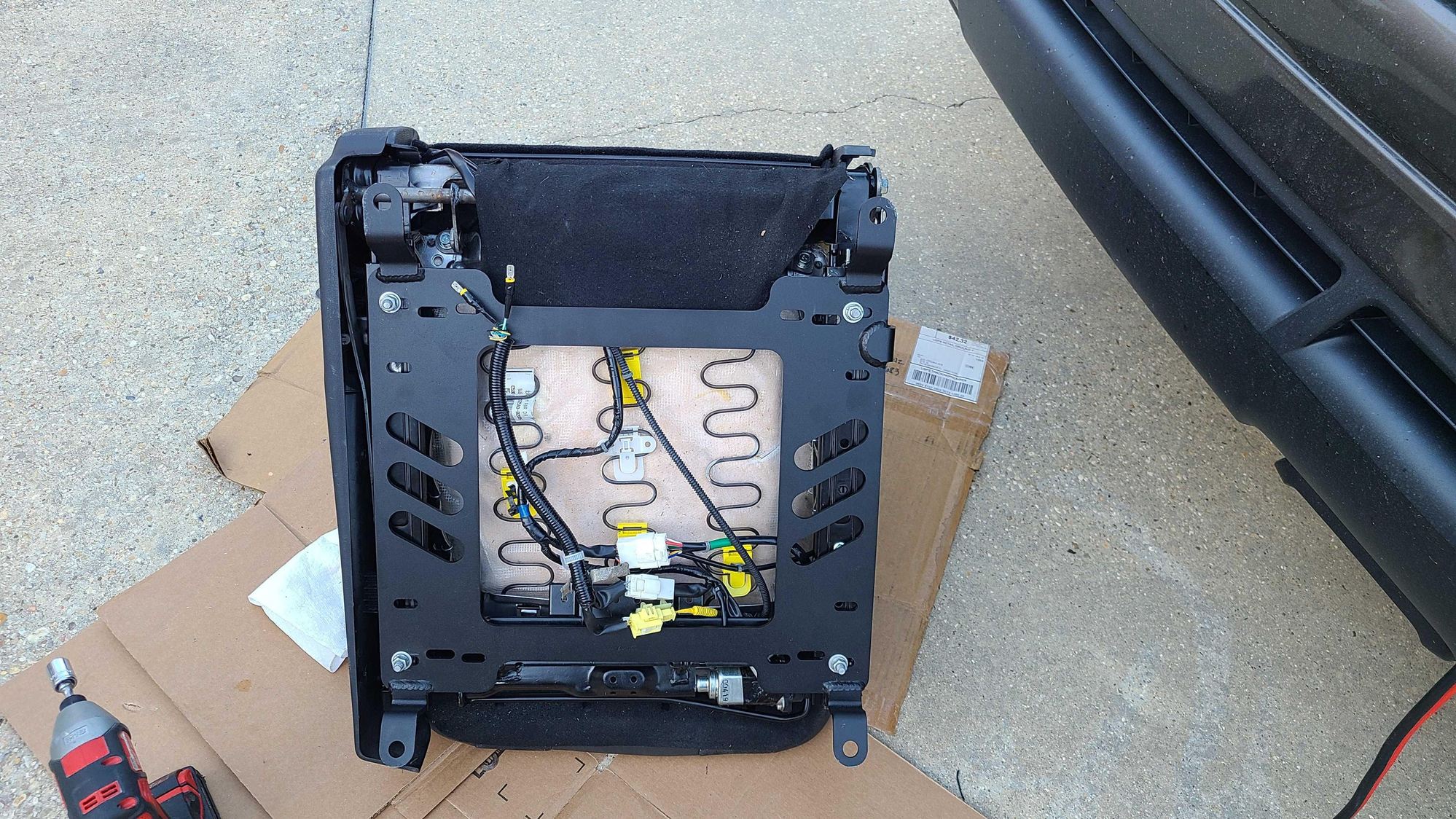

Has anyone done this? I'm starting on the passenger side now, but I'm having trouble. The connector surprisingly connect but none of the seat functions work. Any help is greatly appreciated.

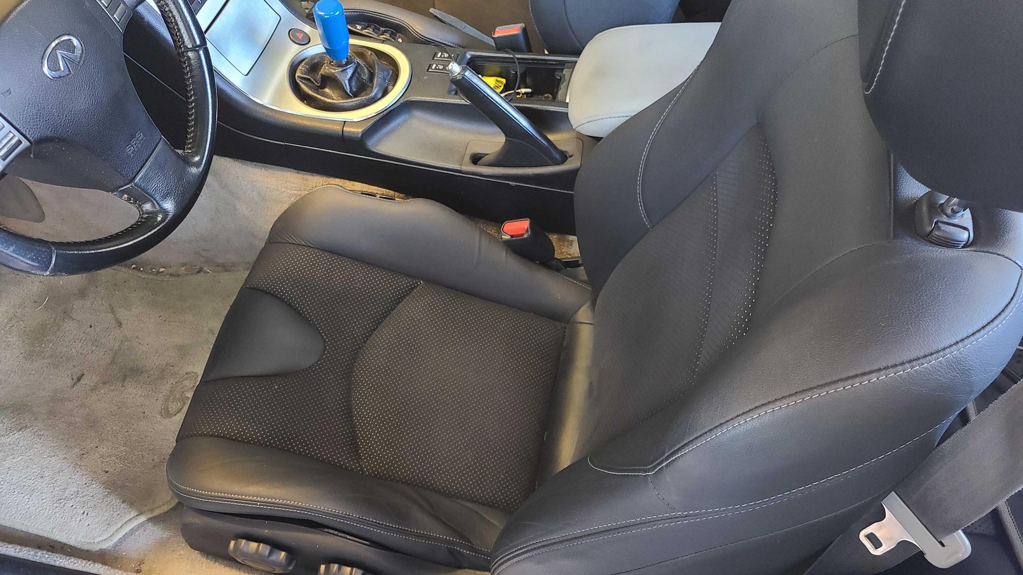

Yes I did. I had a friend do the wiring because that was above my skill level. I bought these seat brackets:
https://shop.redline360.com/products...passenger-side
I believe I purchased the tall version for driver/passenger. I was able to remove the stock bracket from the 370z seats and bolt this bracket to the seats.
