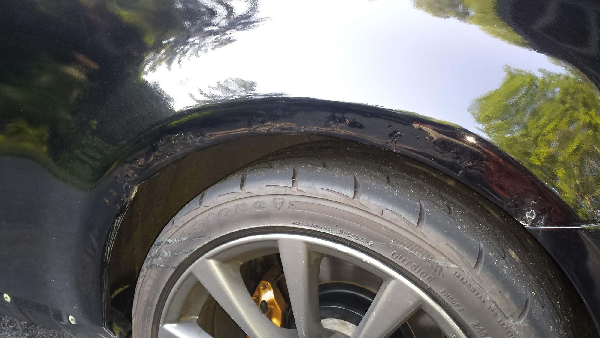

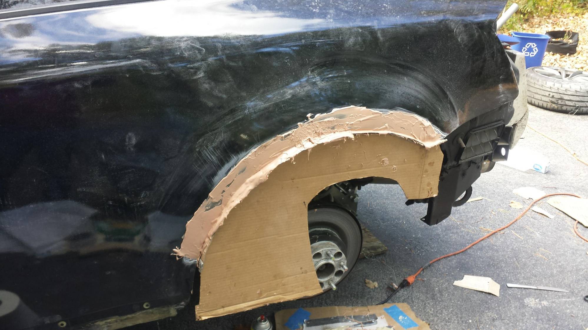

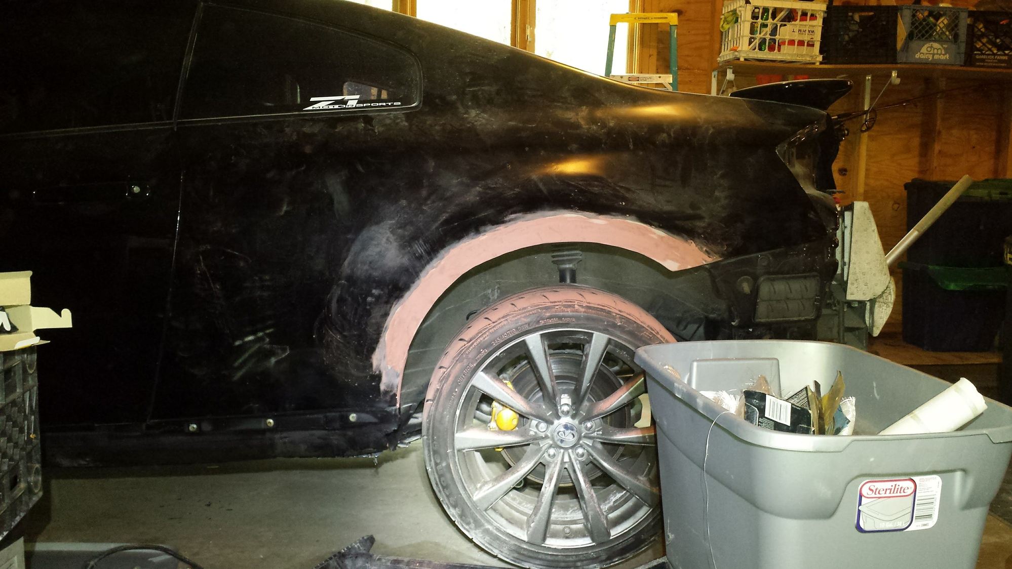

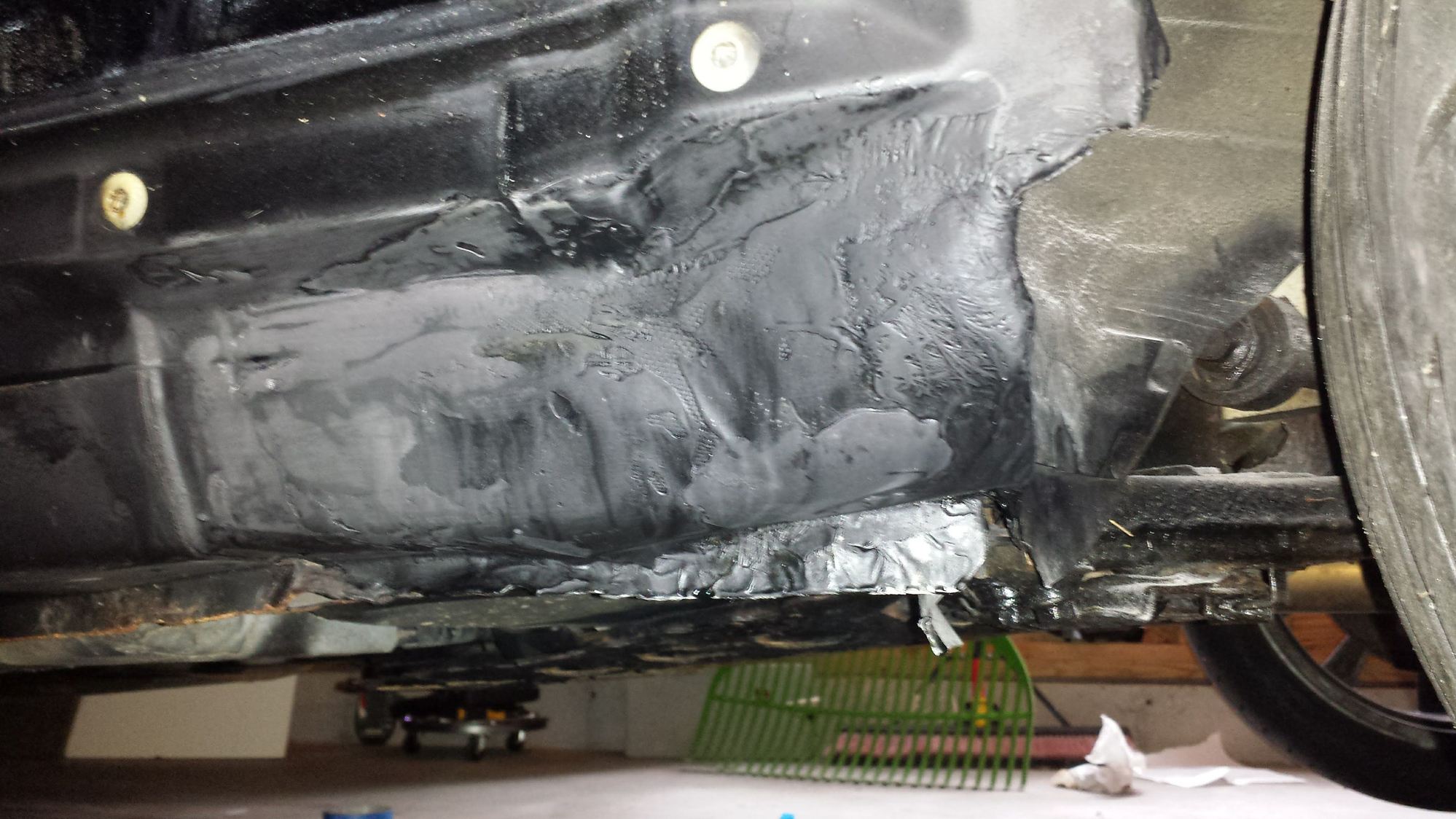

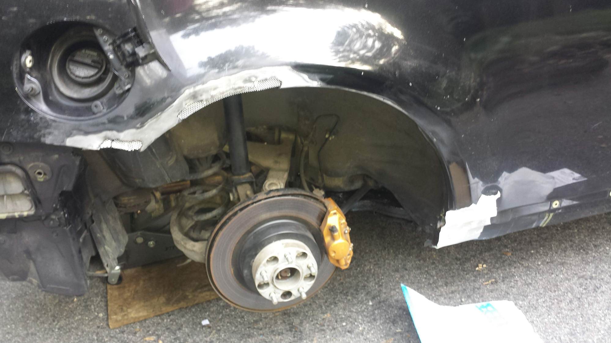

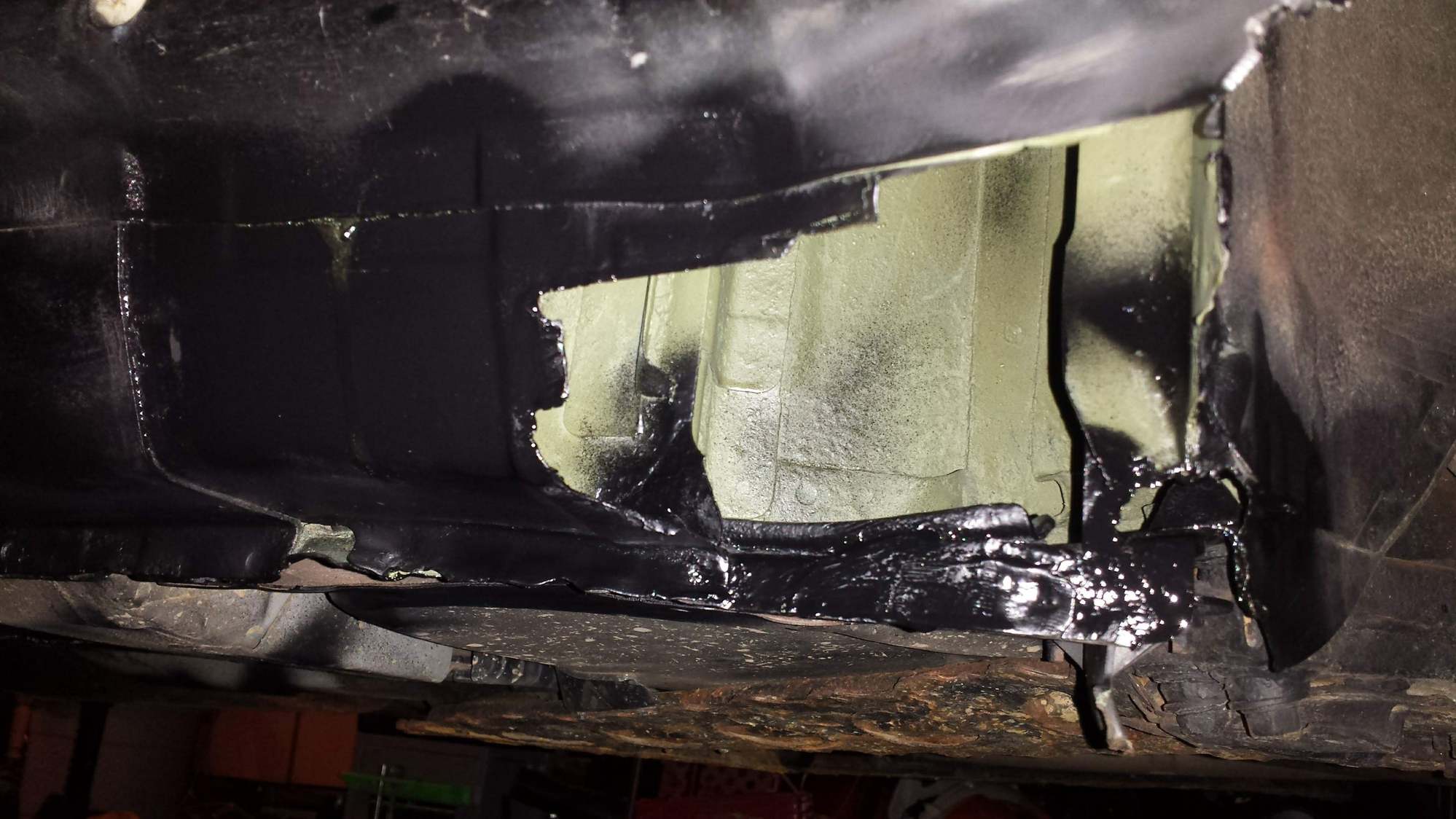

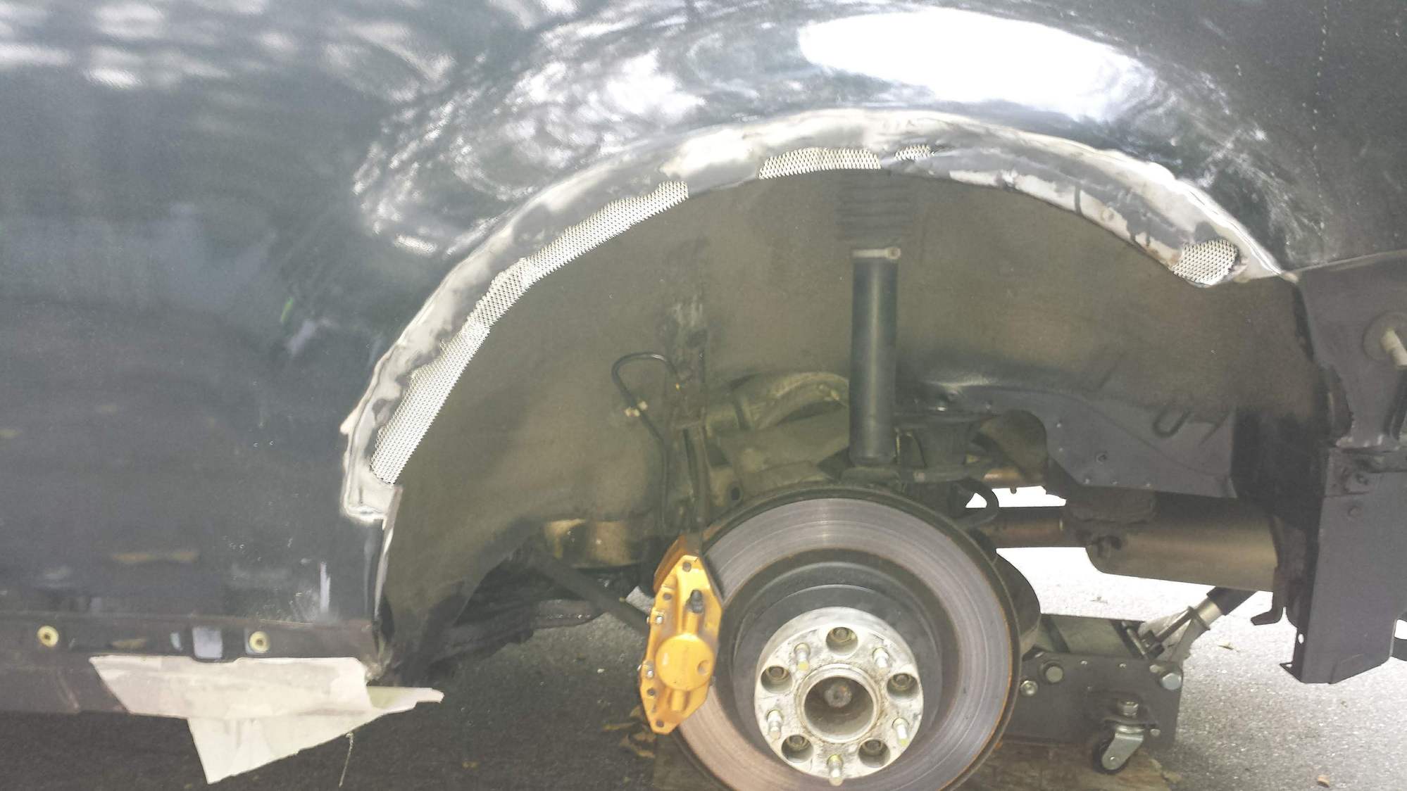

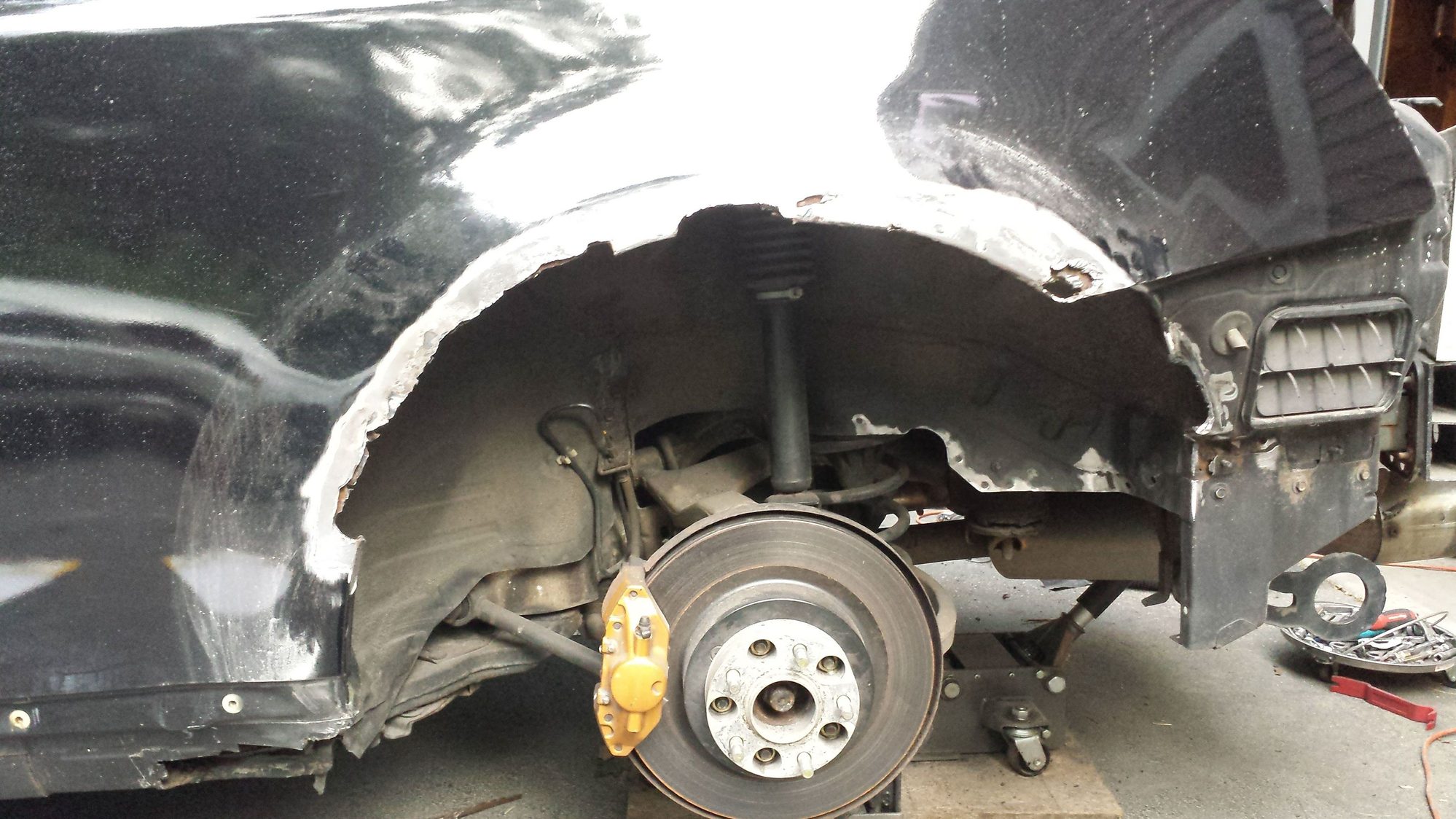

Let me do a quick image dump of some Bondo hackery. I am not proud of this repair but it's kept my daily driver from rusting structurally which was the goal. Obviously I'm not a body guy, this is my first (and last) time doing anything like this, but it came out well given what I started with - Car would look passable dipped or with some fender flares, but paint will never look good on these arches again.
Giant hole in front of wheel well after grinding out rust and covering in rust converter and inner frame coating. This is the reason I did this repair, to stop future structural damage
Fiberglass sheet slathered over the first hole.
Driver side wheel well rust pre-"repair"
Same side after grinding out "all* of the rust
Mesh to support Bondo

Cardboard "mold" to keep wheel well arch shape. I made this before chopping out the original rust.
Fiberglass bondo added and sanded
I covered the repair in black plastidip and been daily driving this shitbox rain snow or shine ever since.
