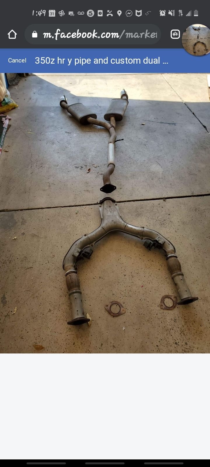

got a friend who has this will give it to me for 100 bucks. Ive got a g35 coupe all stock (im running on just resonators no muffler.)
This is a off a 350 z any thoughts on using this temporarily until I pony up gor a real set up?

That's the HR y-pipe, supposedly better flow than stock DE. Nice.
350Z exhaust system is a few inches (I want to say 8") shorter than the G35 coupe system. You will need to extend it, I believe they are extension pipes available on market to do so or custom.
awesome that's what I was hoping for. I'm hoping maybe I can just cut and weld on the centerpiece of my OEM exhaust to make it fit.
the Mufflers are Magnaflow so your opinion is I should go for it. I should breathe okay I'm hoping it'll sound alright though
