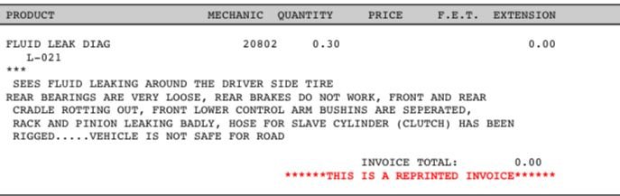

What should I fix first to make my car “safe for the street”
So I had a mechanic check out my car and he says it not safe for the road, I really don’t wanna sell this car, so what should I fix first and could you post a link to where I’d buy it?

Get the brakes sorted out first. You don't want to come to a stop the hard way. I'd question why the rears "don't work", and have the entire braking system looked over. Wheel bearings next, although if they're that bad then they should be replaced along with the brake repairs. You need to figure out the reason things aren't working before you can start buying parts.
edit: those control arm bushings should also be replaced before it goes back on the road.

Every one of those items is critical for a safe vehicle, either fix them all or sell the car as is.
It sounds like you're going to be paying a shop for repairs, you're probably looking at a several thousand dollar bill.
​​​​​​If this is a financial issue then you have only a few options.
-Learn to perform your own mechanical repairs to save money by not paying $100/hr shop rate. Yes this takes practice but watching videos and reading the shop manual helps.
​​​-Generate more income to cover costly repairs, this may or may not be feasible so I'm hesitant to even suggest it.
-Sell the car and buy something that's not a luxury sports car. Luxury = expensive maintenance, sports car = expensive maintenance combat me the two and it's VERY costly to maintain unless you do your own work. Buy a Honda civic/accord or a Toyota Corolla/Camry. They are MUCH cheaper to maintain.

Get a second opinion, they might be pulling your chain. If the mechanic is telling the truth then it all needs to be fixed - brakes first, then tires, bearings, 'cradles' (spring perch?), power steering, control arms.
