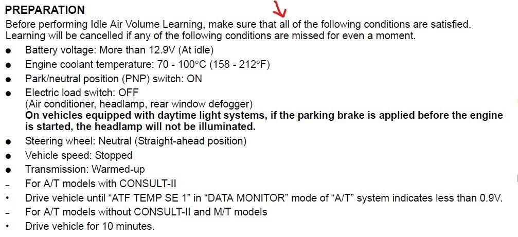

so today i cleaned my k&n air filter and oiled it, cleaned the throttle body, and replaced the stock intake resonator with just a straight silicone tube, i hooked everything back up and did all of the idle relearn procedures about 5 times and the idle stays around 1200, and i turn the ac on and it goes to about 1350 or 1400. i’ve seen a few posts saying that after about 2k miles it will kinda learn itself but i don’t want to do any harm to my car and stuff and it’s just so unsatisfying for the idle to be that high. should i just let it do it’s own thing or what, i’ve heard that as long as the check engine light doesn’t turn on it’s fine but 🤷‍♂️

Idle Air Recalibration, it won't work unless ALL SYSTEMS ARE READY. Here's a snippet from the FSM for those required conditions.
