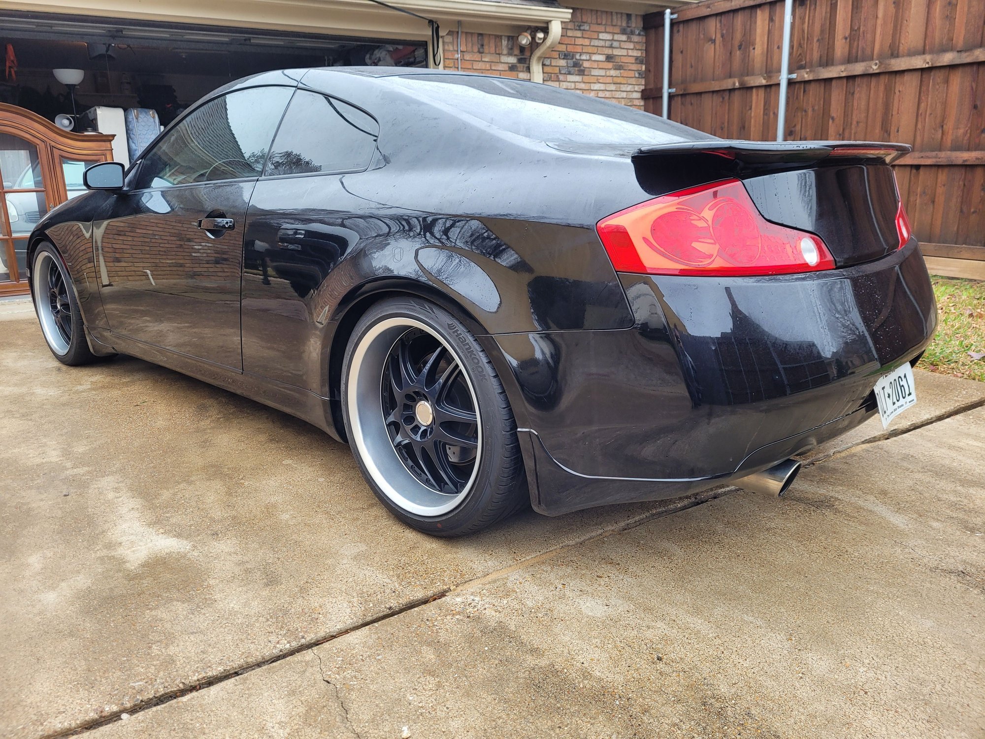

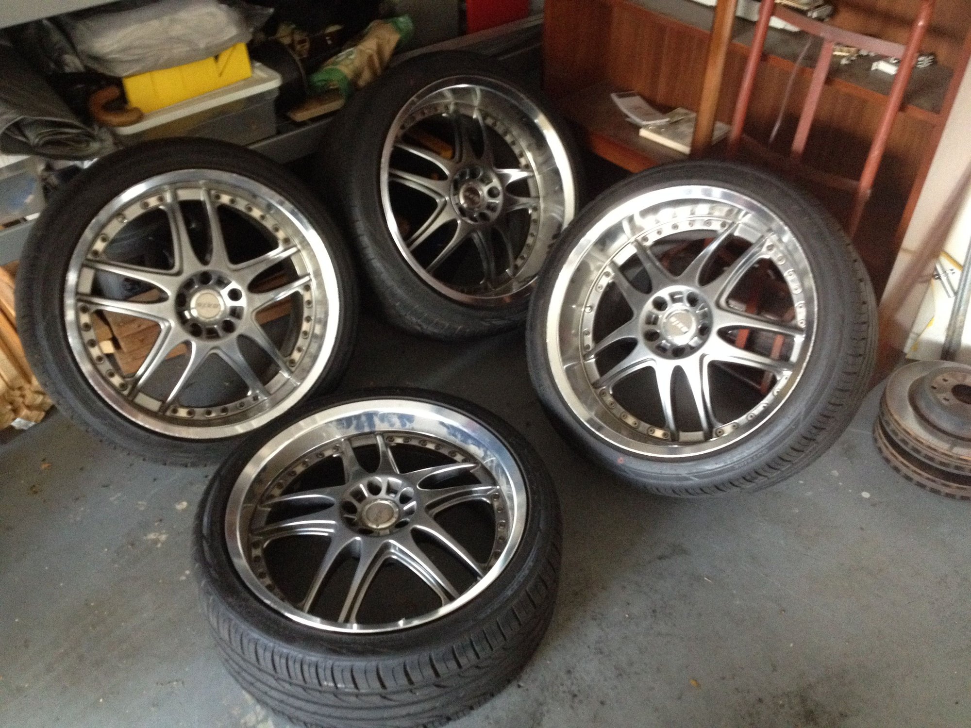

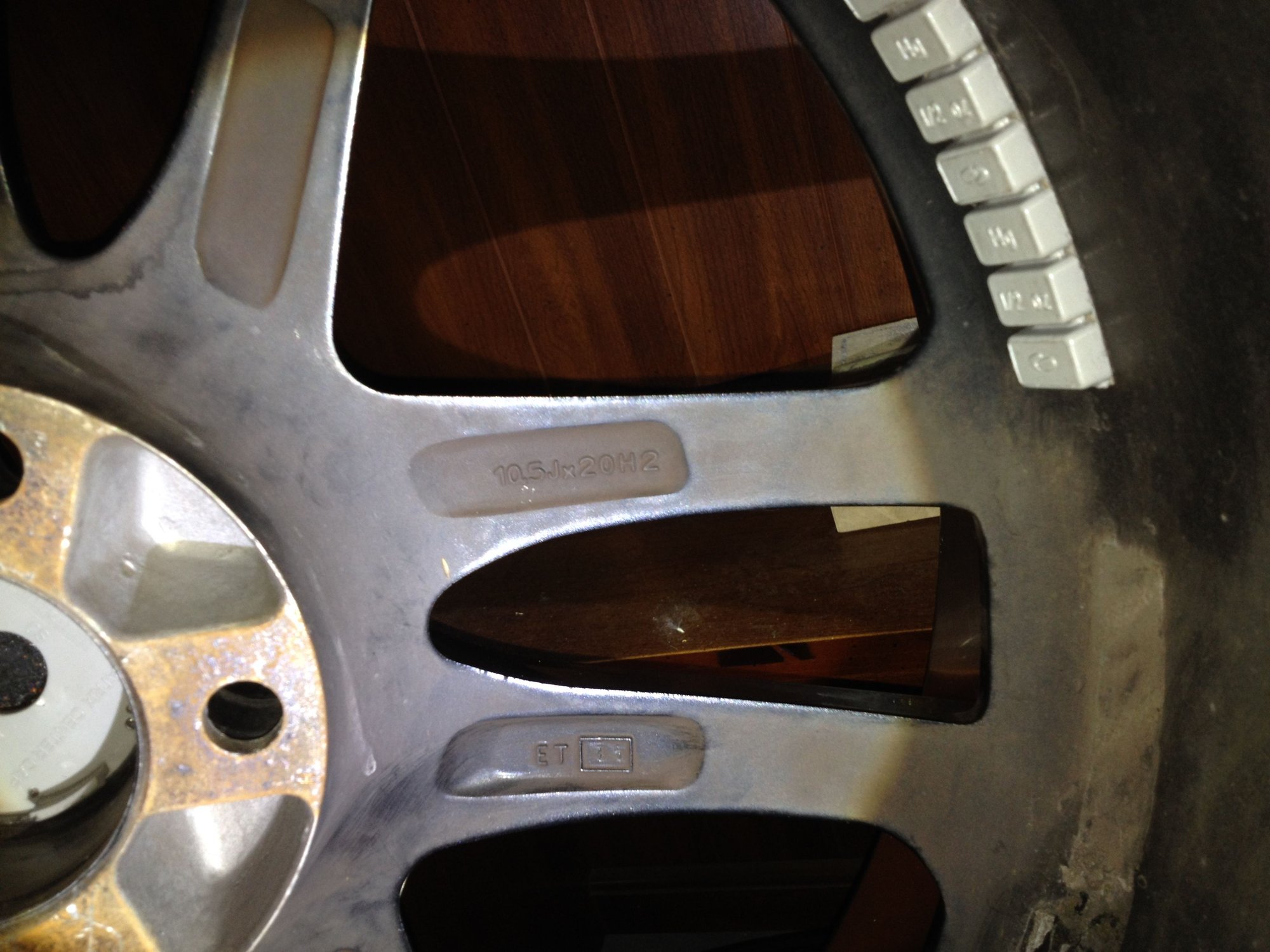

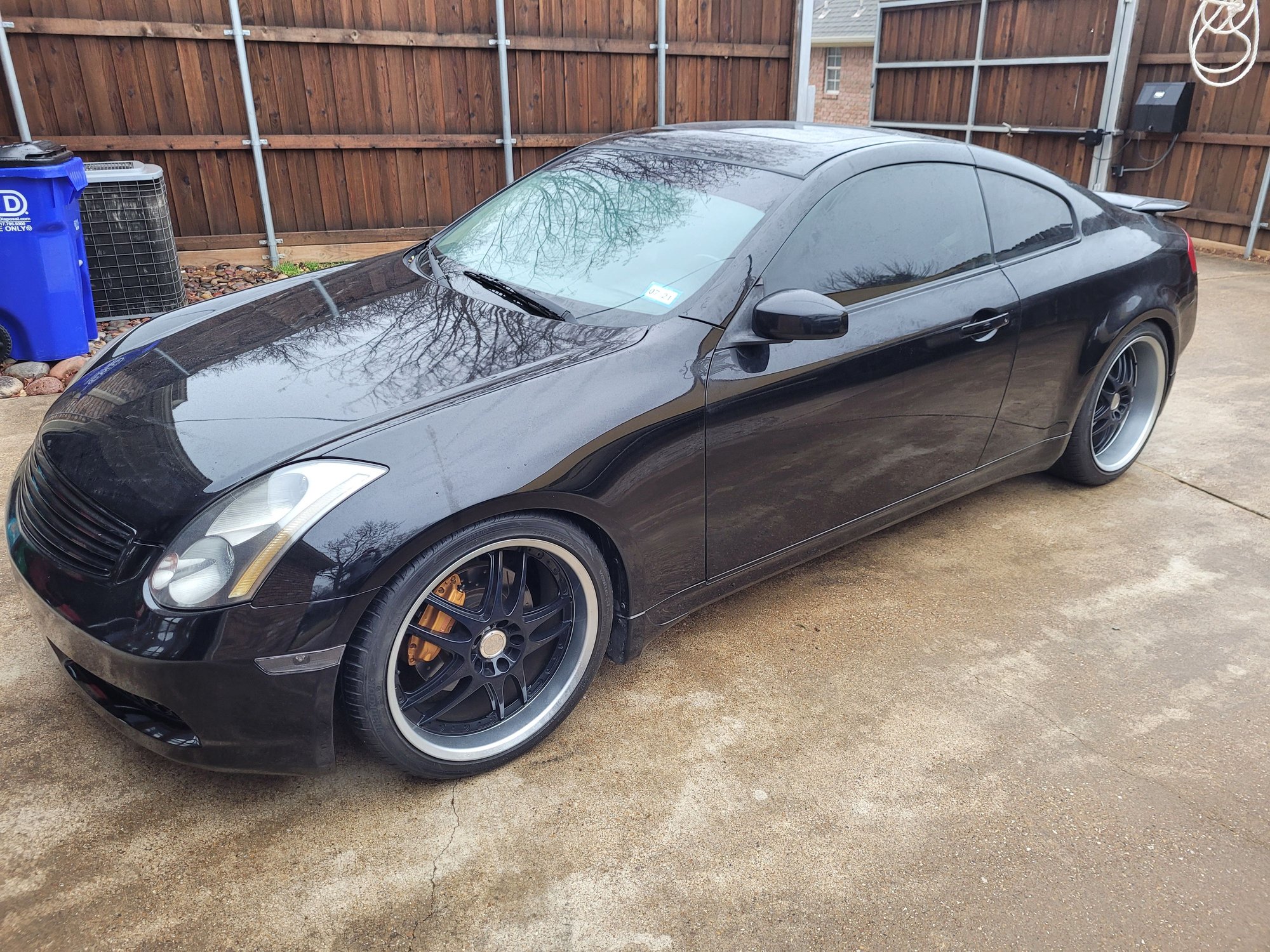

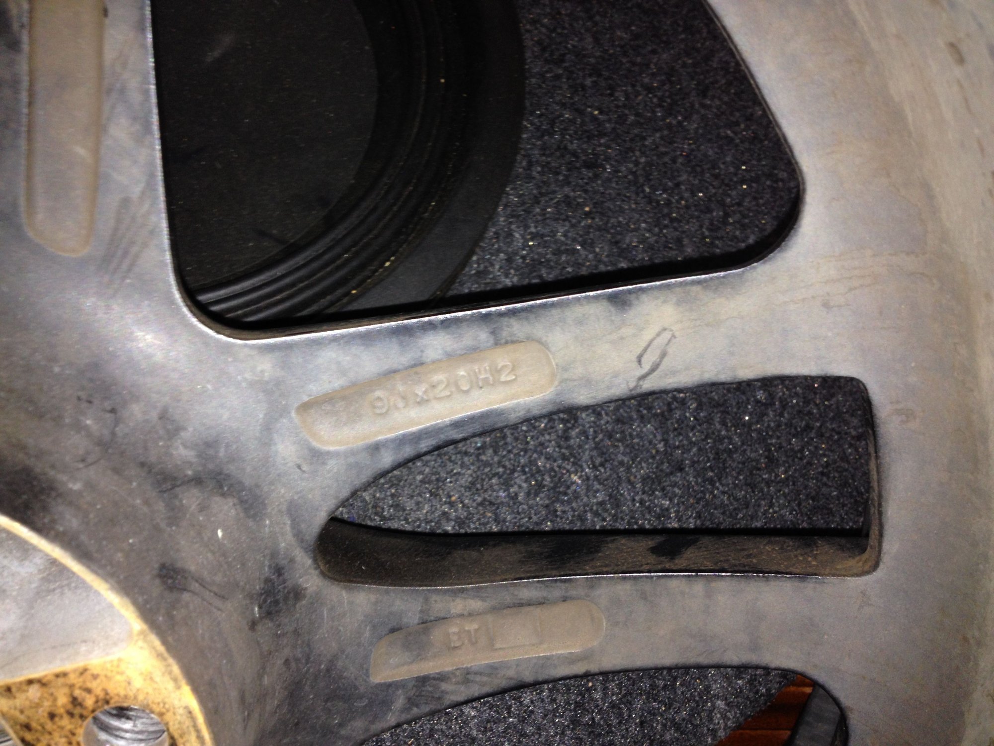

I know there is plenty of information around the fitment of wheels for this car but its a little scarce on 20" rims. I like the fitment of the wheels that came on my car, i drifted into a curb years ago and got one wheel repaired because they are discontinued. The people i used to repair the wheels were referred to me and they lost the hardware while repainting all the wheels and its still had a slight imbalance ever since then. My tires are bad so ive determined to get a whole new set, I want the exact same fitment that these wheels have but i have only found one source (https://nicedayz.net/post/1253) that has what i believe is my exact wheels. Front is 20x9 with 255/35/20 tires and the rear is 20x10.5 with 275/35/20 tires (that should be 285/35/20 but i bought the wrong tires many years ago). The post linked has spacers that is confusing me but i believe the offset for the front is +25mm with a rear of +30mm. Im going for a flush look, my car is lowered less than a inch and my current setup does not rub which is why i am looking for the exact same setup. Searching on the internet ive found other setups that are close (https://www.fitmentindustries.com/wh...wering-springs) but nothing exactly like what im running. Im having a hard time finding wheels with the exact fitment as i described, so im thinking about trying something different but i dont want to get wheels that do not not fit how i like it. If anyone is running what i have described or has some insight i would like to hear it.
