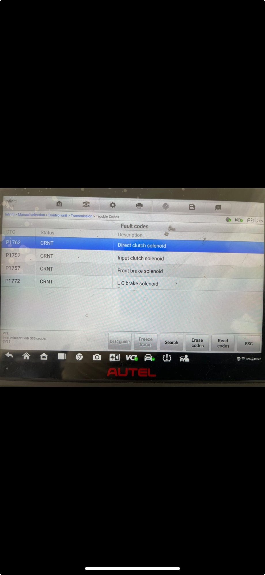

I just bought a 2003 g35 coupe a few weeks back from a private owner. The one problem I was told was the leak from the valve gasket but I should have definitely did more research. The vehicle had been sitting in the garage for atleast 6 months. I wasn’t told about the trans having issues and didn’t begin to notice it until about a week or 2 back when the engine light came on and the car would rev when I press the gas without any movement. I went to a mechanic I was referred to that specializes in Gs and 350zs and he let me know there were more problems than I had thought. He fixed the wiring in the fuse box next to the pedals, replaced valve gaskets, and showed some codes for the trans. Unfortunately, the coupe takes a 3 plug transmission and it is extremely difficult to find. I got 2 options from this diagnostic. Pay $1200 for the mech to put in a 3 plug he had lying around in his shop w 79k mileage or find a newish trans and have him install that one? Yet, I can’t seem to find any 3-plugs online only 1plug trans. What should I do?

Codes that were brought up. This is the third mech I went to in regards to this and they all had similar codes.

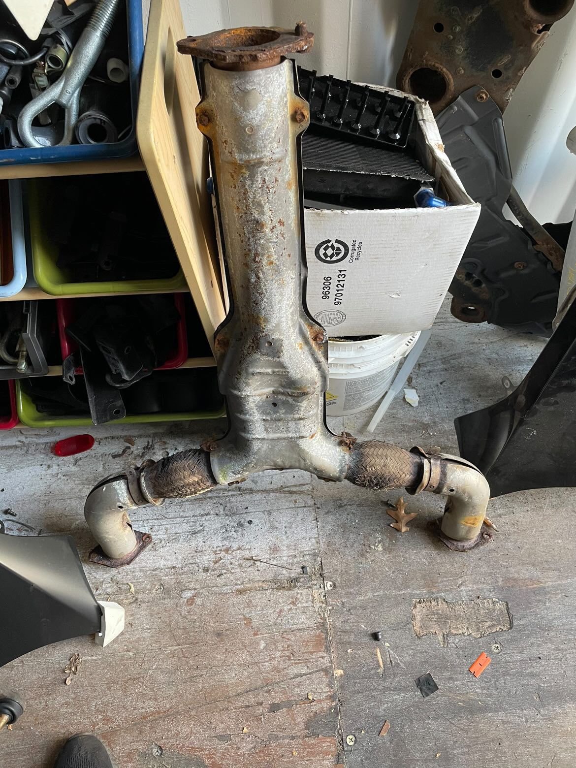

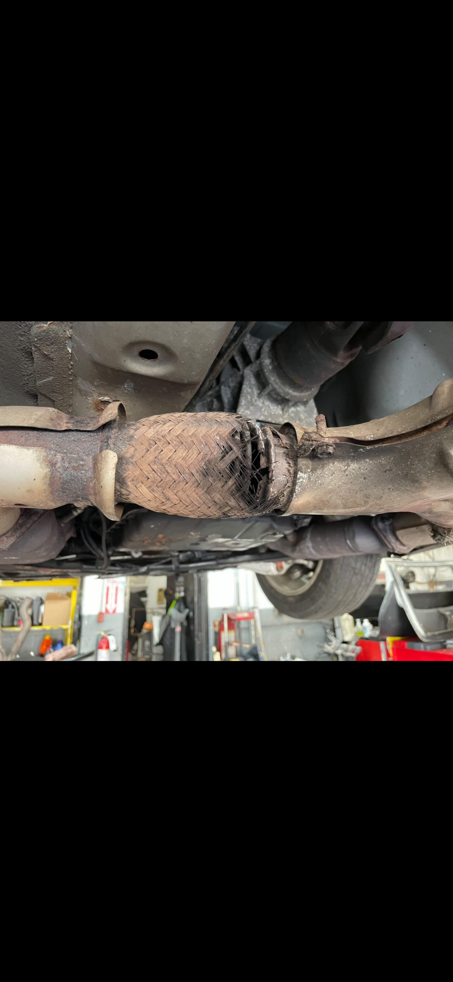

Y exhaust pipe is damaged due to speed bumps most likely. Told me $200 to replace with a used one he had sitting around
This is the replacement. Should I just go to an exhaust guy and have them do it with a newer exhaust

So the image with the codes is from the mech who specializes in 350z and Gs. He grilled me a bit worse than you did about buying this without proper preparation but did say that whatever plans I have with this car he would help me get the car to that standard or better. It’ll be a pretty penny but damn I just love Gs (modified or not)
