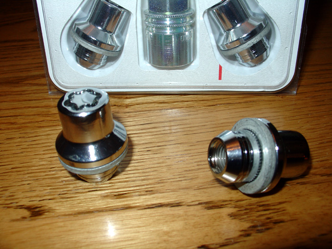

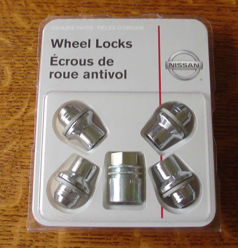

You expressed a concern with the way the studs stick out of the rim. Did you get the different lug nuts that come with the 07 wheels. You must use the 07 lug nuts with these wheels. They are much different than the 1st gen (03-06) sedan lug nuts. The offset has no affect on how far the studs stick out, it is because the wheel is a different design and requires the new style lug nuts.
I don't have a pic of the lug nut handy but here is a pic of the 07 wheel locks which shows how they fit inside the rim and incorporate a washer.
