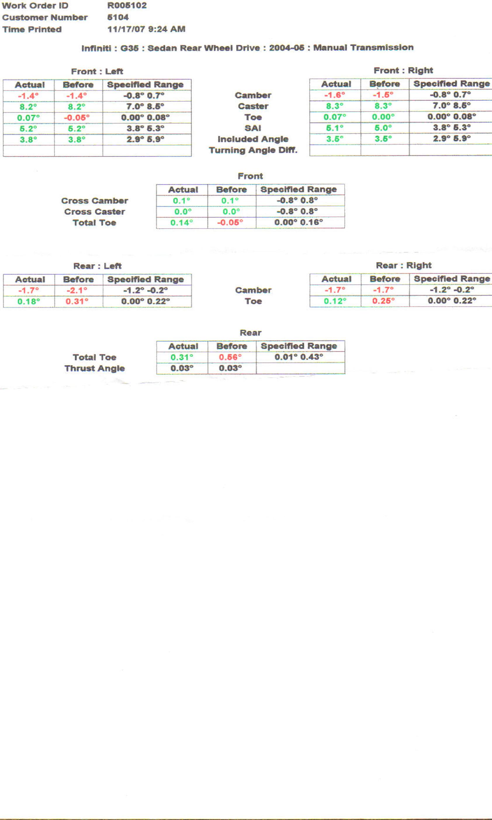

I lowered my 05 about a month ago with H&R 1.2 1.3 springs I finally brought it in for alignment. I took it to Les Schwab a tire store chain out here in the west and they put it on there rack. The toe is now good but the camber is unchanged and actually worse on the right front. I have searched this before and I thought they could get the car somewhat closer to specs but I was surprise3d they could not change it at all. Whats the deal? Should I just buy the camber kits and quit whinning?

front camber cannot be adjusted at all in the front...if you really want you could get the alignment done to the specs of the coupe. thats what i have done with mine.

Nov 17, 2007 | 08:11 PM
the stupid place said they couldn't change either camber specs at all

Quote: front camber cannot be adjusted at all in the front...if you really want you could get the alignment done to the specs of the coupe. thats what i have done with mine.
I agree with adjusting to coupe specs, I had mine done that way too.
Looking at the readout, however, only the right rear is within even coupe specs.
Our cars do not have any camber adjustments in the front, and only minor camber adjustments it the rear. This is why I replaced the front upper A-arms and added a camber kit in the rear too when I lowered my car. This enabled me to correctly align the car.
