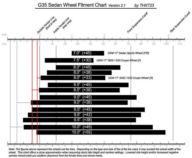

would those offsets fit a sedan???
18x8.5 +32
18x9.5 +30

fronts should be ok...rears would definately need lipping of guards, stretched tyres, lowering and camber dialled in.
Use the attached as a guide...I have added the red lines to signify the wheel fitment for 350z track wheels 18x8 +30 and 18x8.5 +33 which a lot of members on here are running without any mods or rubbing..

yes, it will fit. Only after you do a wide body kit.

Widebody not neccessary...chk out this guy who is running 19x10 +26 on the rears!
dont post if you know nothing about offsets..
OP... yes, those offsets will fit.
Here's what you need.
1) Atleast a 1.5" drop.
2) 225/45 tires in front a 245/40 or 255/40 tires in the rear.
3) Rolled fenders
4) -1.8 or more camber in the rear.
If you can do all 4 of the above then they will fit absolutely perfectly.
