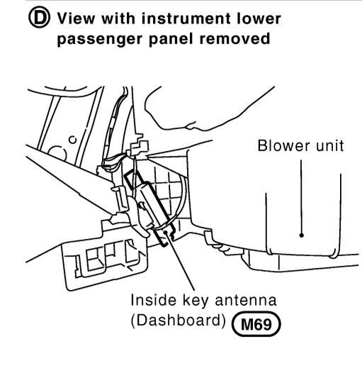

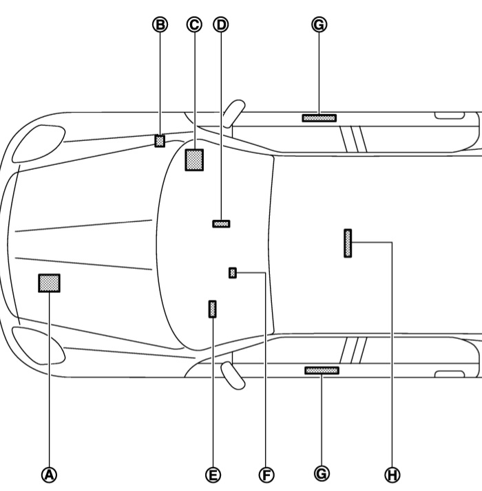

I would guess you may have accidently disconnected one of the internal antennae... Let me try to post a couple pics from the service manual... bear with me...

EXCELLENT! THANKS! I did mess with the center console to get the wires through there...to late for me right now to try it. But first thing tomorrow, I will.
I hope this is it, I think it makes sense that it could be...even if it isn't THANKS.

WOO HOO!...
I couldn't sleep and went out and found all of the antennas you posted......
It was the rear center console one. (unplugged...you had to pull it completely up and then look underneath halfway up towards the front for a SECOND plug!) The Nav wires apparently didn't have anything to do with it, probably just the fact the other antennae were more "open" because I had the dash apart.
THANKS FOR ALL WHO RESPONDED AND HELPED! Thanks Skyline for the eventual answer!
