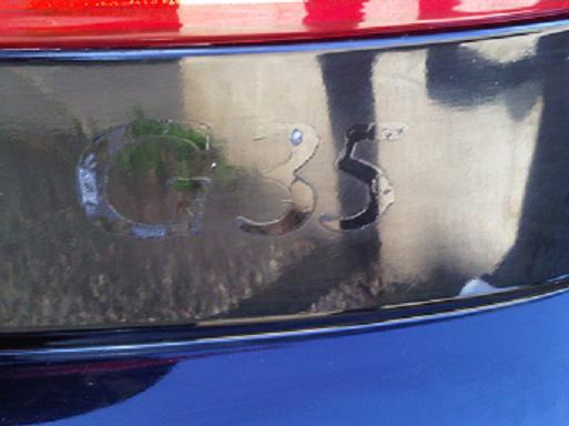

I know, this should be simple, heat + dental floss = debadged
Well, it was/is not that simple for me. I have one spot behind the 3 that chipped off and I cannot get the last bit of adheisive off the rest of the letter/numbers. You can still see the outline. Or, maybe my car was repainted/reclearcoated with the emblems on still? I cannot tell. I went so far as using extreme adhesive remover good off and still cannot get the outline to go away.
I think I have to re-badge. Then, if so, can I just buy more adheisive and use what I have? Anyone know where to buy it? Or do I just eat the $40 and buy new ones?
Pics to follow once I figure out how to resize.
Thanks

Pic

Yeah, that looks bad. A good round of serious polish (with a buffer) and then wax will help get rid of a lot but I doubt all of it. I still have a little on mine but I put my "Twin Turbo" emblem over it.

it looks like it was superglued to be honest with you.......LOL

Just go twin turbo like Tim did and buy the "Twin Turbo" emblem..problem solved!
I think the only way you are going to get it off is if you do like Tim suggested...some buffing. Goo Gone worked both times I did mine.

Try some Goo-gone and then claybar after.
If it still looks like crap.....go buy another "G35" emblem and put it back on

that doesnt look like the stock rubbery/sticky stuff they used at the factory.
honestly that looks like superglue as i mentioned before.

that looks identical to some household super glue....
Not OEM it is like G SEDAN said rubbery/sticky

just get the emblems painted gloss black then put double sided tape behind them and put em back on

Turtle wax bug and tar remover worked for me....try it
