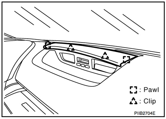

The "Cluster Lid Finisher Upper" is a pain. This is all the manual shows and with these instructions for removal:
"Pull to the backside, disconnect clips and pawls, and remove cluster lid finisher upper."
And to install?
"Install in the reverse order of removal."
D'OH!
I remember battling with mine but eventually something did click and it went flush again... Look closely and make sure the "pawls" are lining up right.
Good luck
