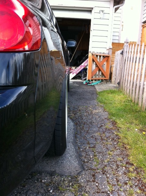

You will have to stretch the rear and run about 3 degrees of camber to make it look good. Probably something along the lines of 255/35/19 rear and 225/40/19 front will give you the same overall diameter and similar stretch.
Just for reference here is a pic of my rear wheel. 20x10 +25 with 255/35/20 sitting at 2.9 degree of camber. (10.5 +30 will sit out 1mm more)
I pulled my fender slightly and rolled them flat.
