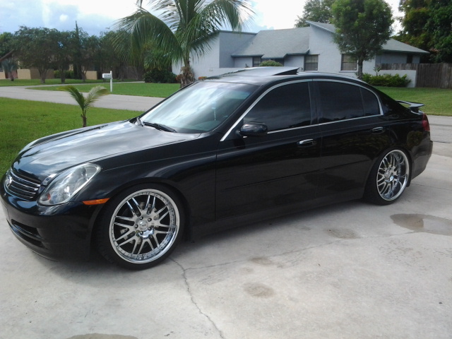

allot of camber .. n really small tires..
best bet go with 40mm offset and work with spacers.
i dnt think 40mm offset isnt that bad
i just recently did mine
20x8.5 n 20x10 40mm
dropped wit teins basic.. not really sure how low
