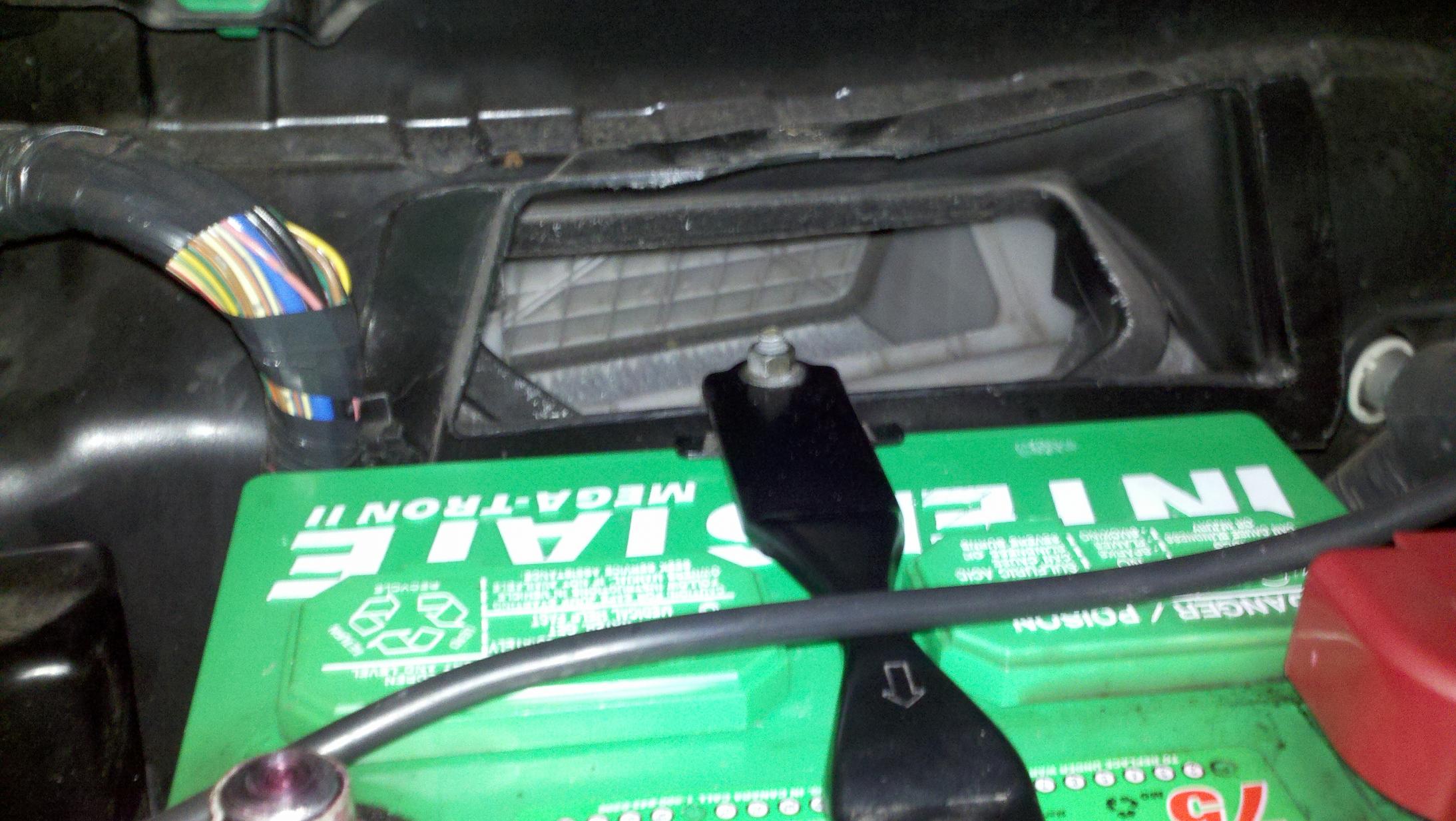

leaking on passenger front side when raining and car wash
is there a cover on this hole right next to the battery?..trying to find the leak ..never had this promblem ..thanks
Attached Thumbnails leaking on passenger front side when raining and car wash-2011-11-13_10-14-46_351.jpg

umm is the "hole" your talking about the big rectangle right behind the battery? If so thats your cabin filter, and no, there is no cover for that. As far as the leak goes, did you check the all the weather stripping around the hood?

No there is no cover for that, its for your AC
Also how about you actually tell us where the leak is, this post is useless as heck right now.

Remove the pass side windshield wiper cowl. You should see a spot where the engine harness wires go into the pass side firewall. There is a rubber gromet which seals that opening and it could be leaking. I cut a larger hole in my gromet to run power wire for my amp and I haven't yet sealed it properly. When I wash the car or it rains a small puddle of water accumulates on my rubber floor mats.

psycobusa..Thanks on the info and i think you are 100% right!!..now i need a new cowl ..anybody know the part number so i can by online?..thanks!!
