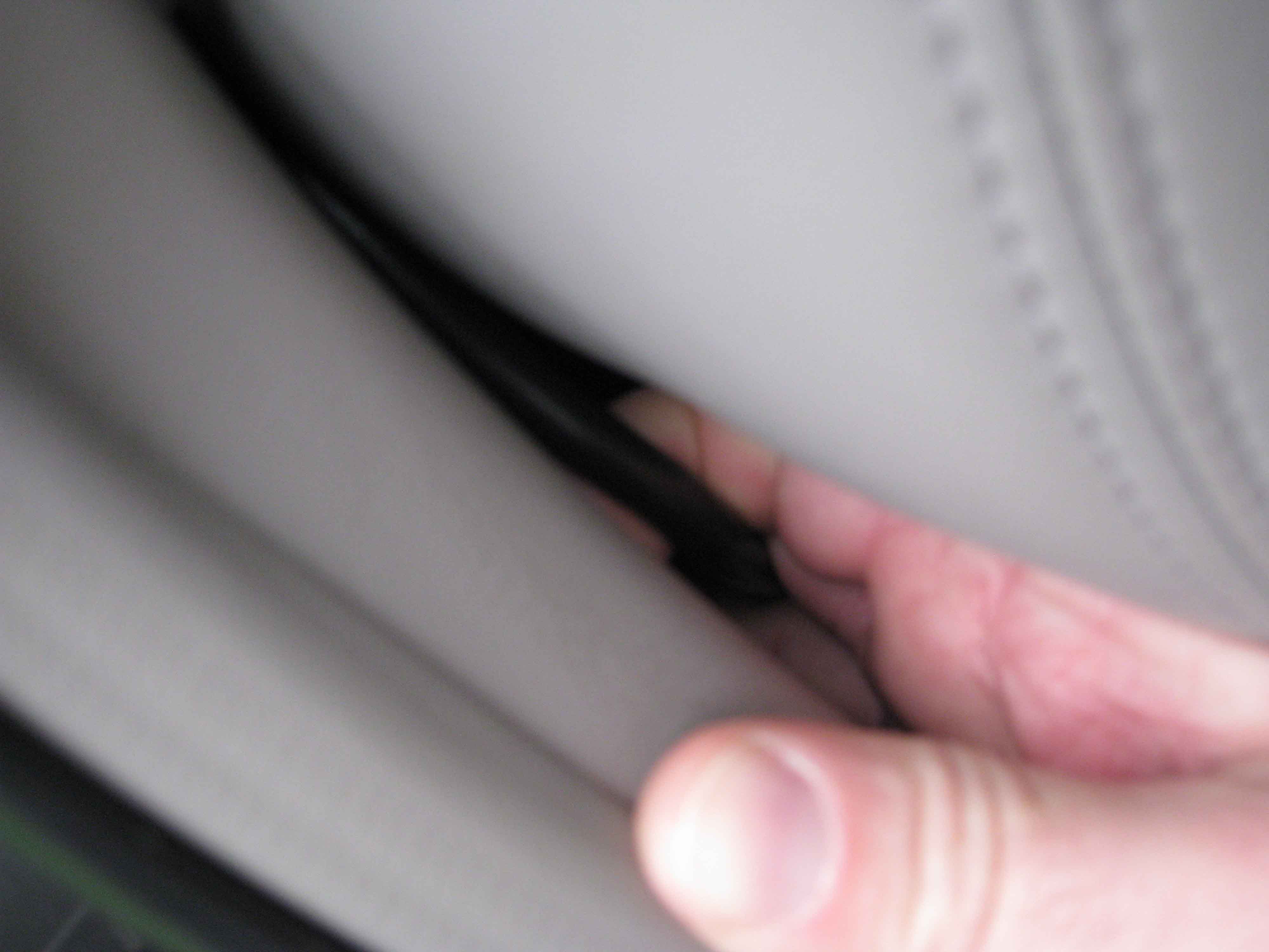

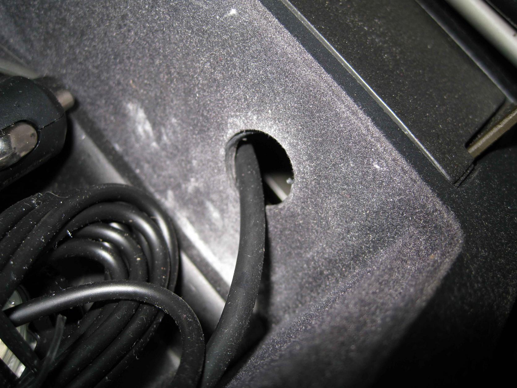

I have an 06 G35X and did this exact install (although it's been over a year)-all the cars are prewired for sat after like 2004 or something and it's on the passenger side of the trunk toward the front corner. Once you get the carpet pulled back you shouldn't be able to miss it. I ended up feeding the ipod module connector wire (the long wire) up through the seat back on the passenger side, and then under the seat deck to the middle of the car, then under the carpet along the middle hump in the back and up underneath the center armrest. Put the module under the armrest (I stuck a bunch of foam around it so it wouldn't rattle at all, and make a hole for the ipod wire and it looks like it came like that from the factory. It's worked perfectly ever since (again over a year) and the sound is great.

Pictures of armrest install (also put them in my garage album with descriptions):
Attached Thumbnails have PTY/CAT button, no SAT wiring in trunk, can i still use pa15-infi?-img_3095_edited-1.jpg   have PTY/CAT button, no SAT wiring in trunk, can i still use pa15-infi?-img_3096_edited-1.jpg   have PTY/CAT button, no SAT wiring in trunk, can i still use pa15-infi?-img_3100_edited-1.jpg   have PTY/CAT button, no SAT wiring in trunk, can i still use pa15-infi?-img_3103_edited-1.jpg   have PTY/CAT button, no SAT wiring in trunk, can i still use pa15-infi?-img_3102_edited-1.jpg

wow thanks for all your help man, those pics really helped!
