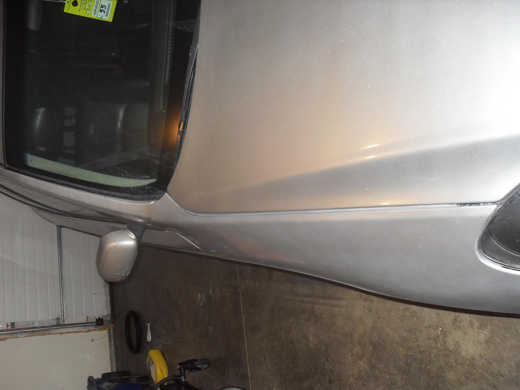

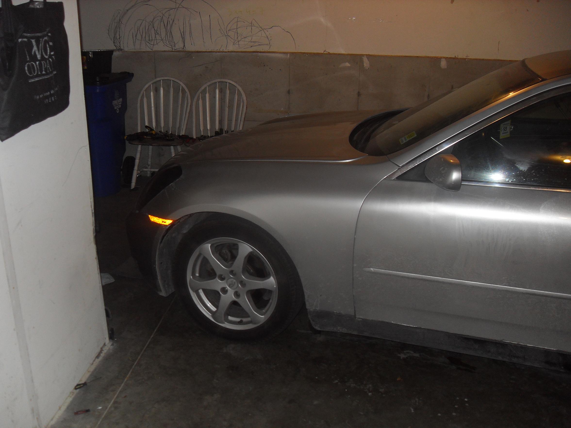

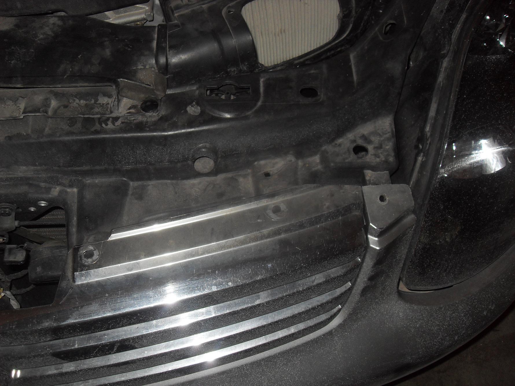

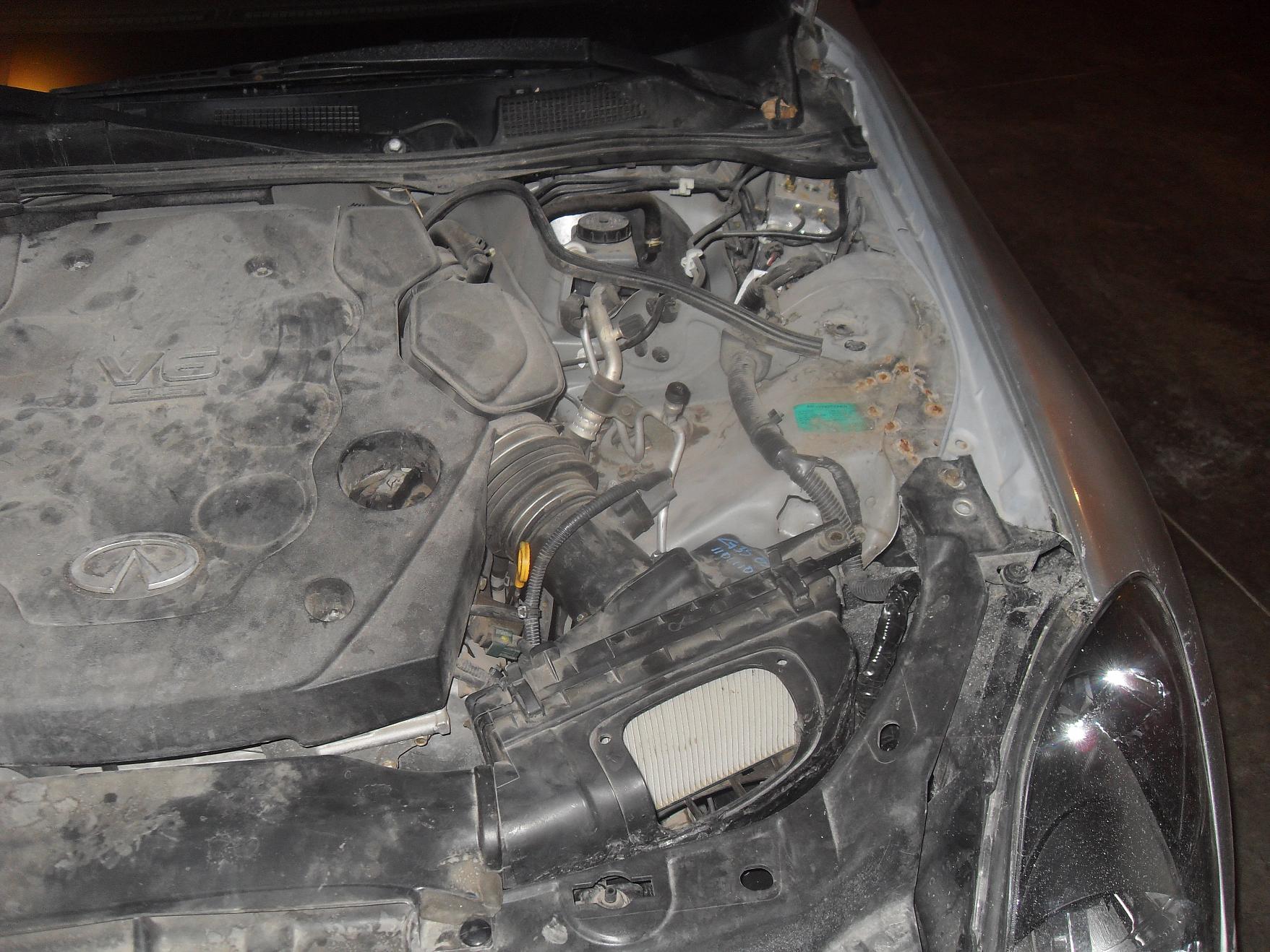

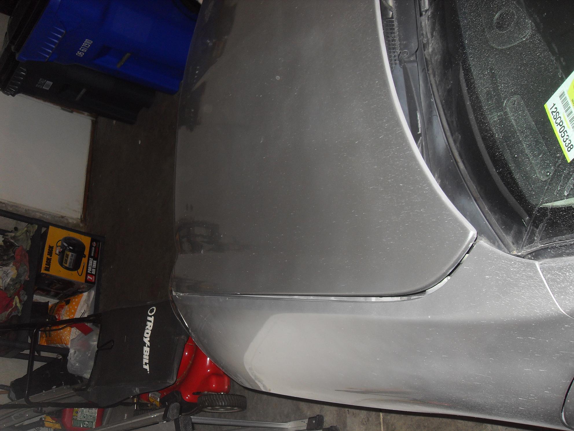

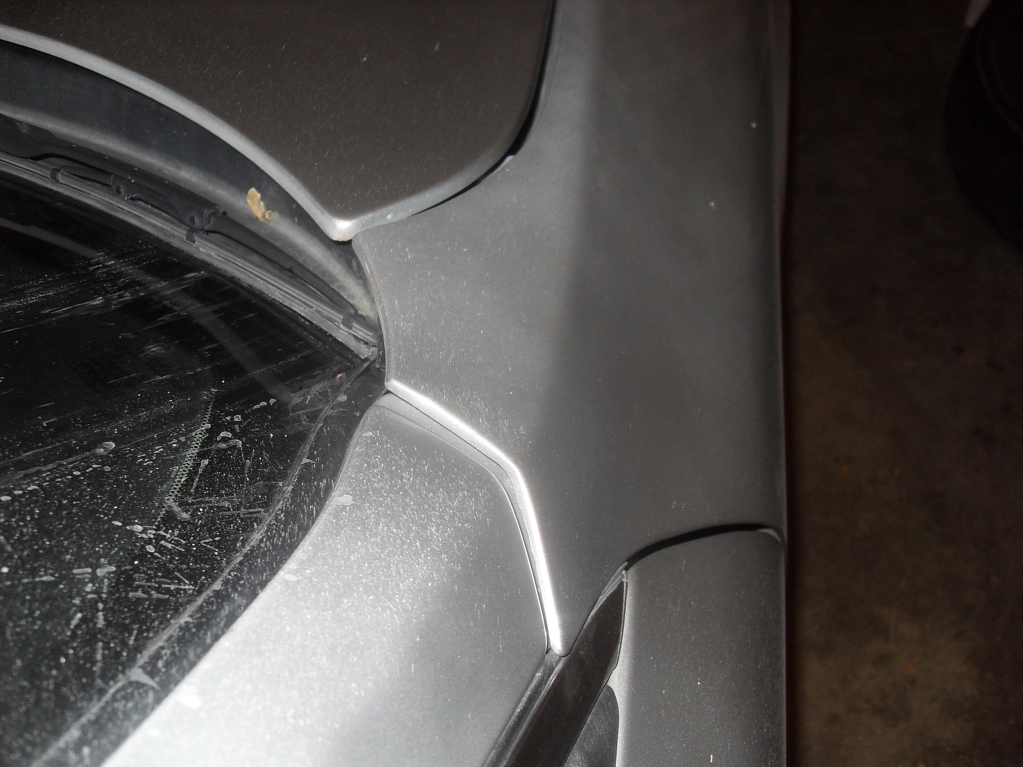

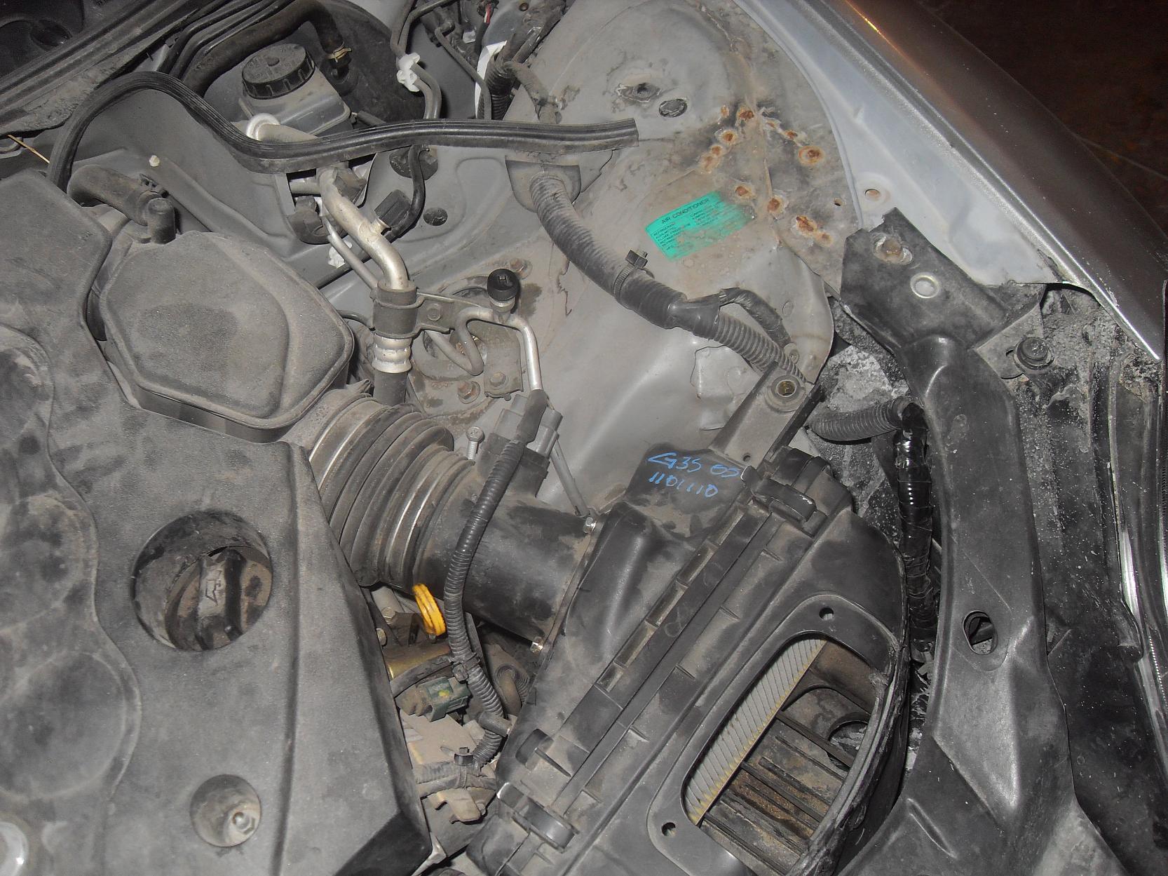

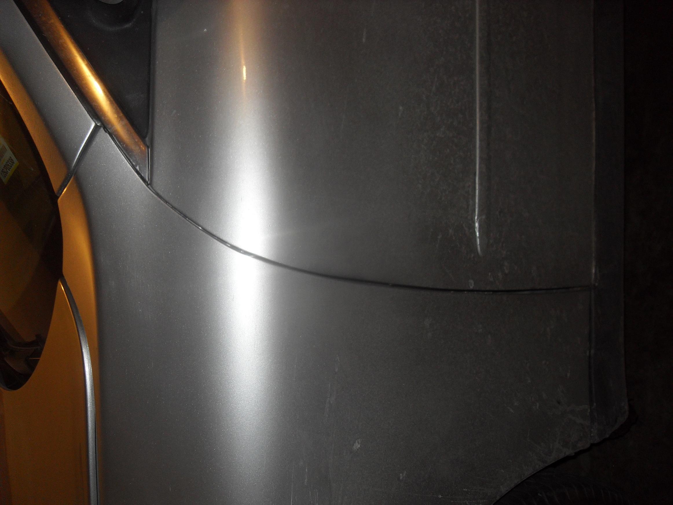

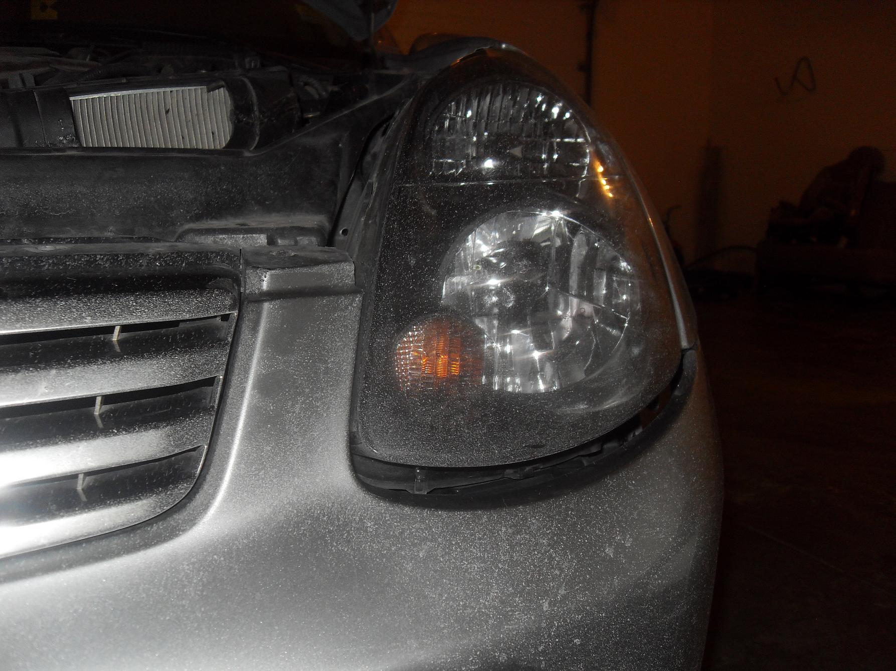

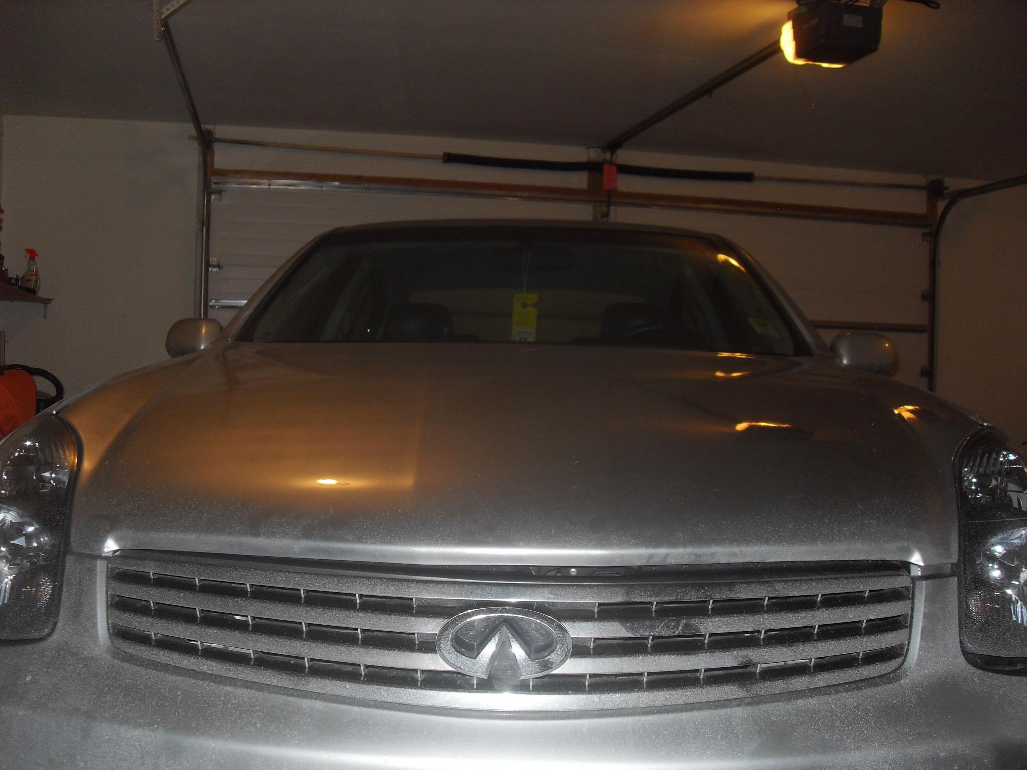

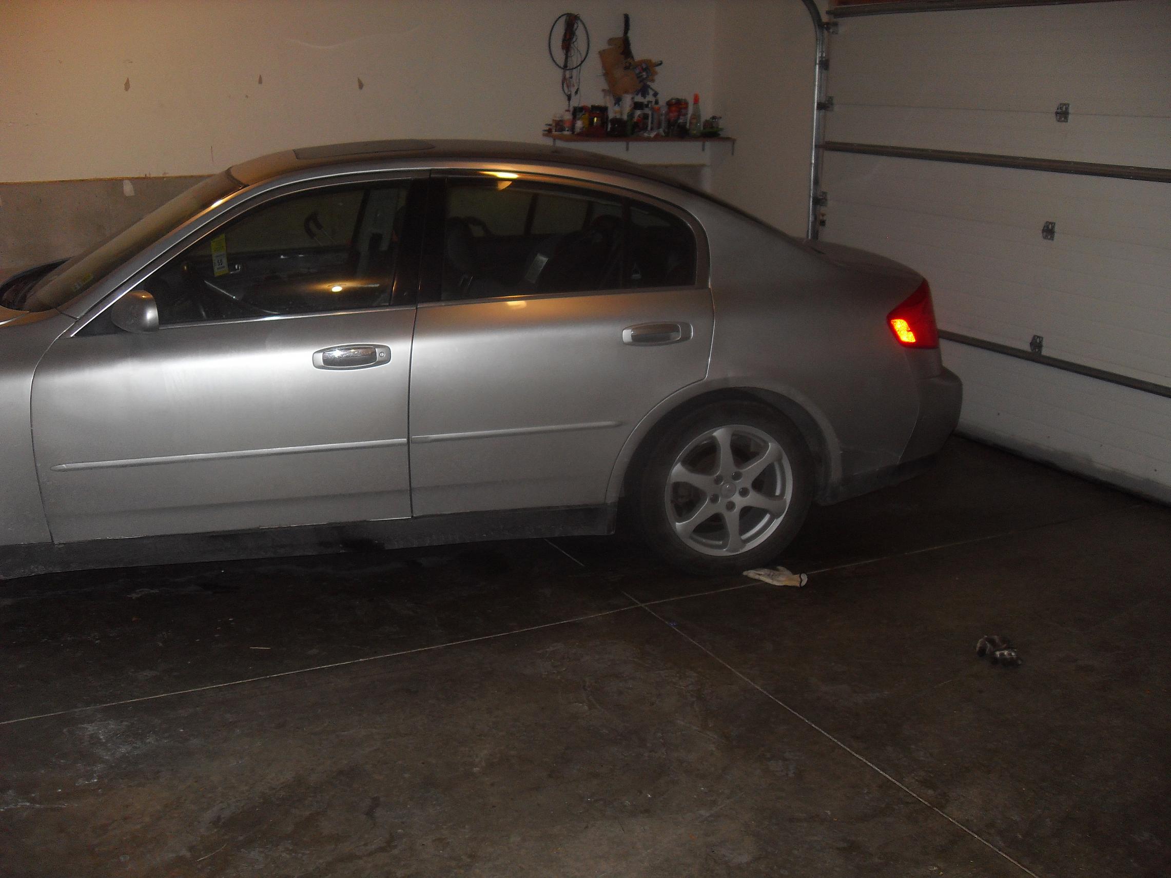

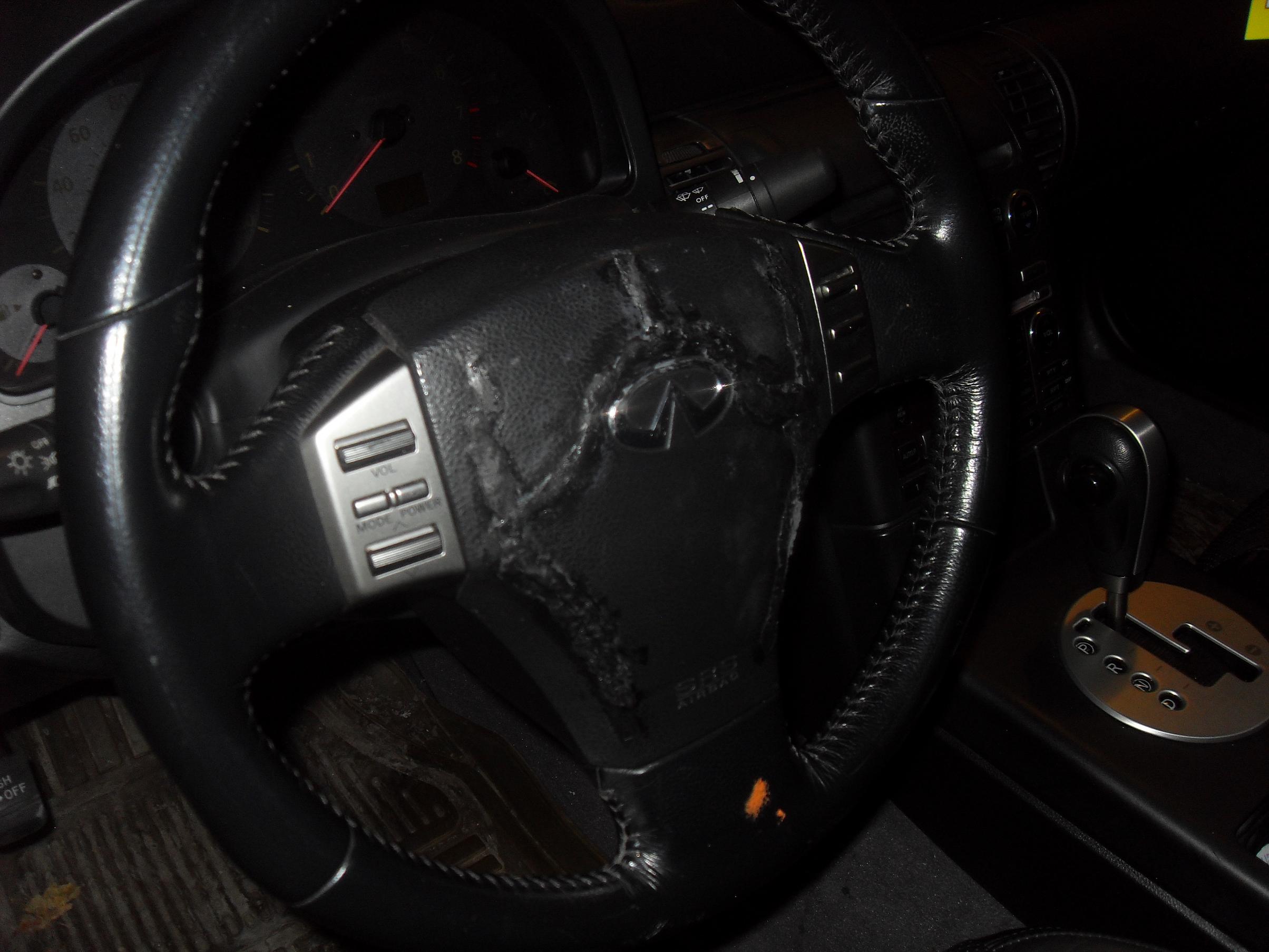

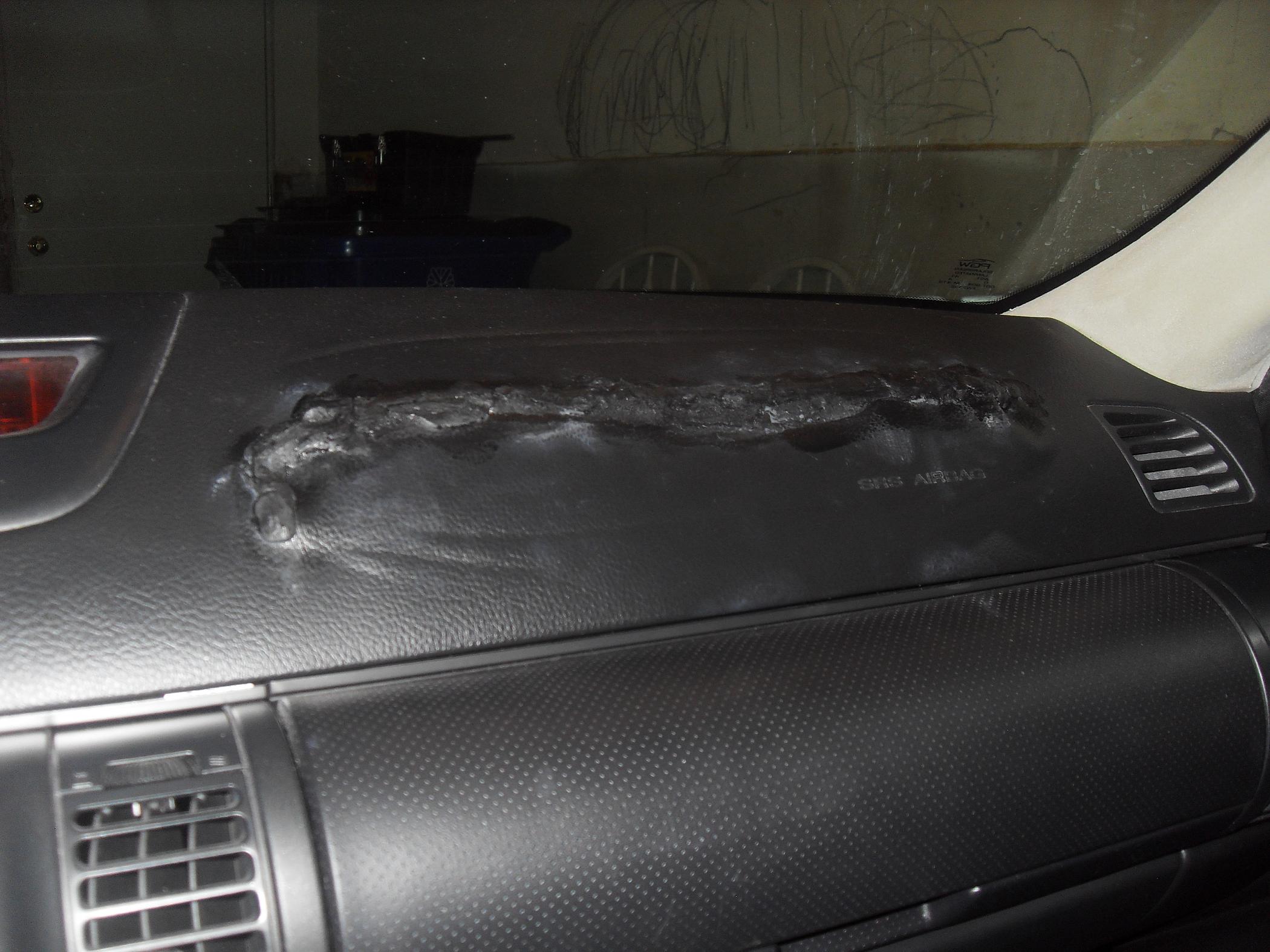

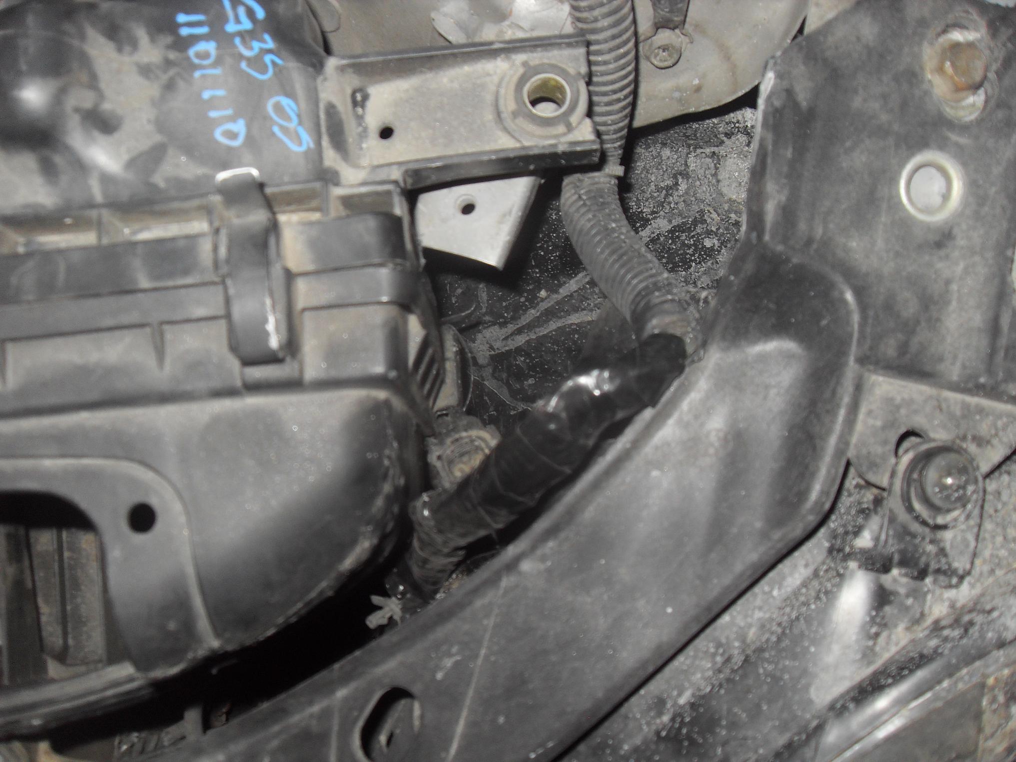

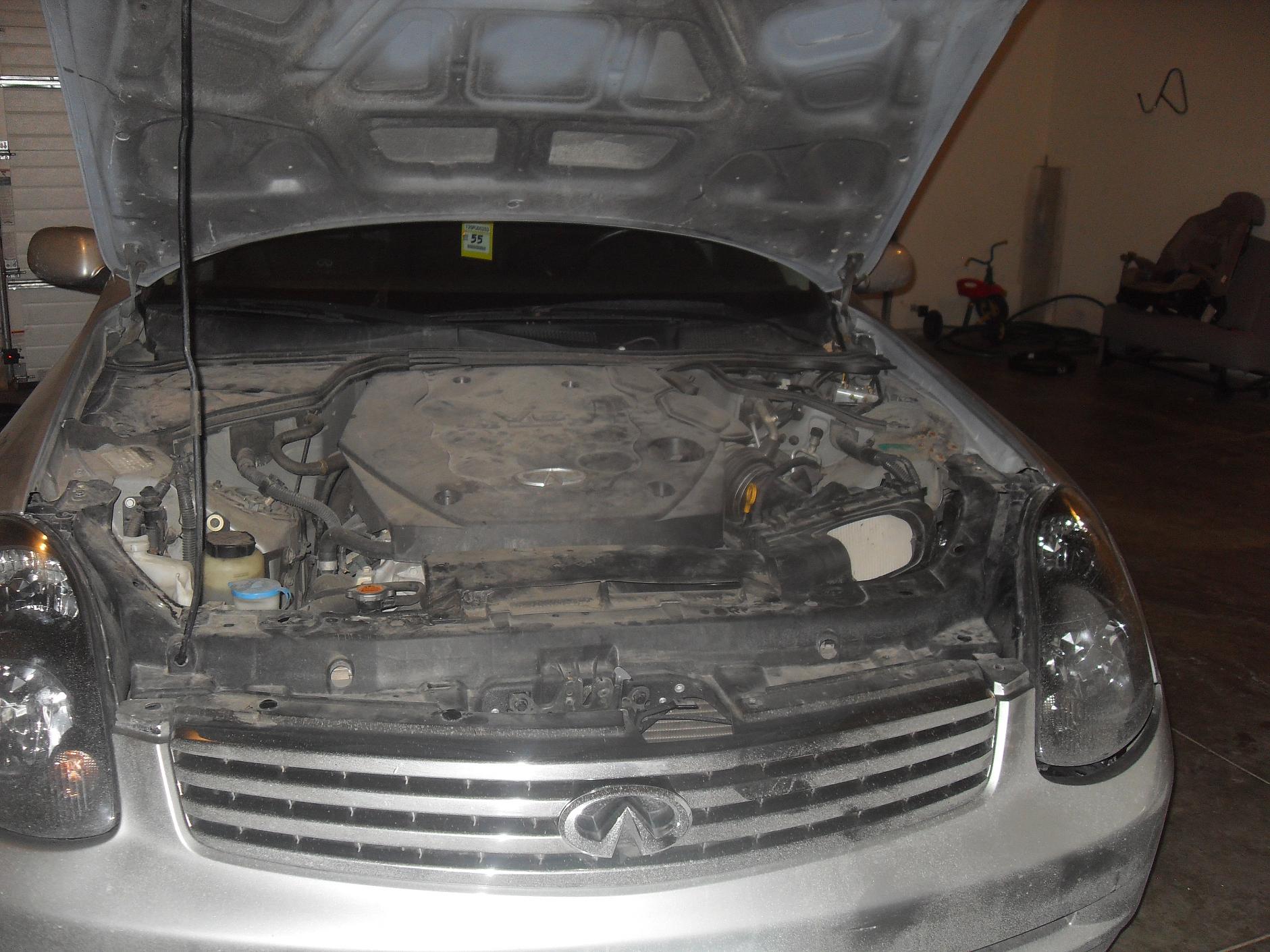

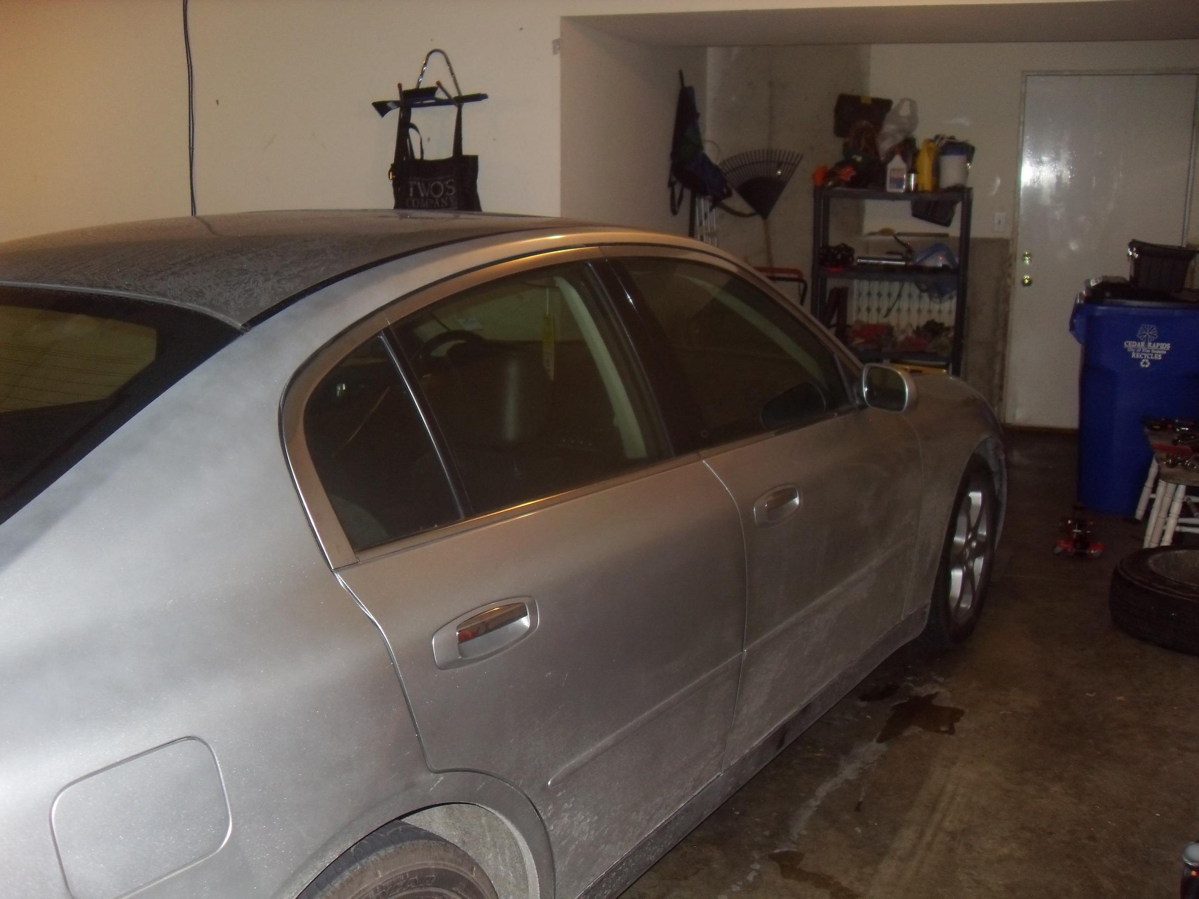

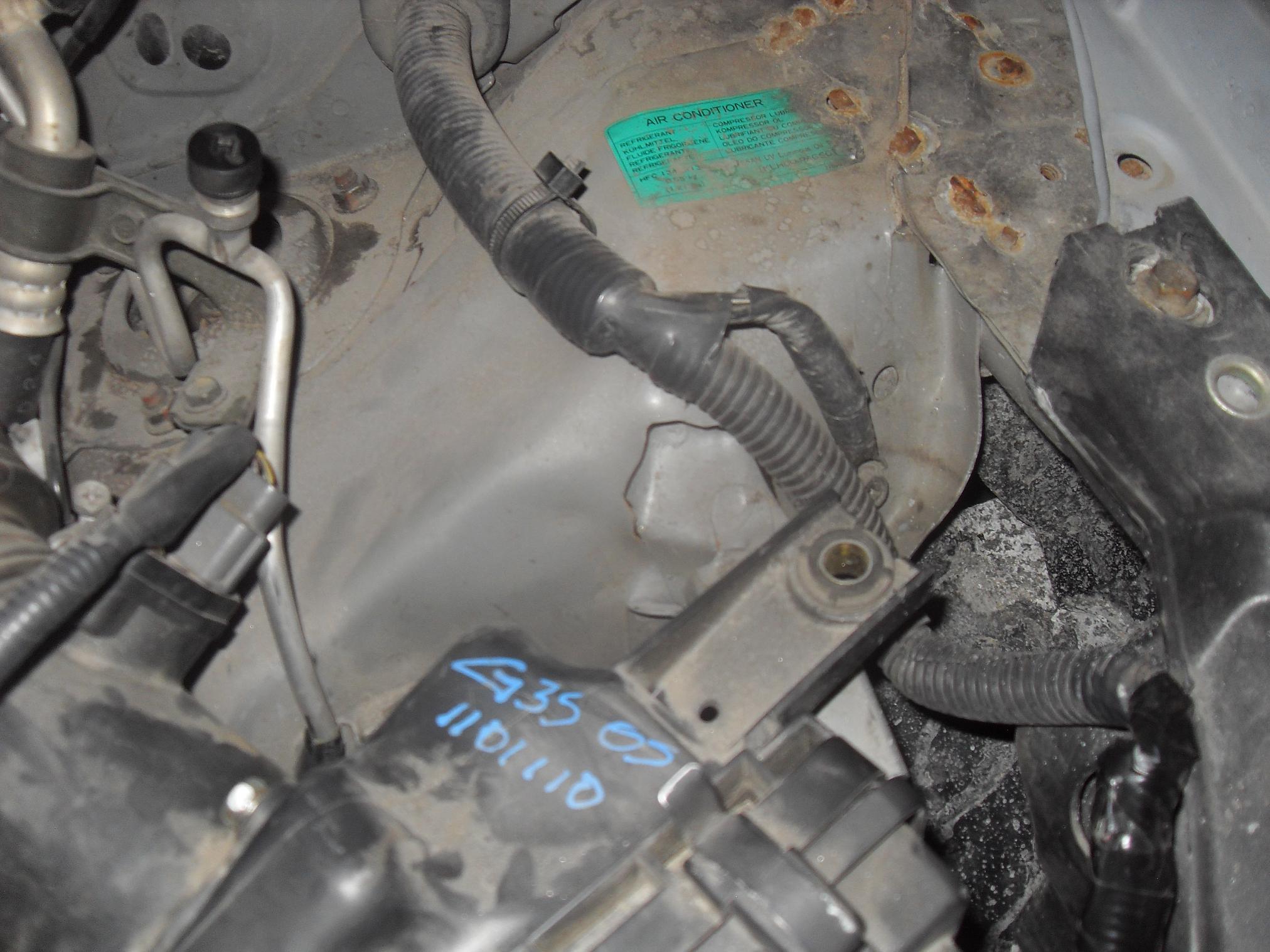

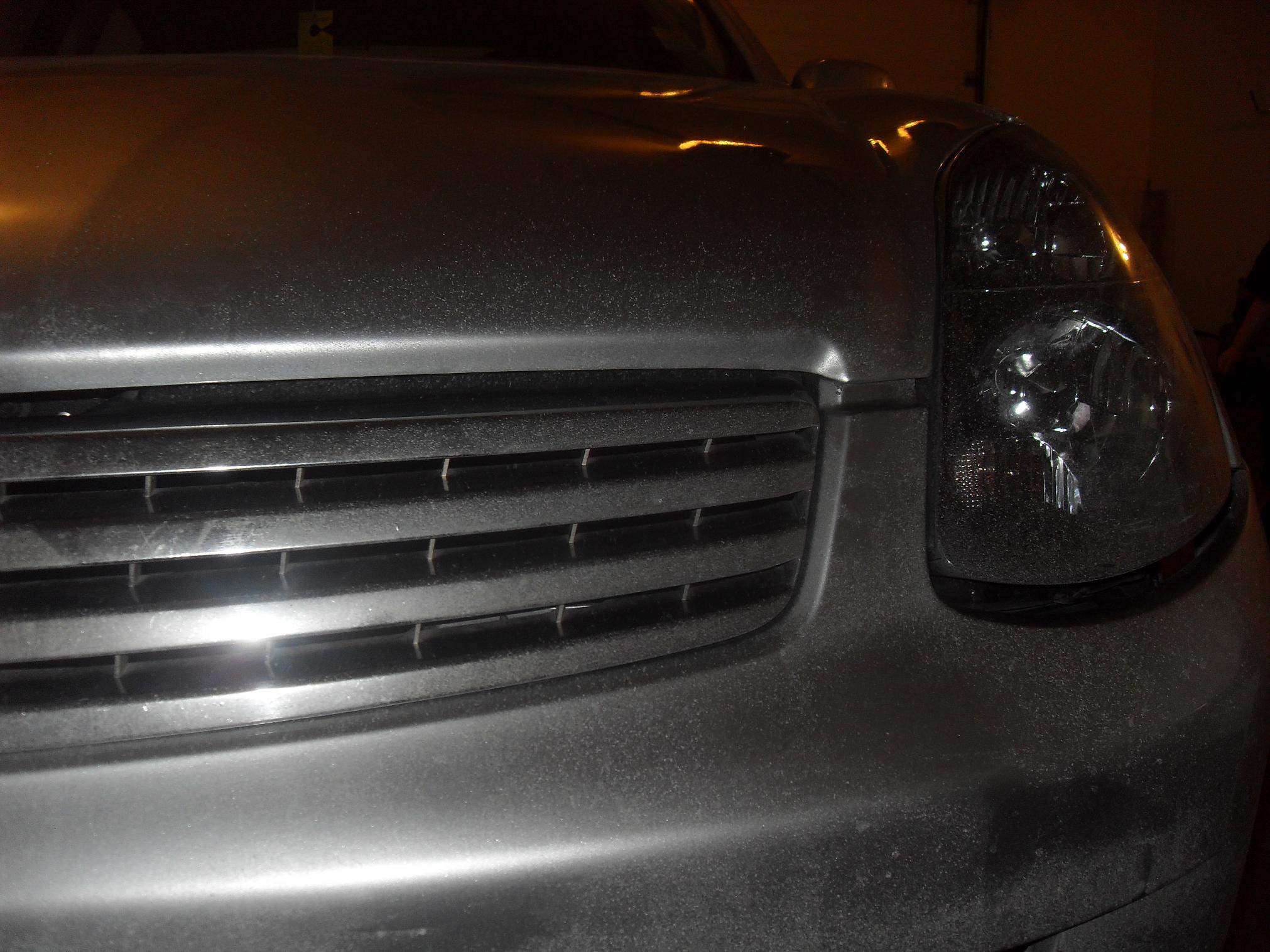

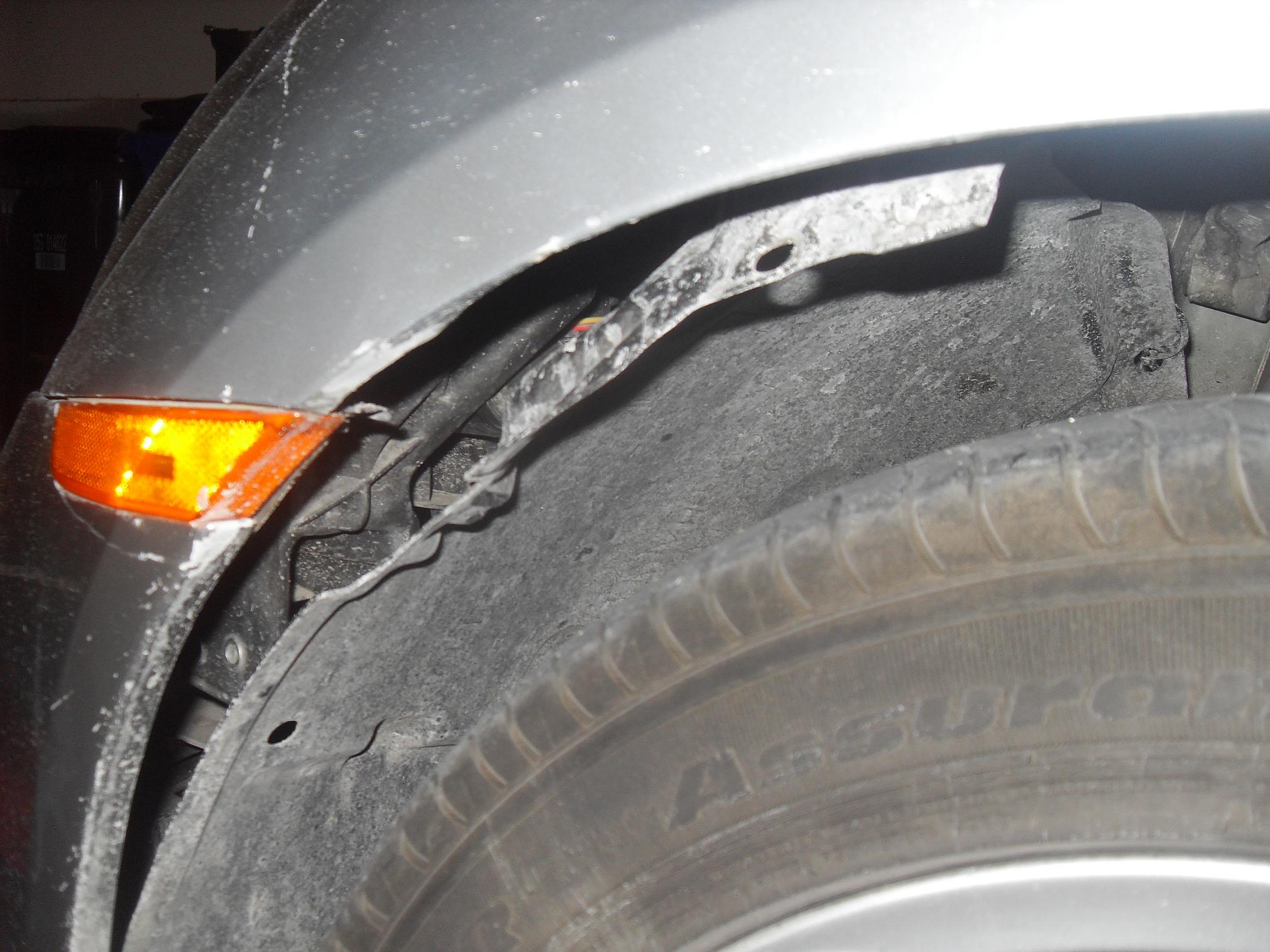

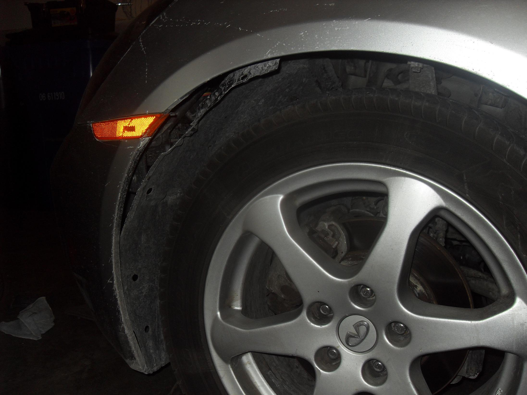

Here are some pic of the overall car, and the damage
Attached Thumbnails Some Help needed for a 1st timer-sdc19377.jpg   Some Help needed for a 1st timer-sdc19378.jpg   Some Help needed for a 1st timer-sdc19379.jpg   Some Help needed for a 1st timer-sdc19380.jpg
