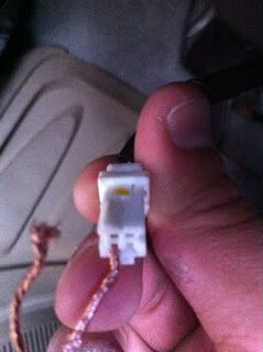

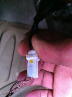

I did the exact procedure listed in the OP but it was a pain to find the TPMS reset plug.
It was nested in the wires all the way in the back and I had to use my iPhones LED (didn't have a flash light on hand) to spot it after looking for it for about 40 minutes.
Just to let everyone know my TPMS reset plug had a yellow dot on it so as to prevent people from grounding the wrong connection.
Here are some pics of the connector and exactly where to insert the grounding wire.
Forgive the ugly hands.
Thanks for saving me 100-150 bucks as thats what it would have cost me to reset the TPMS.
What made it extra special was that this was the first time I actually had the ***** to fiddle with my car.
Also the ( ! ) hasnt come back on eventhough the pressures are set at 34, 31 , 29 and 26 psi.
I guess I'll just refill the tires to 33 psi.
Super happy. Thanks again.
