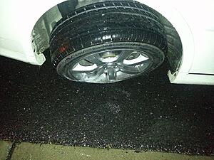

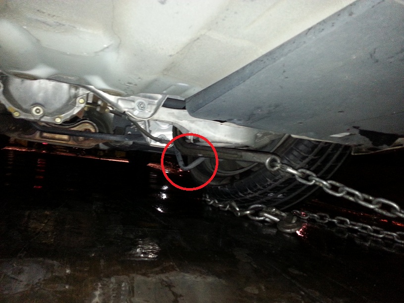

Purchased my 2005 G35 Sedan a few months ago and love the car. I have been following the forums but now I have a reason to post.
Before I get flamed... No I was NOT drifting, lol.
Fresh rain + wet oily leaves = spun into median. Gotta say though, solid car, didnt feel a bit of twist, no visible body damage, all the doors open and close nice and crisp.
I am insured so it will be taken care of, just curious as to the average cost of these repairs? Is there any damage I should be looking for? Any questions I should be asking the adjuster?

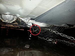

Just naming all the parts in that area.
Brake Rotor
Caliper
Brake Line
Spring Bucket
Camber Arm (item circled I believe)
Toe bolts
Swaybar and ENDLINKS
Axle Shaft
Shock
Wheel Bearing
Tire
Rim

Start with lower camber arm, wheel bearing, and a lifetime alignment. If you hear noises or alignment is shot, then look into anything else that would effect camber or toe.
Old Dec 22, 2012 | 04:16 PM
AARONHL's Avatar
Posts: 4,334
Likes: 121
From: ɷCONNECTICUTɷ
O also obviously, new tire? and the rim?
