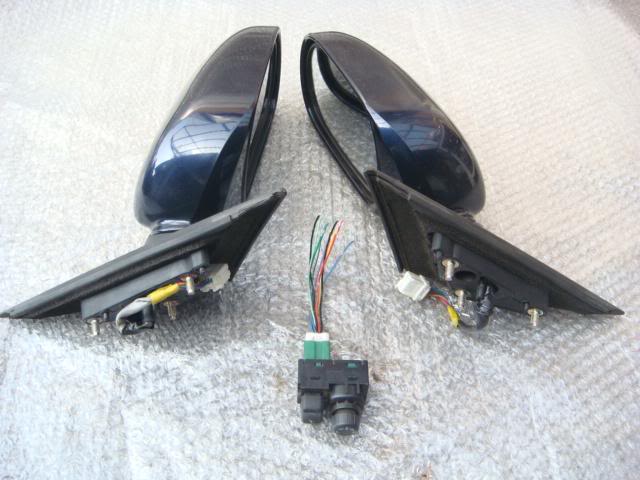

1. JDM motoroized folding Mirrors from a 1st generation V35
These are most commonly found on Ebay, but if you have a connection in Japan-land you are ahead of the game!
The mirror covers (cosmetic painted piece) CAN BE CHANGED to your stock ones, BUT it's more work, you'll learn about this more below. Just keep it in mind during purchase, you might need to paint the covers, buy the same color, or plan to take them apart to swap.

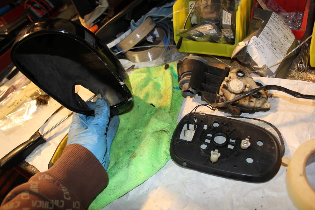

From now on, I'll refer to this piece only as the MIRROR COVER. For reference, I'm holding the MIRROR COVER in my left hand here:

2. V35 Power Folding mirror Switch with Harness
You can wire this in without the above switch and harness, but it's not simple, and won't look OEM.
