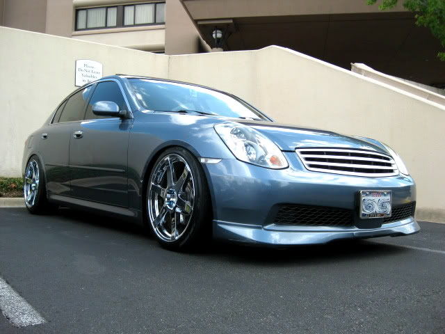

for reference, i'm running 19x9.5 ET29 (F) ET39 (R), 1.6" lower with no rubbing. I have some camber in the rear, not exactly sure how much though. brake clearance is more an effect of the style of the wheel as opposed to the width/offset,
