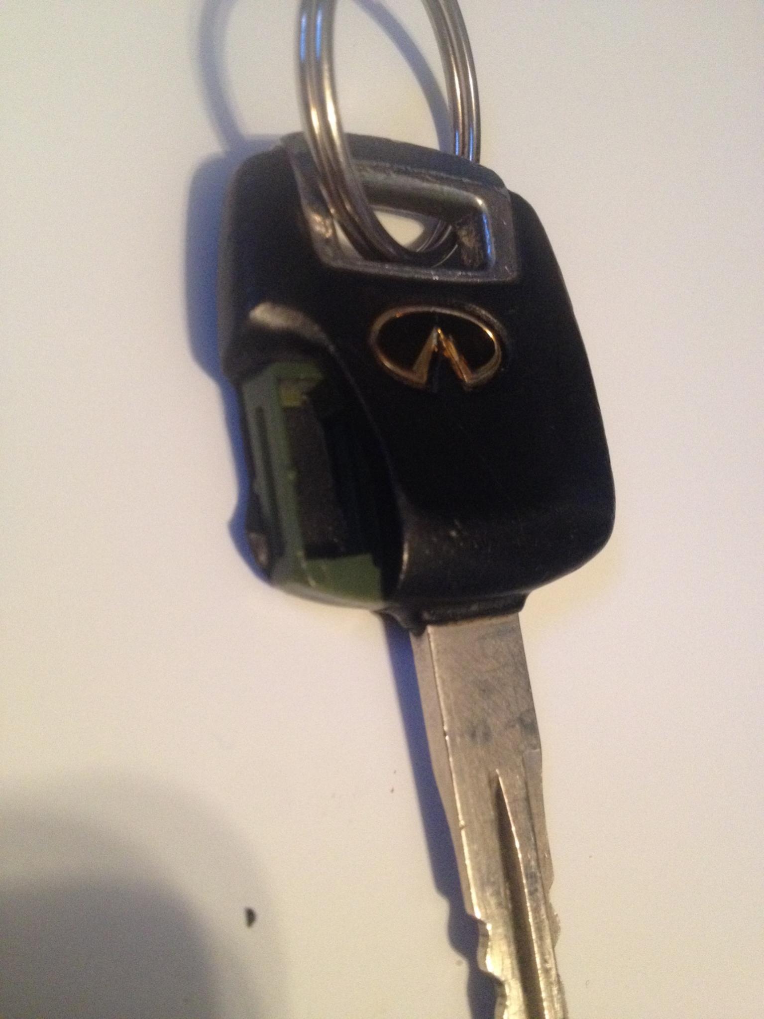

Been lurking the forum for a while and picked me up a G back in August.Great car so far but i am having a issues with the car not starting.it will turn over like normal but just wont start.
tried jump starting and no luck(didn't think it would do anything)
I think my problem is in my key.when i got it was the only one and it was cracked on 1 side with a little chip in it exposed,its now missing so i think that was the transponder in the key.
Anybody know if it was the transponder?

Attached Thumbnails No start/Does turn Over-img_3181.jpg

Yup if the little chip in the key is gone your car will not start.

Yup. You need a new key. And since you only have one, you need to go to the dealer or find a locksmith who can cut and program factory keys
