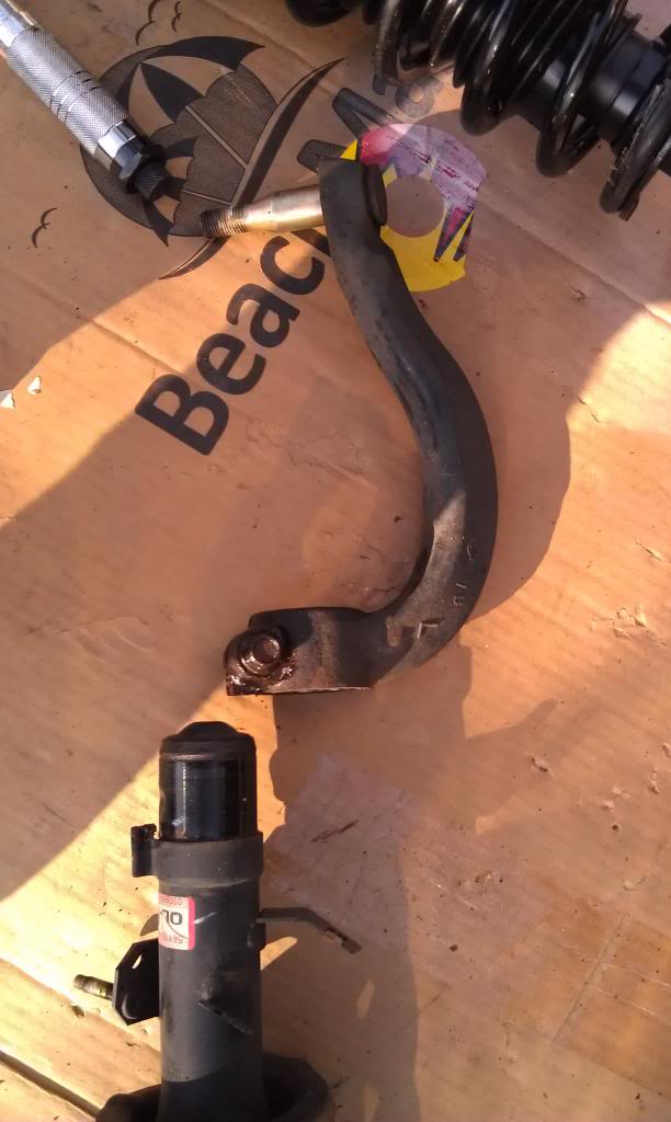

As mentioned, you really need to pull the strut with the bracket, and then try to remove the bolt outside the car. It's much easier! the strut sits about 2-3" into the bracket, as you can see from this pic here.
