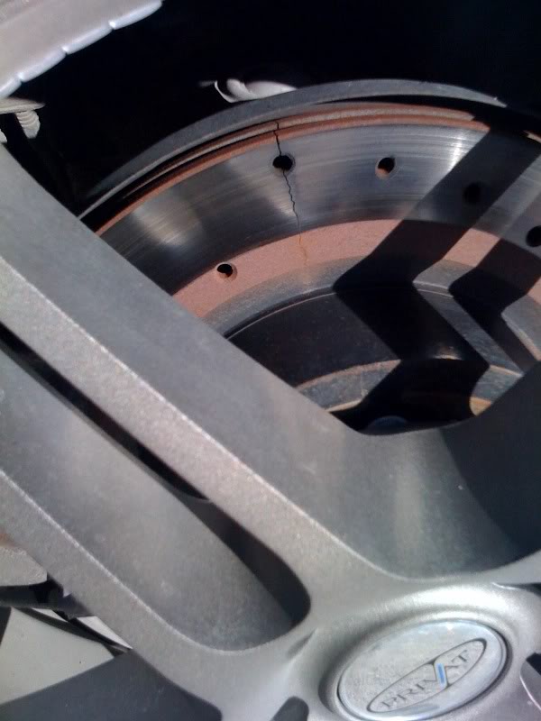

Never tried the Centric plain, but my Centric cross drilled rotors cracked.

How? From normal usage?

Yep

Hole are probably machined post casting, which causes stress which leads to cracks.
I personally recommend against X-drilled replacement rotors for that reason. Usually in most applications they are simply for looks and do nothing for performance gains. A $2.5K BBK with X-drilled rotors is NOT the same as slapping $50 rotors on your accord. Different engineering completely.

ALL rotors are machined "post casting".
