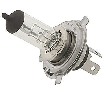

Just wondering if these are going to fit my 05 g35x and also are they blue? My one low beam just blew out so I'm just going to replace all of my headlight bulbs. I want high beams and low beam bulbs so I was just wondering if this has both in it?

2005 sedan uses a D2R HID bulb for low beam, and a H4 bulb for the high beam/fog lamp.
That H1 bulb is not correct

6K for bulbs typically means white with a slight hint of blue. But you wont want to use those bulbs as they will not fit.

Not only that they will NOT give you more light in that blue color.
D2R Zenon HID bulb:
How to tell a true Phillips HID from a fake.
H4 (Tungsten/Halogen) bulb:
