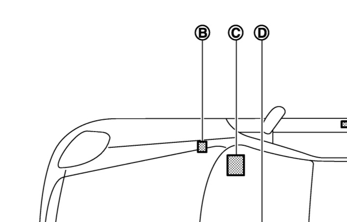

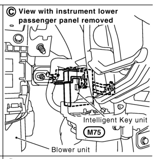

Here's where the i-key box is located. If you end up going the dealer route, ask why you couldn't keep your current fobs and program the new unit to receive them.
To answer your original question, I think this system is so integrated into your car's other systems that the only way to go would be OEM. You could go digging on ebay or salvage yards for the actual unit but you'd need to match your vehicle's part number exactly so that it all ties together.
