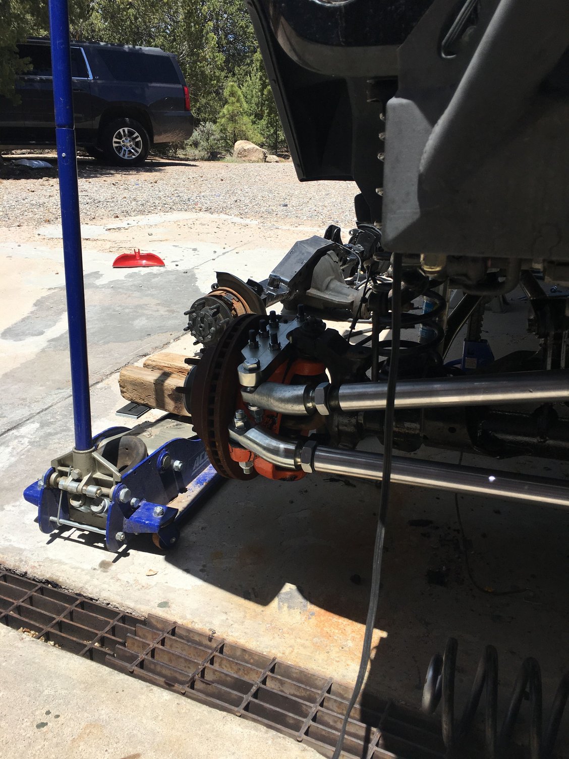

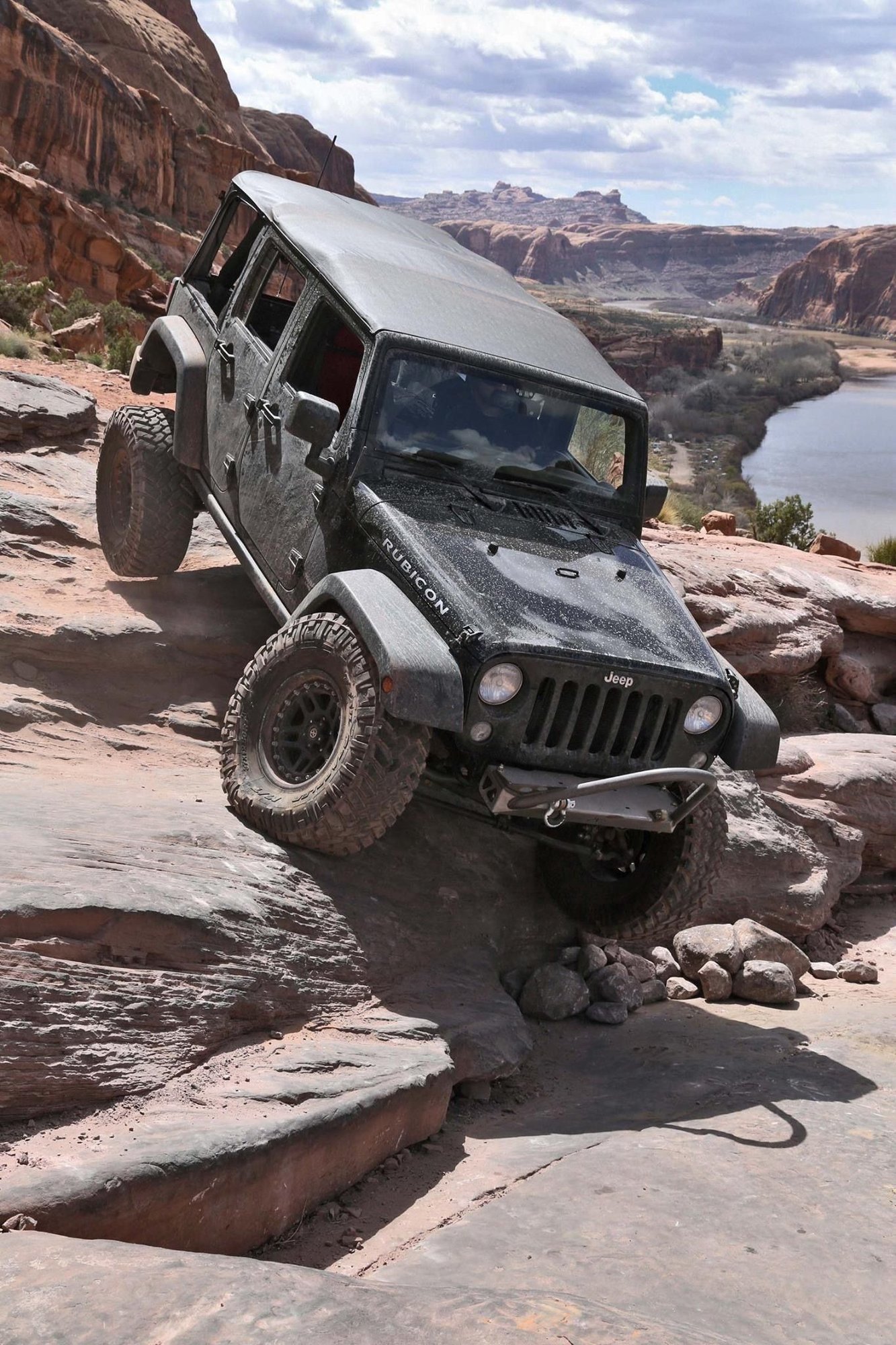

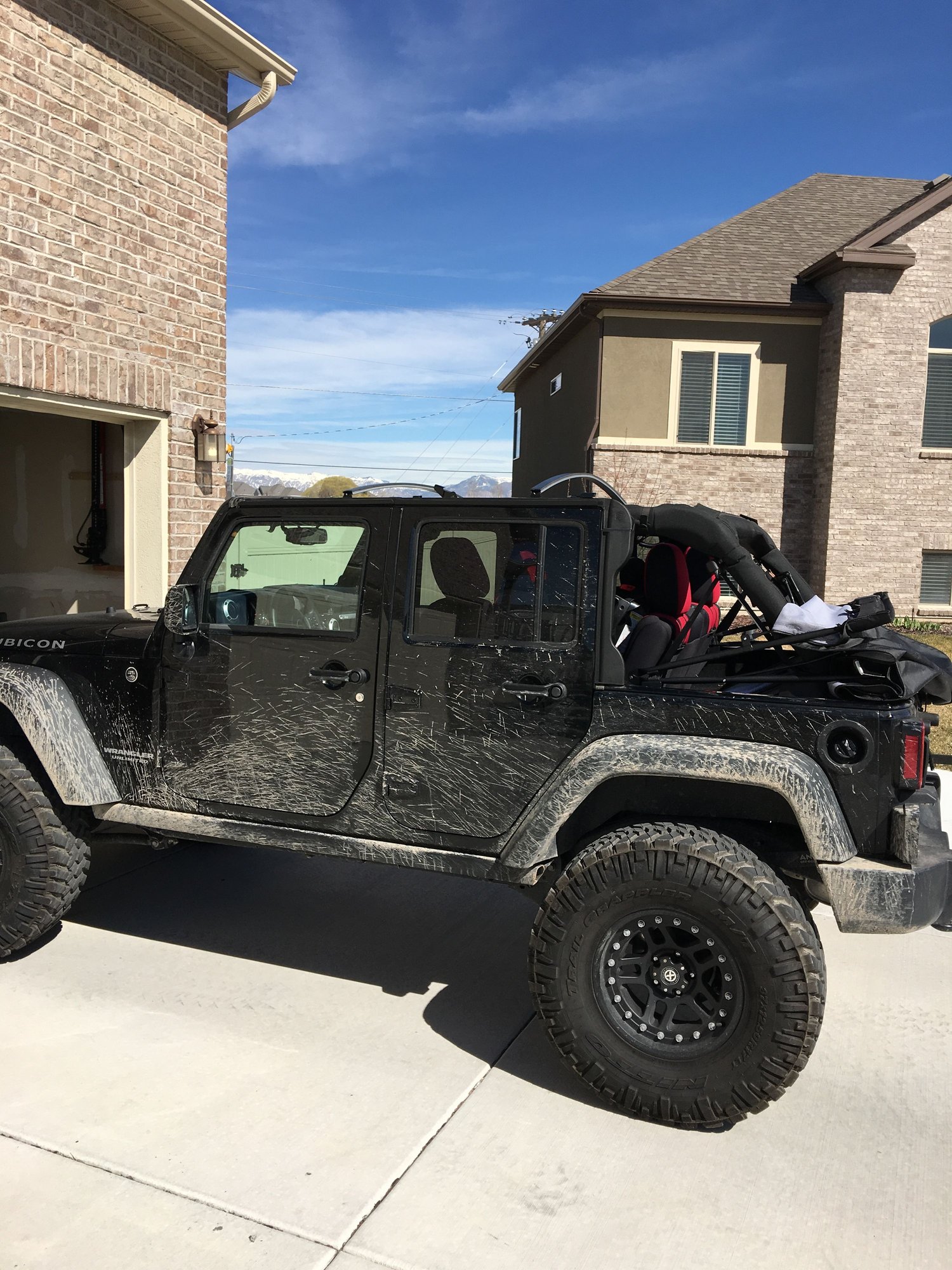

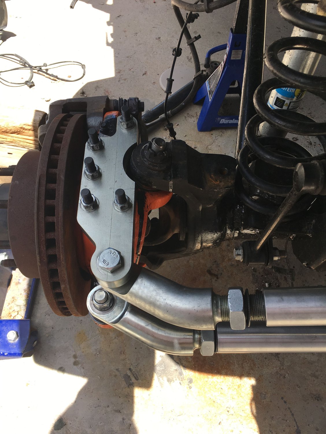

As requested:
(these are pre 40" muds and pre-Dana 60 axles)
