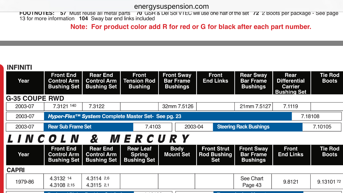

https://conceptzperformance.com/ener...v35_p_5966.php
Rear diff bushing.
Energy Suspension bushings with their supplied grease for the bushing swaps.
Replace the arms which have bad ***** joints, as most infiniti ones are non-serviceable.
I would call to confirm 03-06 sedan is the same as the 03-07 coupes for chassis.
You are going to need a really solid press to get these old bushings out.
It is 100% worth replacing the bushings though, revitalized my love for my G's performance!
Rear diff bushing.

What was the cost of bushing replacement?
I'm thinking of having a shop do them.
