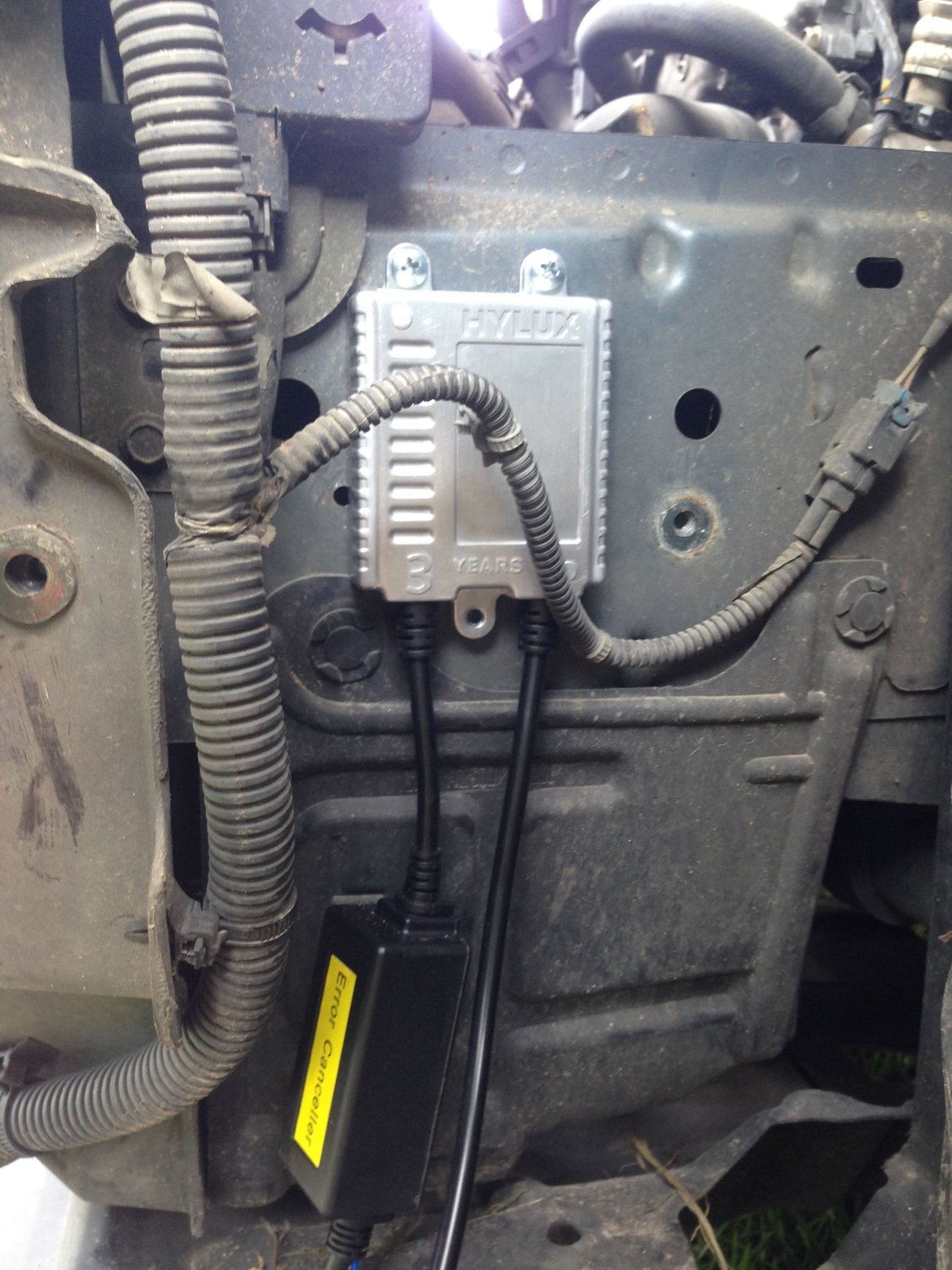

This is how I ended up installing my Hylux 35w ballasts.
I'm starting this with the bumper and headlights already removed. First I took off the air intake
This is behind the little air box that drops down off the intake.
Then I put the intake back on.
This is on the right hand side. I had to take the windshield wiper reservoir off to get in there.
Then put it all back together. I forgot to take pictures but I ran my cables for the new igniter through the lower light cap using grommets I had around the house. I had to convert the connector from the old ballast to a 9006 connector by splicing and soldering them back together.
It pretty easy after I started it but I was kind of nervous at first. Maybe this will help someone later.
Again thanks to Urbanengineer for the advice the Hylux ballast and morimoto 5500k bulbs were exactly what I was wanting for it.
